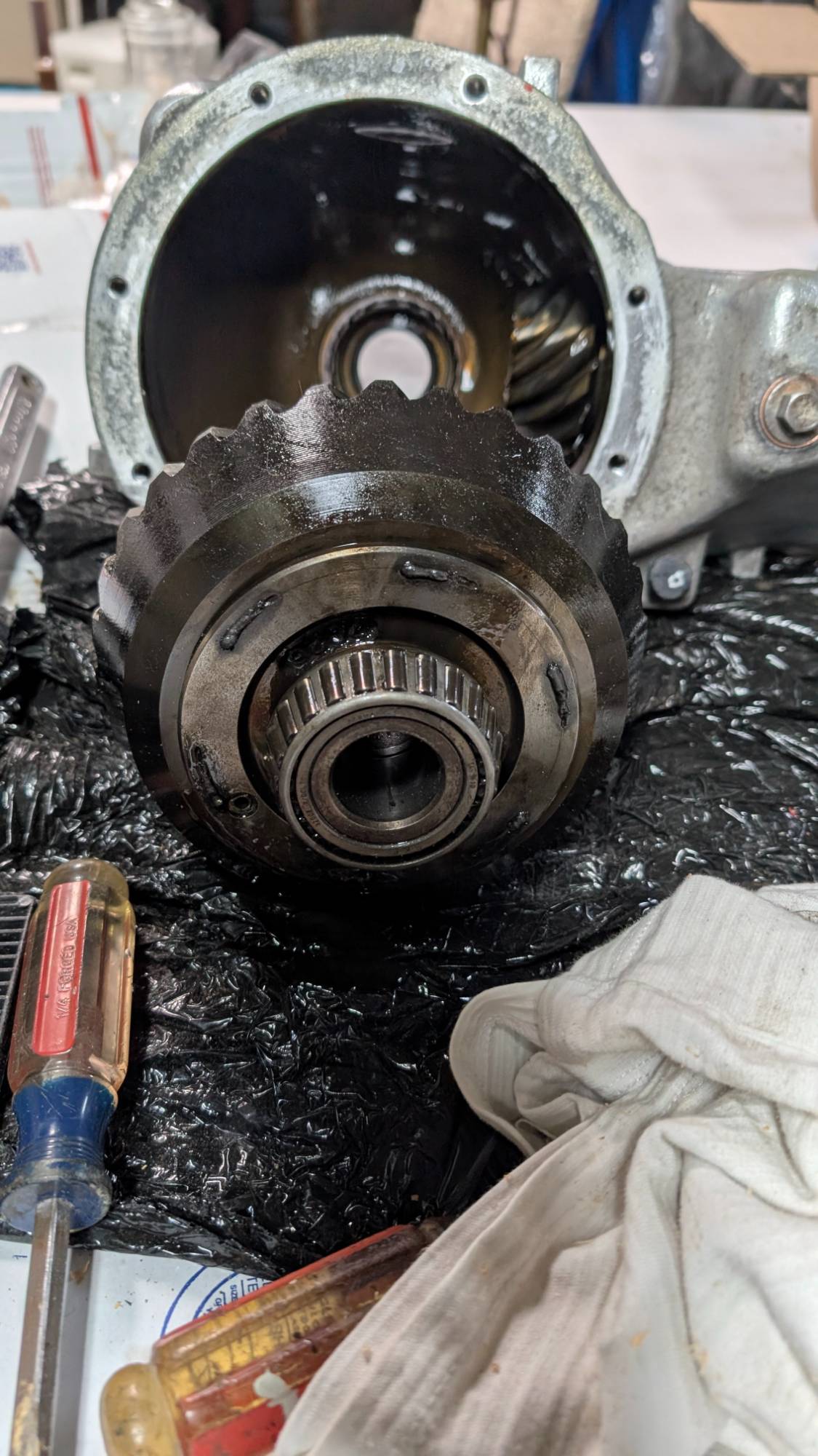

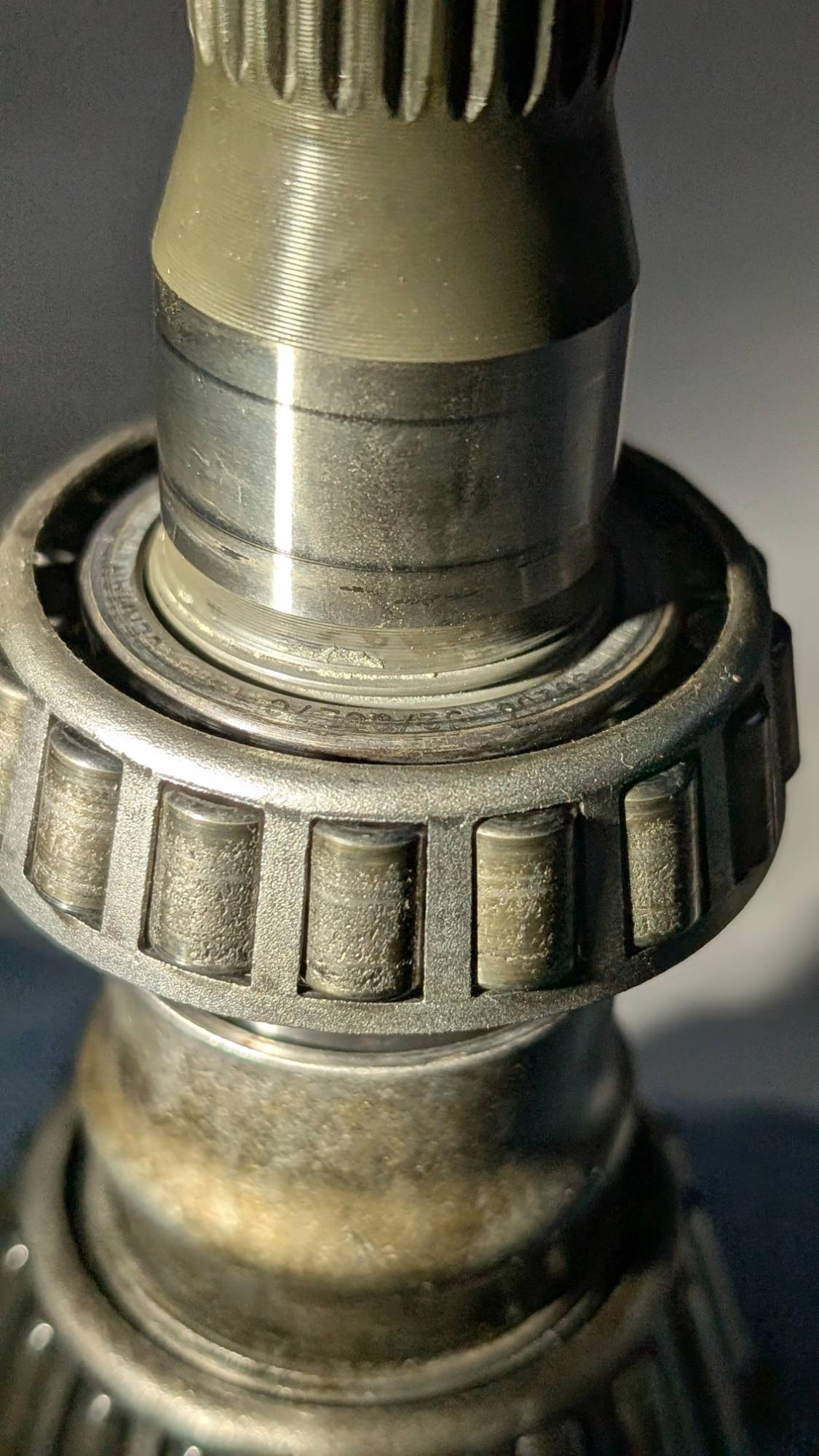

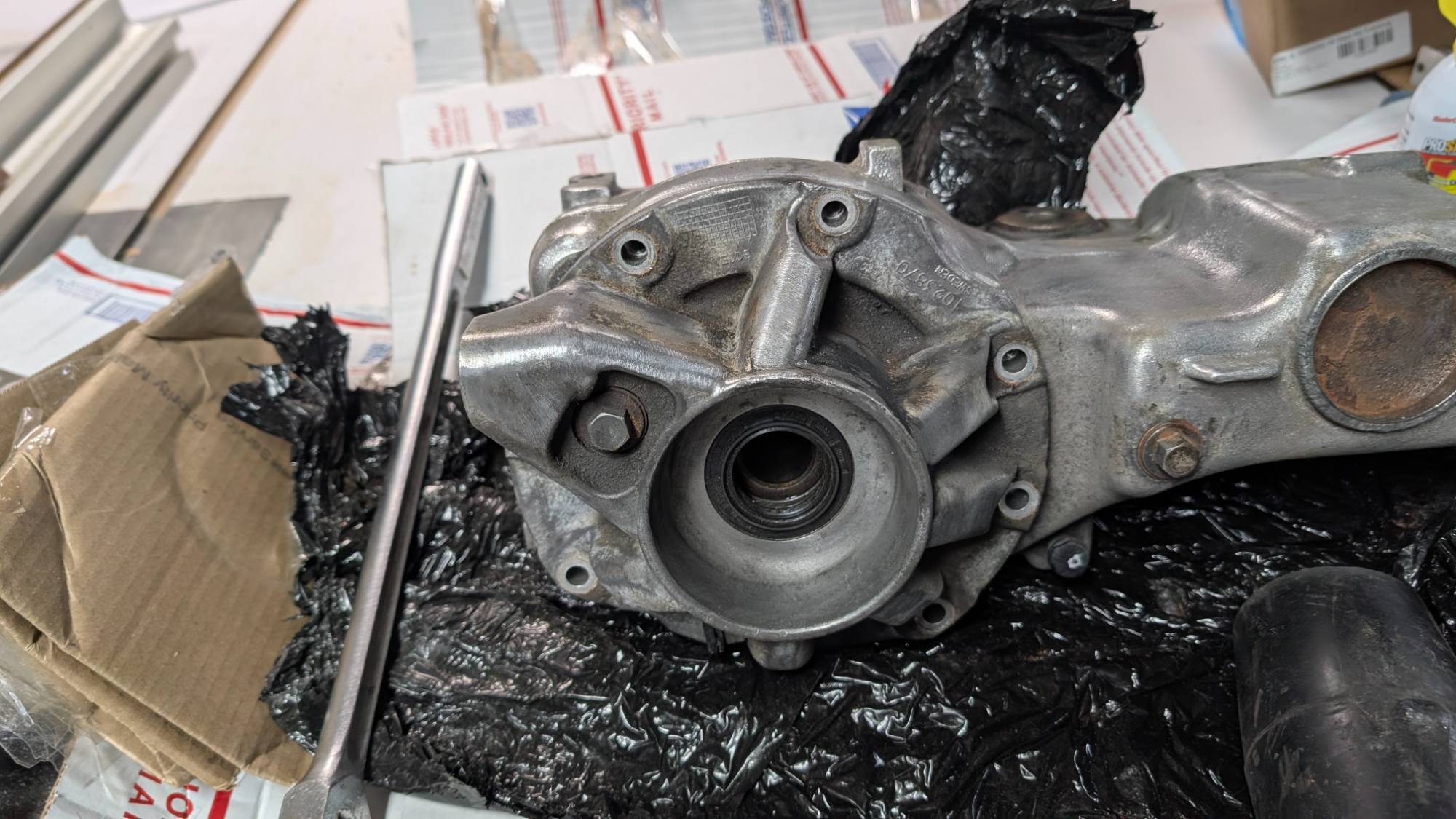

I would say any "used" unit you buy is going to have a failing Pinion Bearing. I bought a unit off eBay $558 CarPartsInc, Pittsburgh PA the the pinion bearing was failing. I am in the process of rebuilding the unit with new Bearings, Seals. Had to purchase the Pinion Nut Tool off Amazon at $157, it worked well. I am going to use a digital inch pound torque wrench to help me set the preload, by using the Pinion Nut splined portion, setting the torque wrench to 9.7 inch pound and then rotating the shaft, re-tightening nut as needed until resistance is achieved.

Oh, unhappy roller bearings!
Those must have run dry at some point
