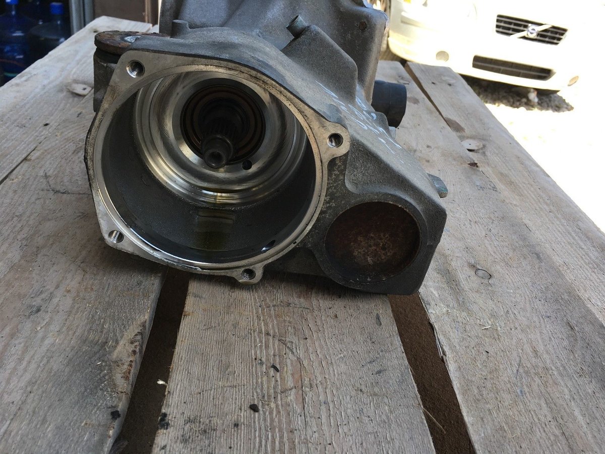

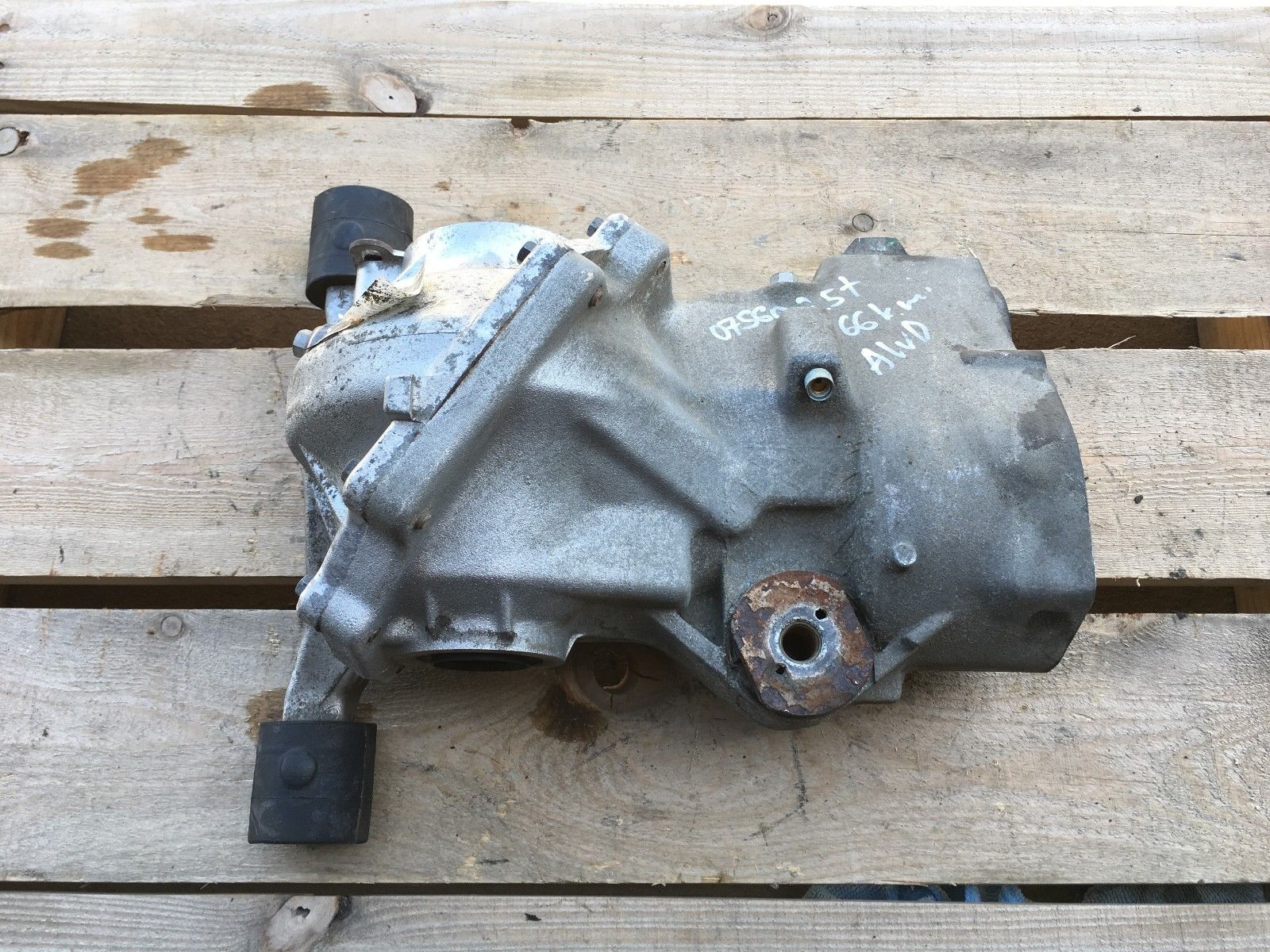

I did a lot more research and it seems that due to the parts, conditions of the parts I found and my timeline on getting everything at my location to perform the work, I ended up buying a partial differential for my car that has the correct gearing for my car in excellent condition. That will take care of the cracked mount but this unit has the haldex unit removed from it so I will have to swap mine into it.
Anyone know what part number gaskets, o-rings or seals I might need for swapping the haldex assembly? I cannot find much info on it and I'm not sure why this one seller separated the units but this one looks very clean and has 66k miles on it.
