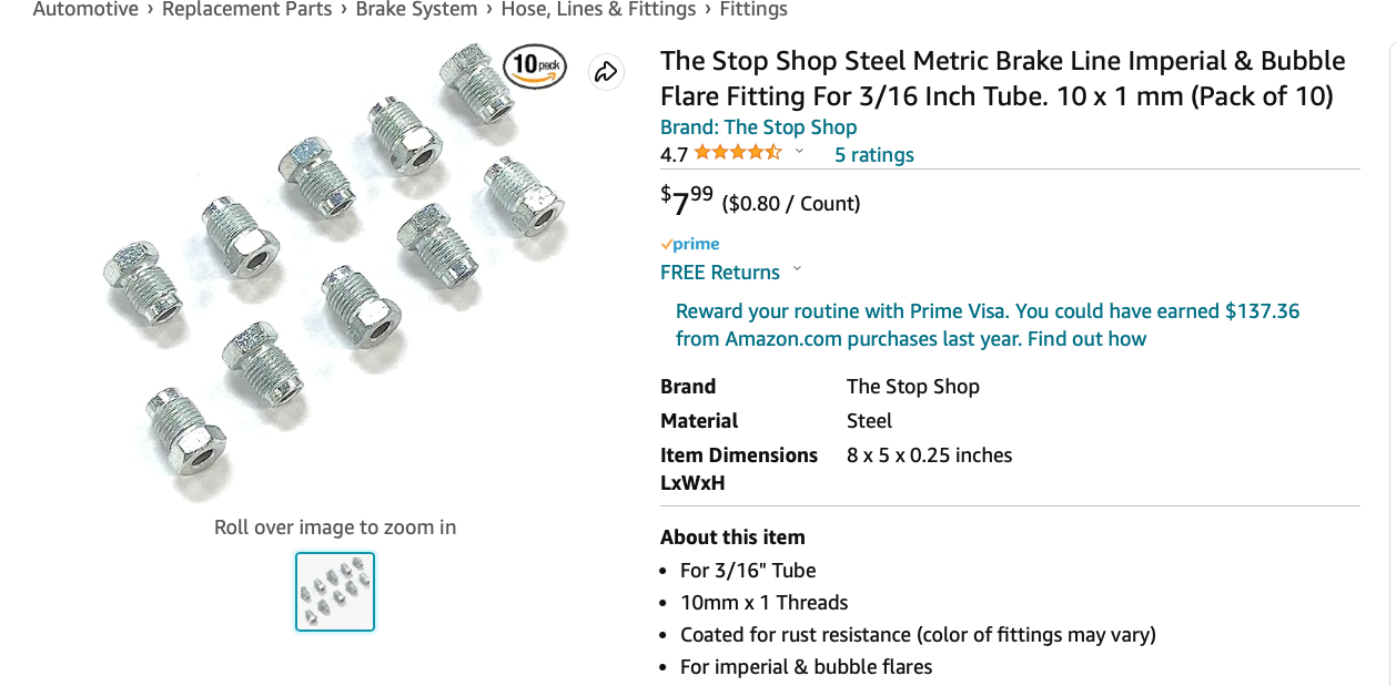

For some reason the Amazon links to the Stop Shop ISO / Metric / Bubble flare fittings aren't showing up. Is this what you were recommending?
" www.amazon.com/Stop-Shop-Metric-Imperia ... B09MJQKJQZ "

I updated the line fitting post with my recommended fittings from the SURR brand. They were in stock at my local Fisher / Sanel Auto Parts. I had one installed in a Centric caliper for over a year in normal conditions (moderate caliper body rust) after it was protected with Fluid Film and it removed easily.jreed wrote: 21 Jun 2023, 05:34 For some reason the Amazon links to the Stop Shop ISO / Metric / Bubble flare fittings aren't showing up. Is this what you were recommending?
