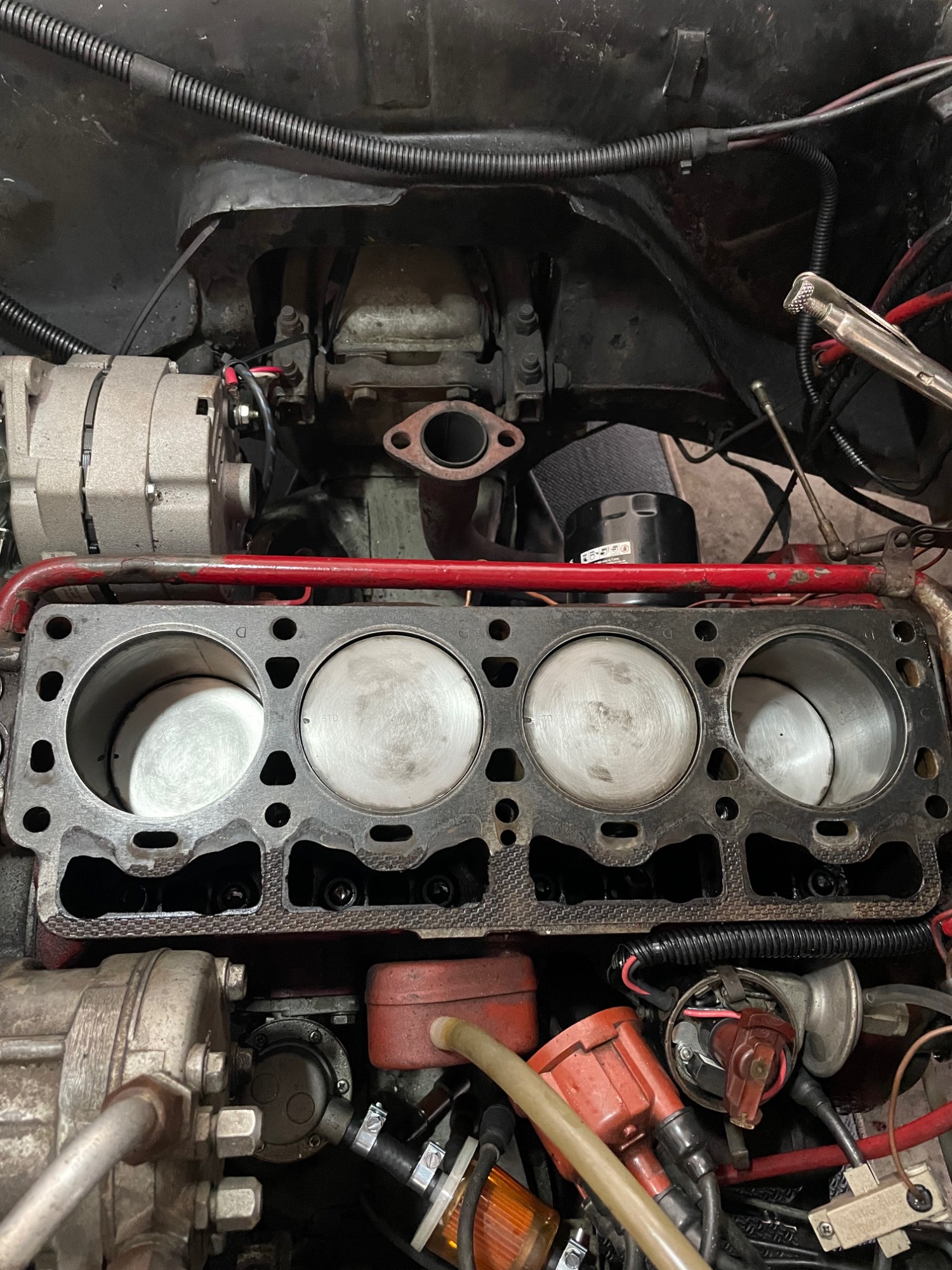

Okay everything looks good except the rod, which does have a little bend in it. I’m going to put a new set of rods in it and a set of valve stem seals and clean it all up good. The block is stamped with a D and the gasket is 1.6mm after being compressed. VP has a B20 A/B/D kit with a head gasket that is 2mm. Is that the head gasket I should order? Also, in the pictures, the gasket I pulled didn’t really fit the front water jacket holes very well, but I’m sure that is because of the difference between it being a bored out B18 block w/ a B20e head. The water holes fit the head water jacket holes fine. Should there have been an accommodation made by punching out the gasket a little to fit the block holes or is that the way it’s usually done? Thanks!

See what the new gasket looks like; trimming material on the gasket around water passages won't do any harm. Looks like Leo did a decent job on the build. He likely bored the block himself.

The gasket fit around those 2 water holes was like that 45+ years ago when I helped re-build my first B18 engine. It was a B18D engine which was a lower compression block and the B was the high compression twin carb block. Both good engines.
I did exactly what you have done and filed the water jacket holes out to more like the shape of the jacket in the block.

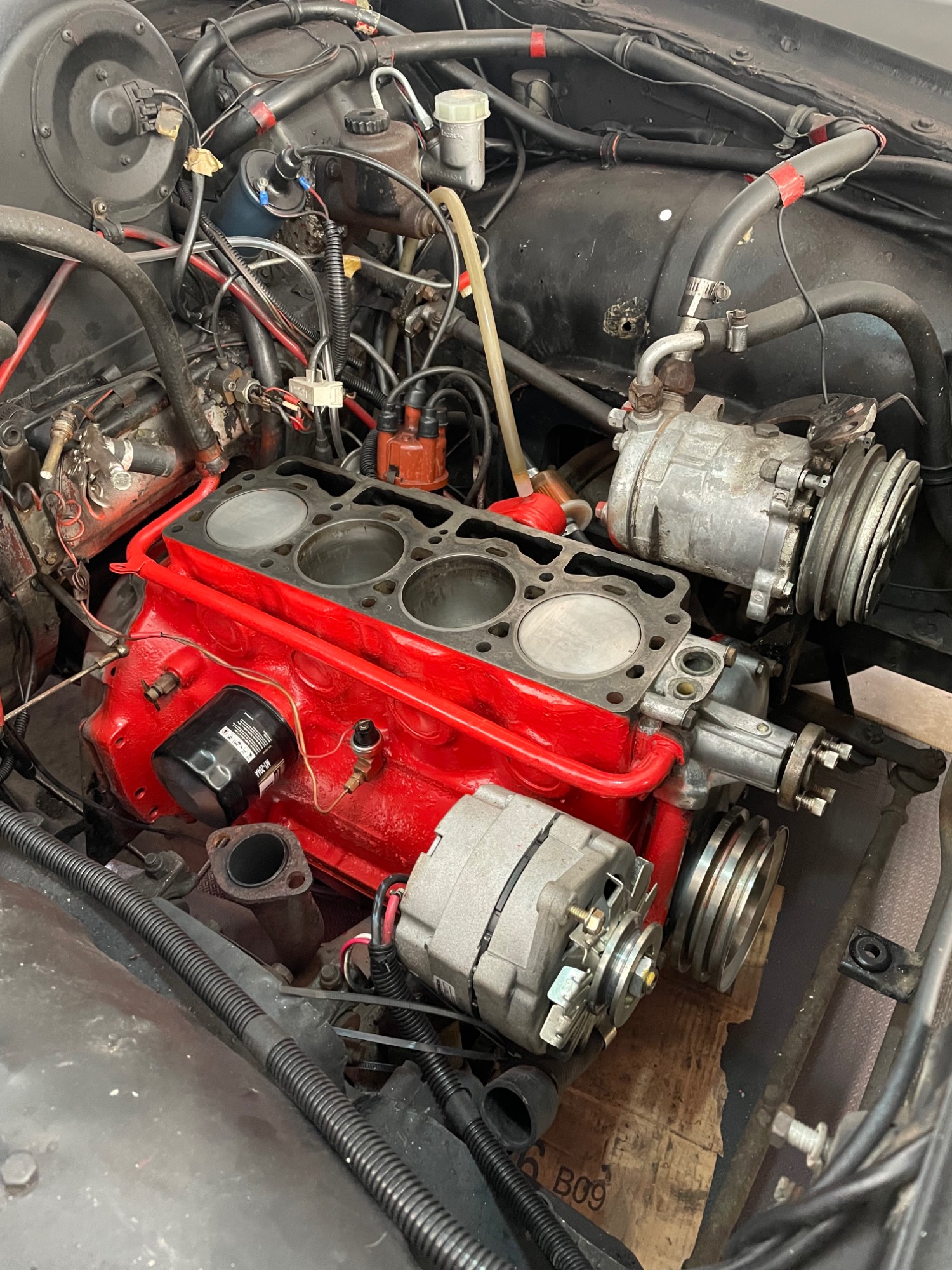

I received my parts and gaskets yesterday. I lapped the valves last night and installed them w/ new valve stem seals tonight. I cut the heads off of two of the old head bolts to use as guide pins for when I put it back together on Saturday. I installed new float needles and re-baselined the carbs. I’m starting all over with the adjustments once I get everything back together and running this weekend.

Wow, you have been busy!! Love that you have re-painted the engine as it should be. Very nice.

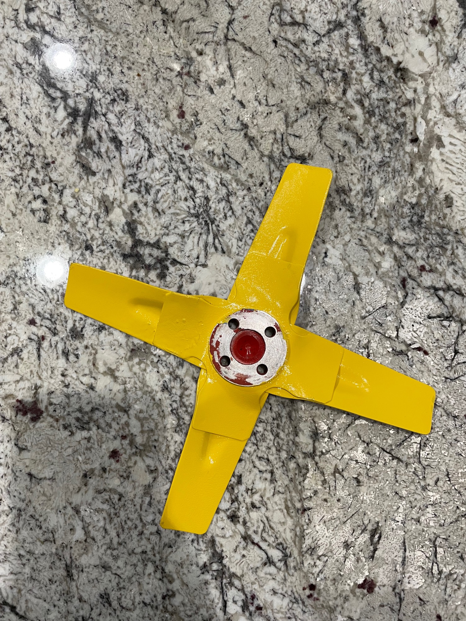

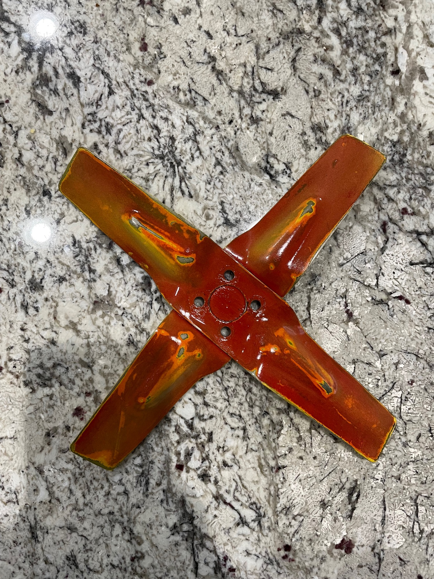

I had some fun with the fan blade. It was red and I painted it red, but I decided to paint it yellow as that’s what they were originally. Mind you, none of my colors are “Volvo red” and etc.. So, I sanded the front down to repaint and thought “that looks interesting”. I flipped it over and sanded the back and painted it yellow. I flipped it over to the front and thought that I should just clear coat that, and I did.scot850 wrote: 06 Jul 2023, 23:05 Wow, you have been busy!! Love that you have re-painted the engine as it should be. Very nice.
