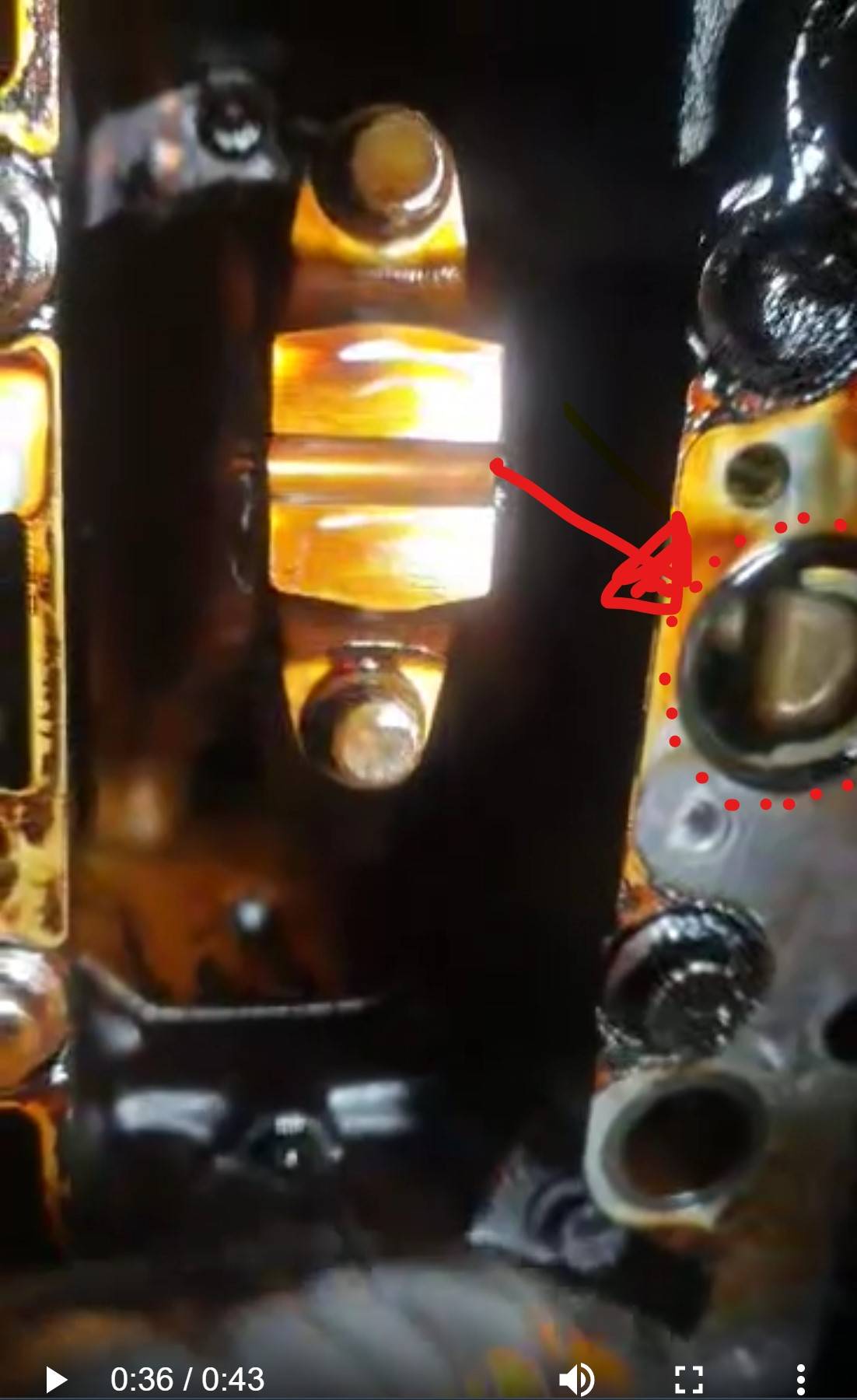

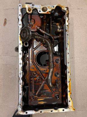

This evenings findings:
1. We changed the gearbox 1,5 years ago and now when the pan is off the car I could easy feel the bolts between the flywheel and torque converter. They where all loose :roll: and now I'm hoping this could have been the rattle from my engine.
2. The rod bearings have all play side to side and feels really smooth, no play at all up and down. This must be a good thing ?
Did also check for play in the crankshaft side to side, but there is no visual play at all.
The pan will enjoy a soaking bath in machine cleaning detergent.

That's good news, I expect thats the cause of your horrible engine sound. I had a Corvair years ago that had a very small crack in the flywheel and it made the engine sound like it was coming apart, similar to yours. How long did it take you to get the oil pan off?

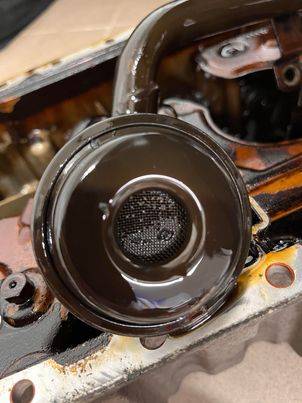

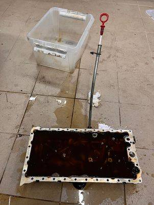

Eek that pan is filthy! Good clean of that and the pick up, new sealant and good to go.
Your gut was pointing to the torque converter all along, so good diagnosis.
