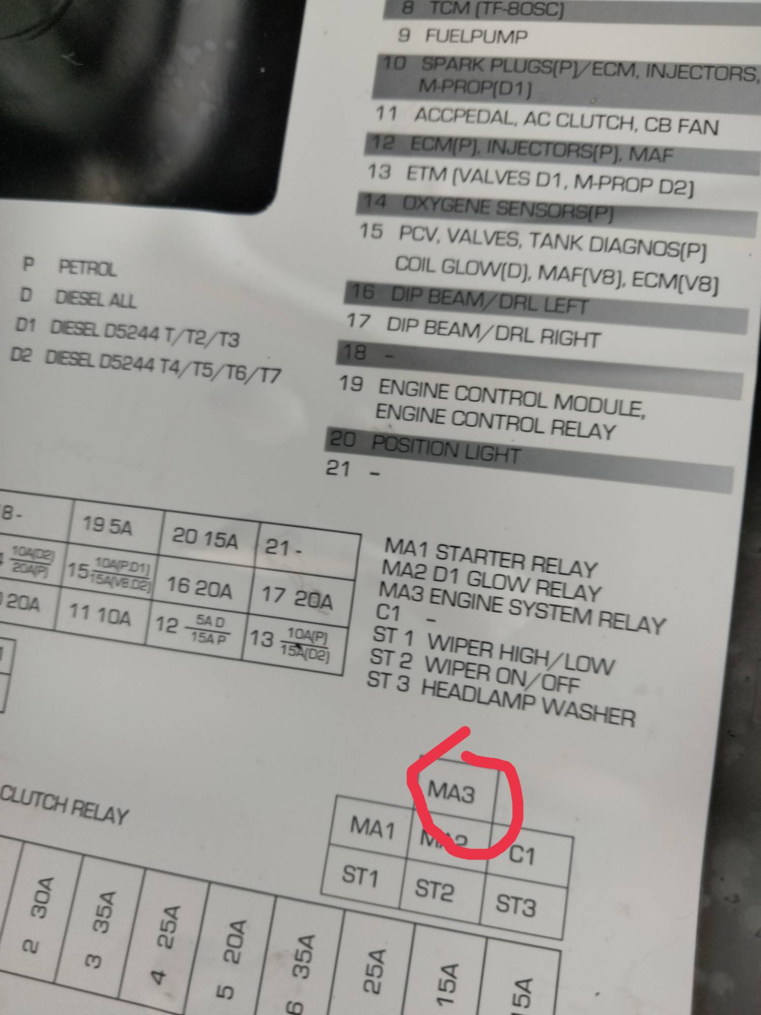

I just got home and started looking at the Volvo again. I try to start it it turned over for a couple seconds then stops. I did this repeatedly until it didn't even turn over. I have jumper cables on it and still will not start, nor turn over.. I did notice a buzzing sound under the hood and traced it to a relay, Engine System Relay MA3. MA1 is the same part, so I swapped them, and relay I put into MA3 spot continue to buzz. Hence the relay is not defective. I will have to find out where the inputs to is relay come from.
