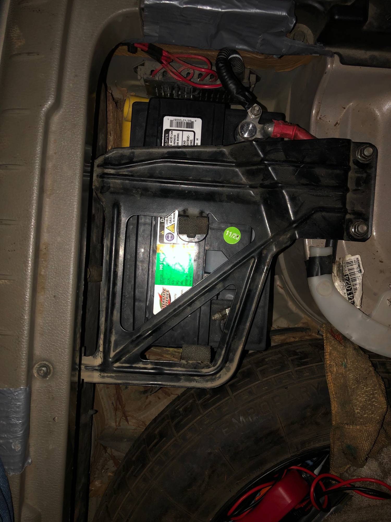

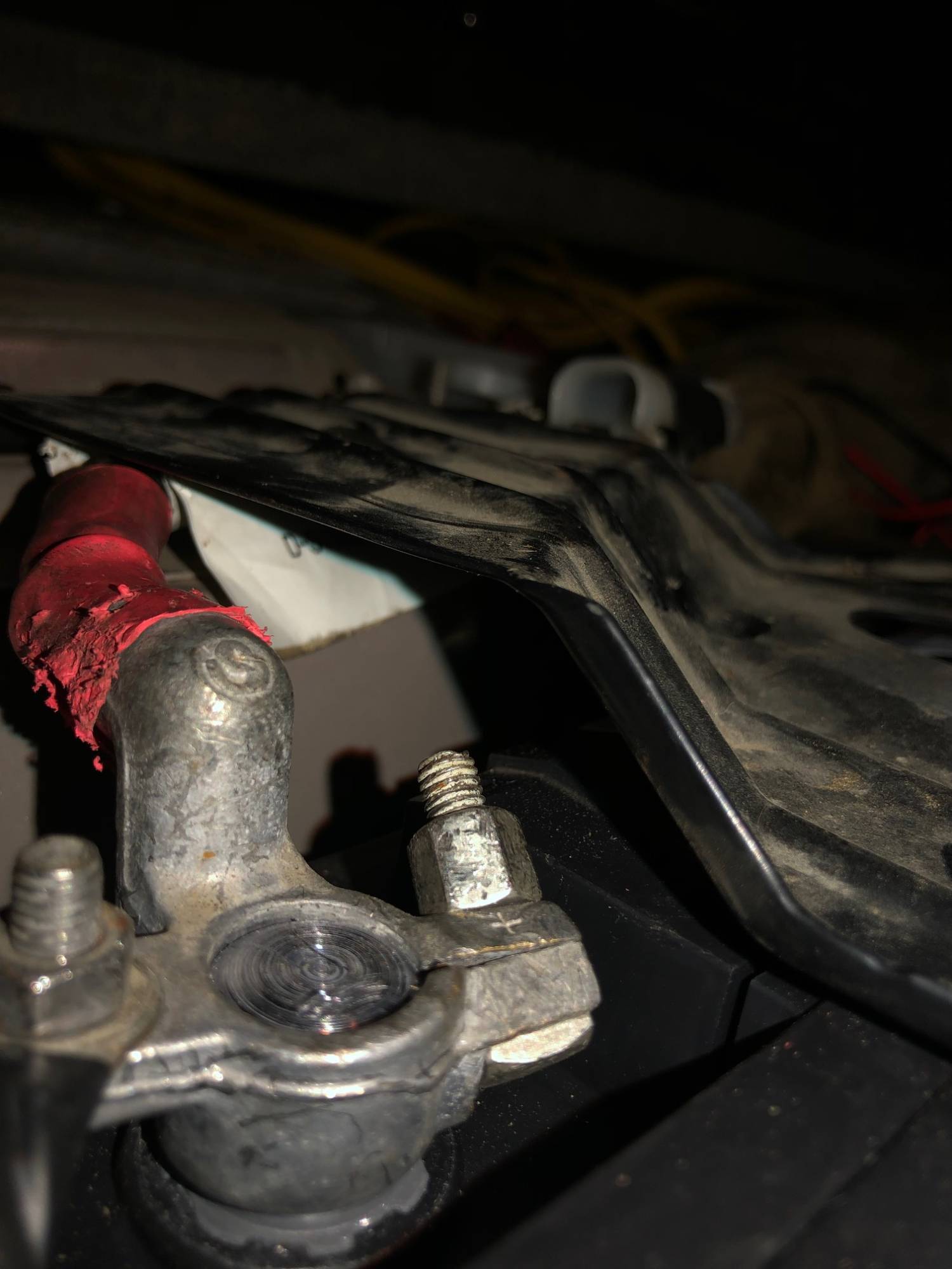

I got an interstate one from costco for $130. Starts much better now. The battery that was installed previously was not meant for this car and was a little too tall, therefore that metal cover thing was not installed.
I installed the metal cover, and it seems a little close to the terminals, and if the battery was jostled around, it may be able to short
Is this normal, or should I take it off? I assume I need it to keep the battery from bouncing around and to have power for the airbags if the car rolls.

Just make sure the battery clamp is nice and firm. A battery that rattles around is bad and will have a short life from cell damage. I dabbed a plastic cover from a juice container to neatly protect that positive terminal

abscate wrote: 05 Dec 2023, 03:44 Just make sure the battery clamp is nice and firm. A battery that rattles around is bad and will have a short life from cell damage. I dabbed a plastic cover from a juice container to neatly protect that positive terminal
So is there a risk of shorting the battery with the cover installed? I checked it with a multimeter and it seemed that the metal hold down was not conductive, but I assume it may be if the battery jostled and scratched it.

02V70 wrote: 05 Dec 2023, 20:55
something doesn't like right there.
i'd go out and look at mine but its 2 am and down to 3F.
it can wait for the sun to rise....hang on.

02V70 wrote: 05 Dec 2023, 20:55 So is there a risk of shorting the battery with the cover installed? I checked it with a multimeter and it seemed that the metal hold down was not conductive, but I assume it may be if the battery jostled and scratched it.
yes, the cover is very conductive, you are missing the plastic battery cover.
You can make temporary insulation with empty milk jug or similar plastic.
Get one from a junkyard or buy this one.
