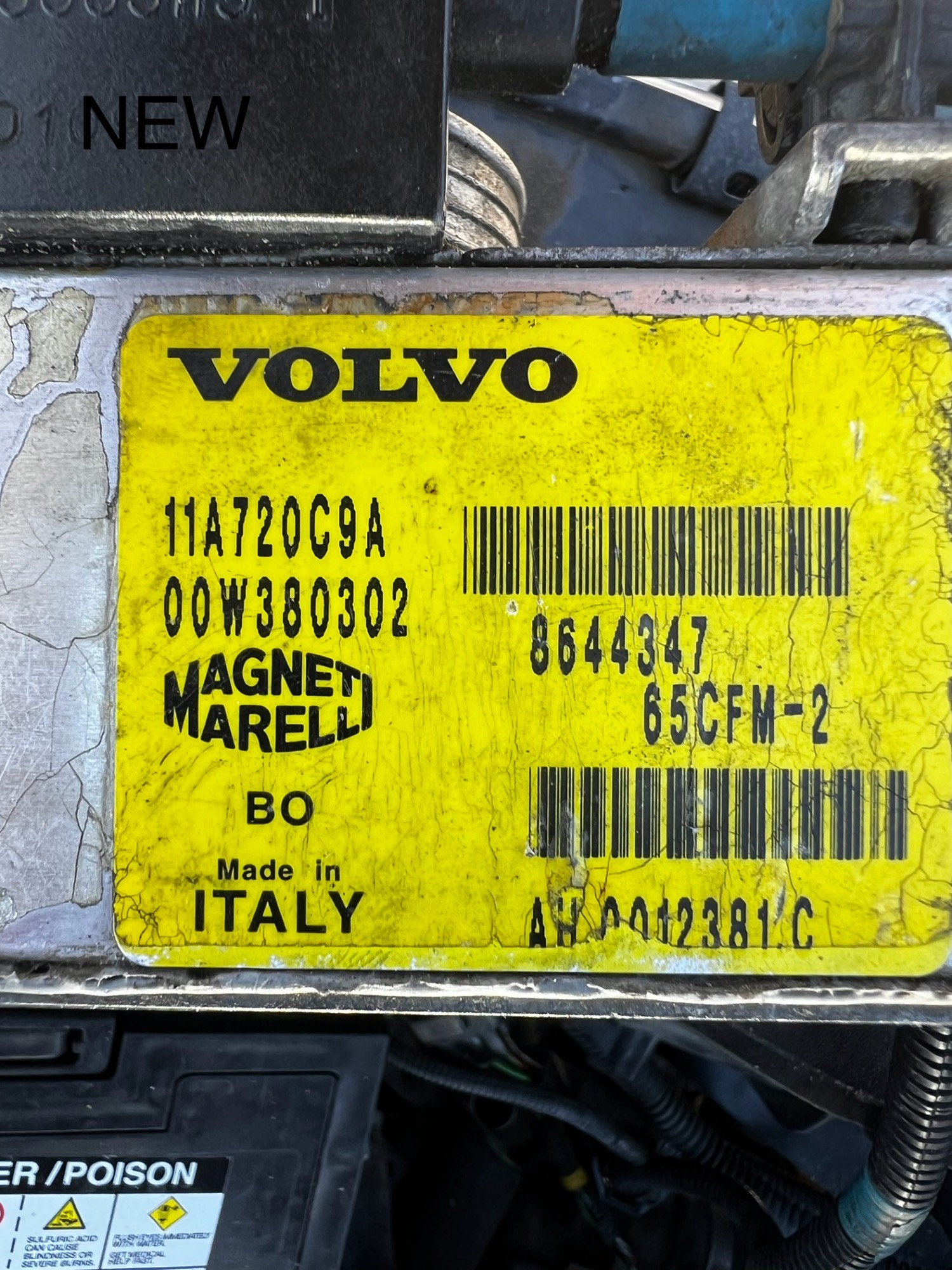

So the car runs with the ETM reading 0%? Does your current ETM have a yellow or white label?

Yes the car runs great for a couple of miles, then, when the TP goes to 0, very poorly and won’t accelerate beyond 2500-3000 rpm even in Park.jmartin919 wrote: 16 Jun 2024, 09:07 So the car runs with the ETM reading 0%? Does your current ETM have a yellow or white label?
The ETM has a yellow label.

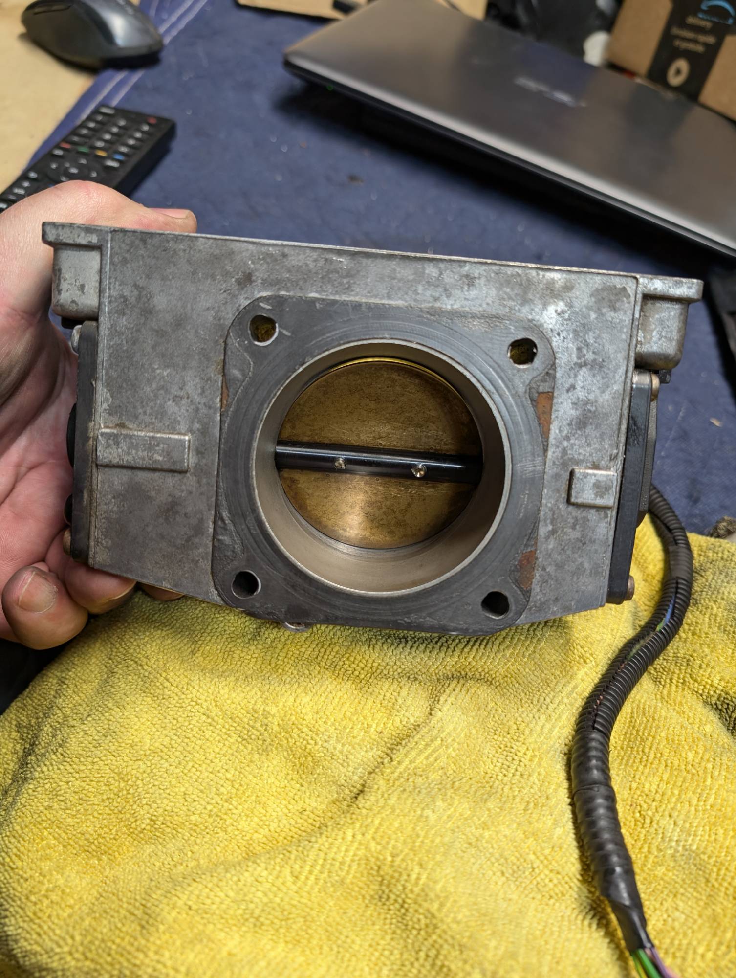

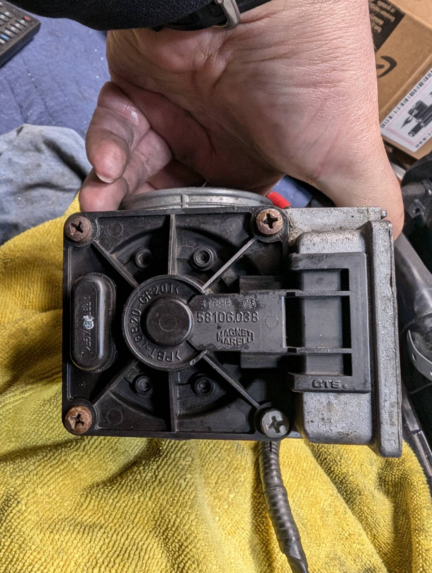

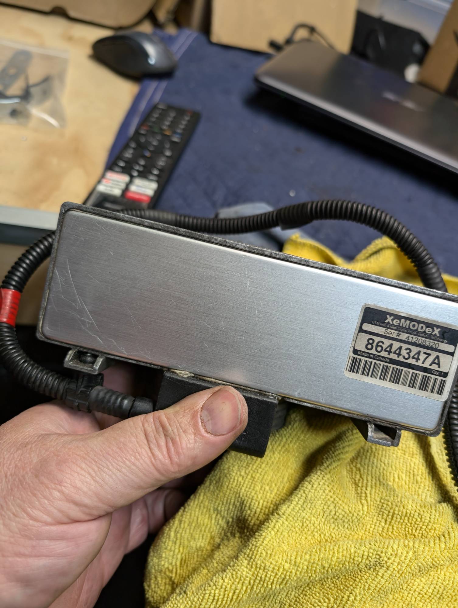

So I cleaned the Xemodex LPT ETM I pulled from a 1999 V70 XC a couple of days ago. I am now wondering about this. I had a look on Xemodex's website and it was not of much help other than the label they use is completely different to the one on this unit making me wonder how old it actually is. The other think is I thought they swapped the position sensors on both ends of the unit, but this one only seems to have it on one end and the other end has a Magneti Marelli one on the other end??
I am going to try to contact Xemodex tomorrow to find out how old this repair is and why the different sensors. The other think is had been painted with a silver paint (the castings tend to go blotchy with age) but a lot of it has gone crumbly which makes me think this has a fair age to it. In fact, just remembered my car has a Xemodex unit on it so I can check for similarities as it was fitted before I bought it in 2012.

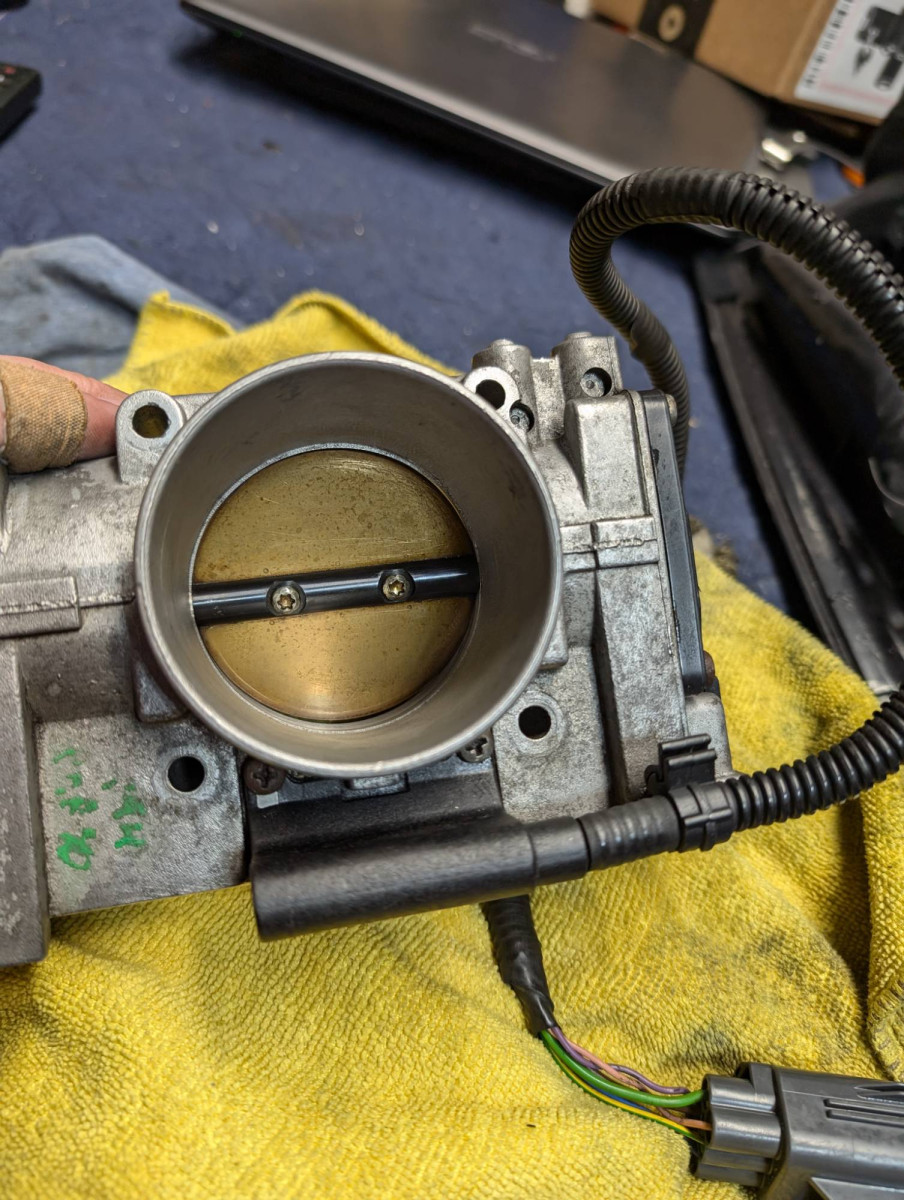

Meanwhile, I removed the ETM, reconnected the connector and watched the data stream as I physically moved the throttle plate. After a few seconds of this, it froze at 97%. Just like when it’s installed on the car - which should rule out the accelerator module. So now I’m thinking I got a second bad ETM, or it’s an ECU, wiring or software issue.

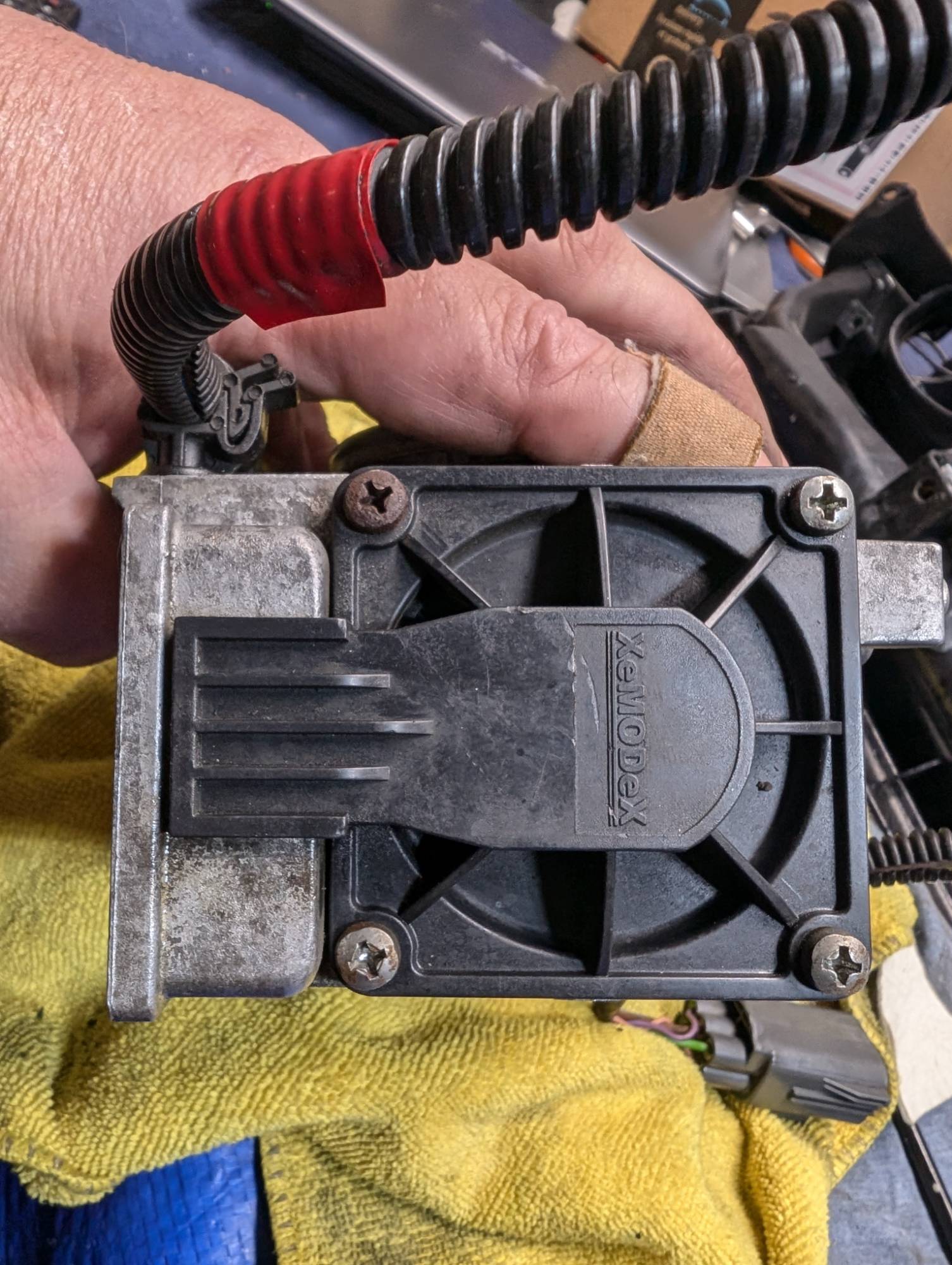

I spoke to Xemodex, but they were unable to check. They have no record of that unit so they think it may have been sold through a 3rd party supplier.
I did go look at the one on my own car and it is hard to see other than the label. The label layout is the same, but the part number is different in the last digit where this one is an A and mine ends in AO. Possibly the LPT v's HPT difference. I have asked if the serial number is sequential for all units they sell/repair. If they are then this one is even older than the one on my car.
This one is: 41208320
The one on mine is: 211091042
Xemodex way back sold through FCP and others, then they only dealt direct for a while.
Mine has the same split of the 2 sensors. I have not had any issues so far with it, but then my car has also not done much mileage either.
