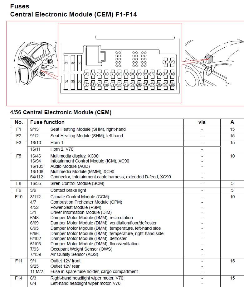

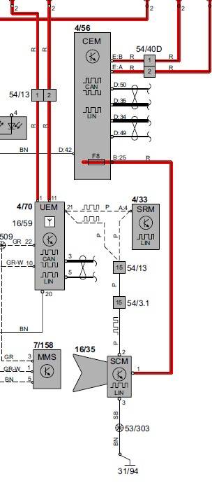

See this wiring diagram for additional detail, you might have luck by pulling CEM fuse #8, maybe try that before removing the siren module connector. Fuse is located under the dash left side:

Thank you for responding! I pulled the #8 fuse and it didn't make a difference, the siren module still hasn't arrived but once it does I'll post back on whether or not it fixed any of my issues.
