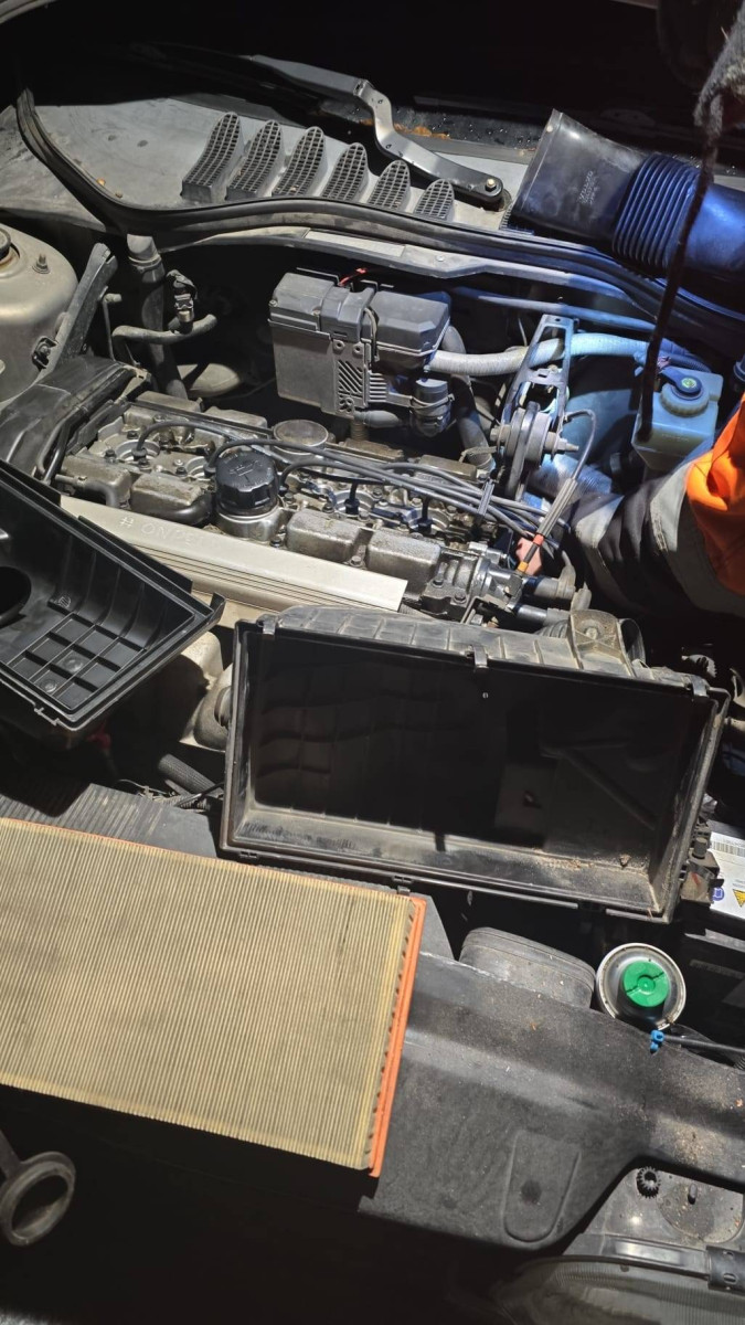

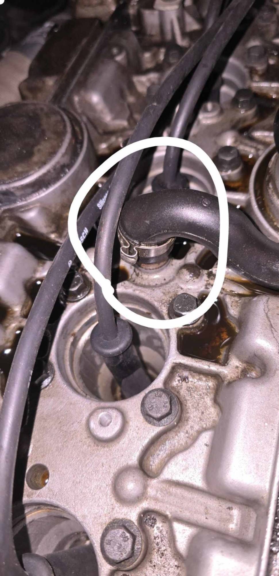

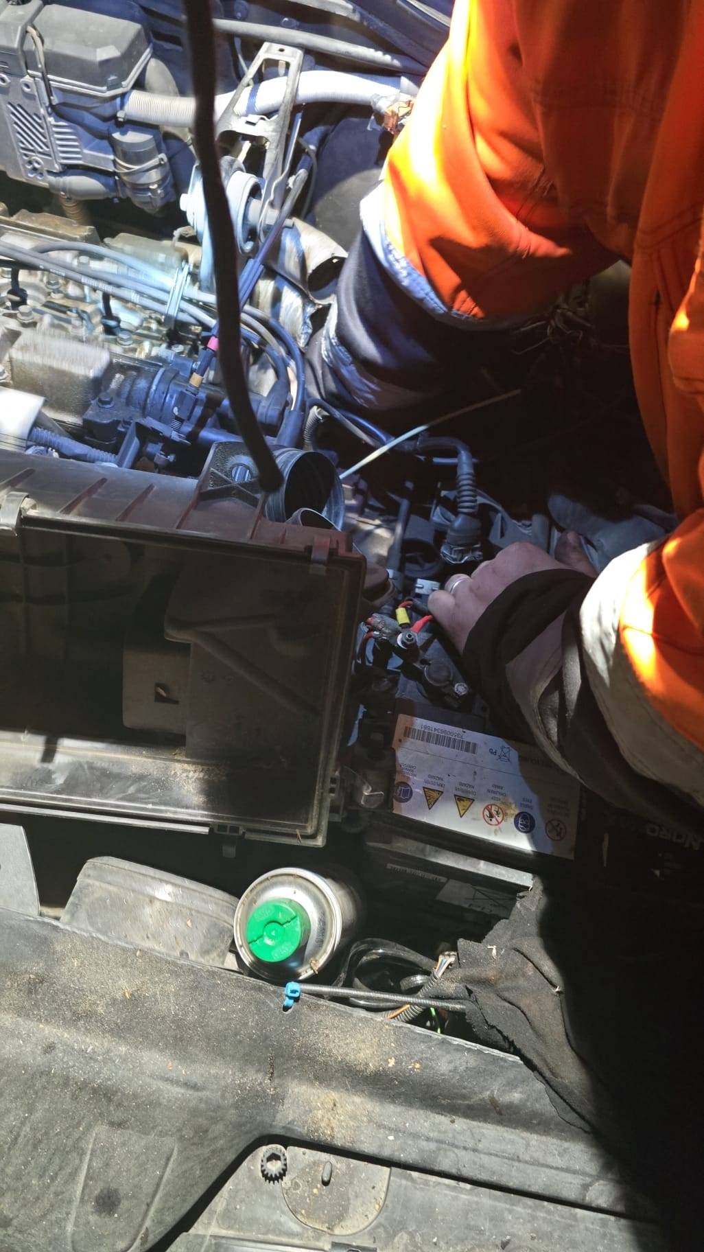

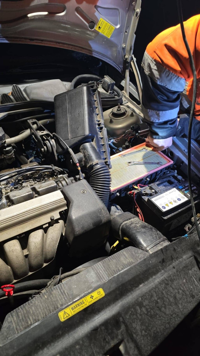

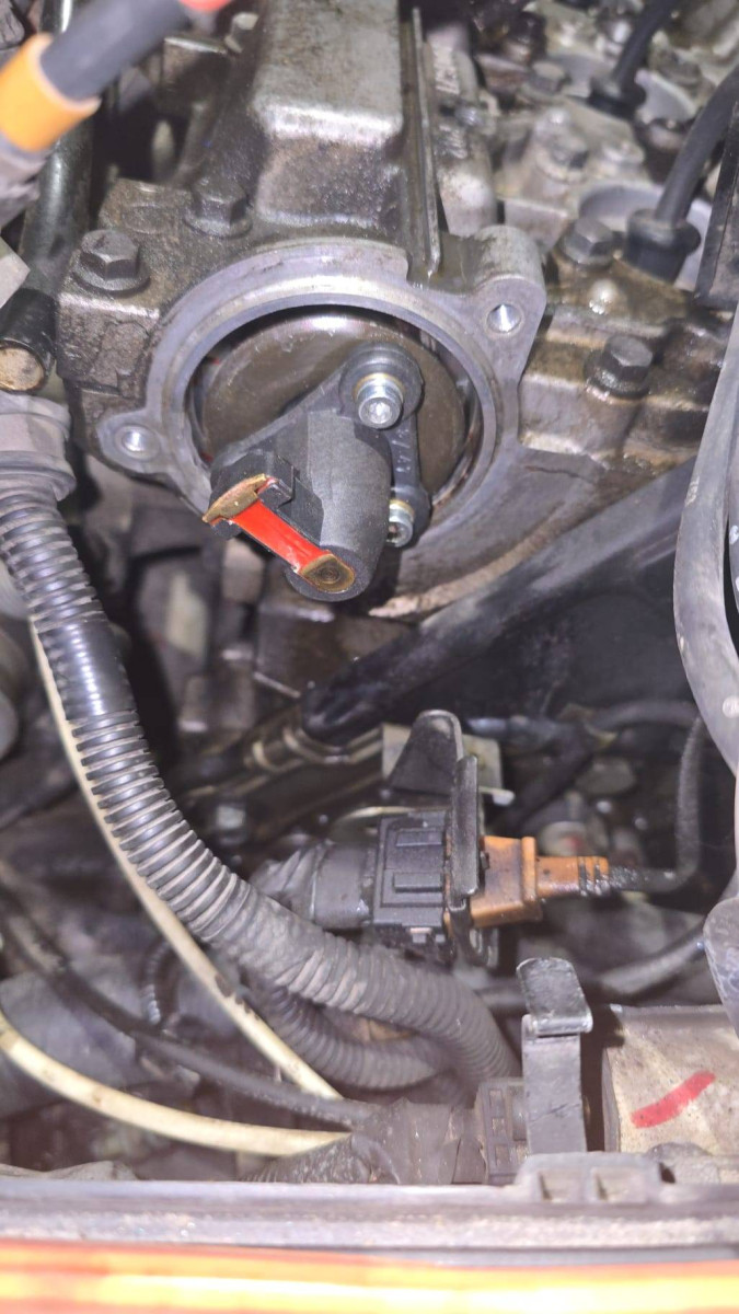

Here’s what I’ve done so far:
- Ignition Coil: Measured at 7.3k ohms, while it should ideally be 8–9k ohms. I replaced the coil with a new one since it had never been changed. The battery was also charged. Starting improved, but the main problem persisted.
- MAF Sensor: Cleaned with spray, and I also used EGR cleaner to spray into what I believe is the EGR valve.
- Idle Air Control Valve (IACV): I couldn’t clean the valve itself because it’s closed and I can’t see inside, but the tubes connected to it were clean.
- PCV System: Confirmed clogged. This will be replaced soon.

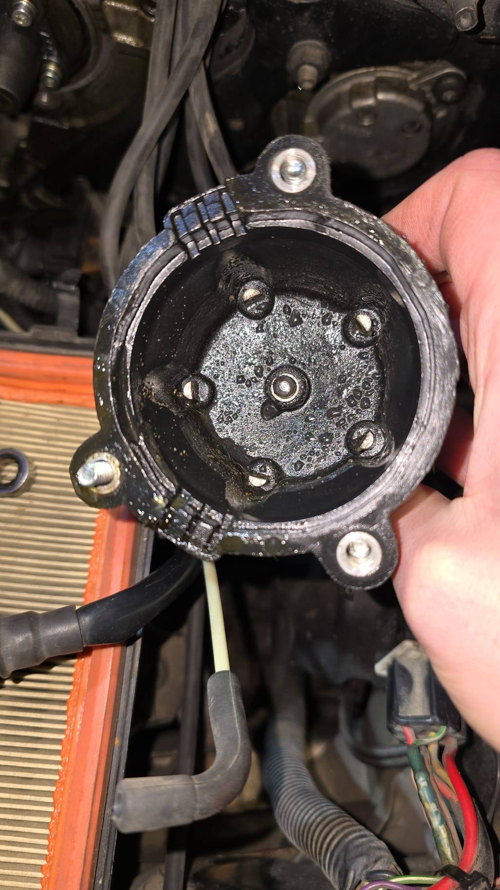

- Rotor Cap: Cleaned the inside of the rotor cap, which was moist and oily (pictures attached).
- Camshaft Seal: Seems to be the source of the oil leak. This will be replaced after the PCV system is fixed.
- Spark Plugs: The spark plugs were slightly discolored and haven’t been changed in about five years, according to the records.
Current Status:
After cleaning the rotor cap, spraying the MAF, and doing general maintenance, the car started better—stable and without any obvious issues. I’m not sure if it’s a coincidence or if the cleaning helped resolve something temporarily, but it’s a small sign of progress.
I drove the car around the block, and everything ran smoothly—no issues at all. We plan to do a more extensive test drive tomorrow to see if the problem reoccurs under different conditions.
Next Steps:
Tomorrow, I plan to purchase new spark plugs and a new rotor cap. Hopefully, these replacements will further improve the car’s performance.
I’ve attached pictures of today’s work for reference. Thank you for all the advice so far—your support is invaluable!

That wet distributor cap tells the whole story - dislodged cam seal due to clogged PCV.
Did you re-install the cam seal under the rotor plate? I'd do that now, and until you can fix the PCV you can dislodge the dipstick to relieve crankcase pressure. Make sure you put the plate back on correctly, it is possible to put it on 180 degrees out of phase.
For cleaning the IAC see my earlier post. You can't see inside it, but you can shake it to feel the valve rotating inside. When it is clean, the inside piece will rotate more smoothly and easily.
Make sure you don't buy a cheap distributor cap and rotor. I try to only use the Bosch cap and rotor.

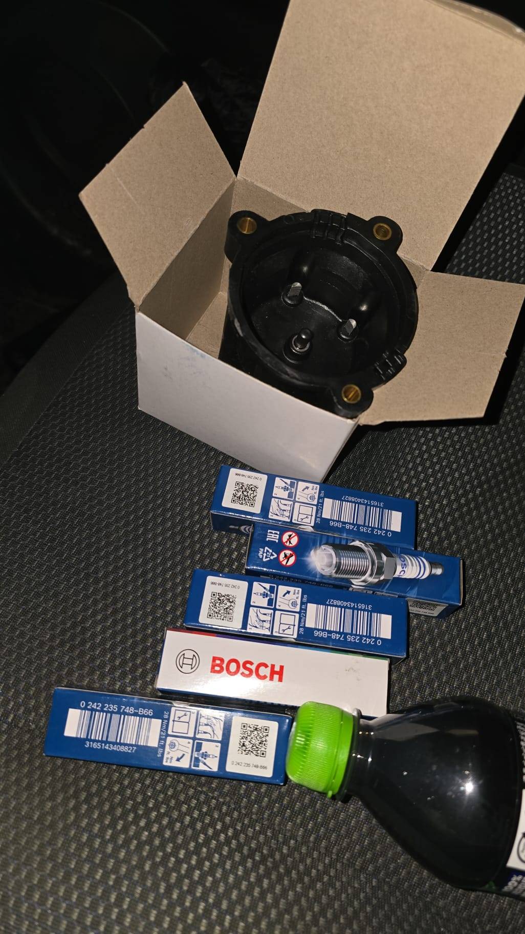

I replaced the spark plugs with Bosch ones and installed a new distributor cap, identical to the model the previous owner used. It was the most affordable option, but the shop assured me it was fine. After these replacements, the severe rough idle, weak power, and misfire issues were 99% resolved.
Today, however, the car failed to start on the first attempt. It eventually started without any misfiring or rough idling. After driving, everything felt perfect, but later, upon restarting, it experienced a brief rough idle (a 200 RPM drop) for about 1–2 seconds. This is sooo much better than before, where the idle was persistently rough, making the car undriveable. :cry:
The previous distributor cap had condensation inside when we cleaned it, but there was no oil present. It seems the seal is damaged, and I haven’t replaced it yet. Could this condensation inside be causing the brief rough idle?
The rotor appears clean and in good condition, with no visible issues. :)
Additionally, I’ve temporarily disconnected the main PCV tube at the top of the engine, and the dipstick is raised about 2 cm. Is that okay? A new PCV system is arriving this week, and I plan to replace the cam seal and reconnect everything. I hope the temporary disconnection of the PCV tube won’t cause any damage...
Could the condensation in the distributor cap, the disconnected PCV tube, or other factors be contributing to the rough idle? Your guidance would be greatly appreciated.

BeerDeer wrote: 09 Dec 2024, 12:19 ... Today, however, the car failed to start on the first attempt. It eventually started without any misfiring or rough idling. After driving, everything felt perfect, but later, upon restarting, it experienced a brief rough idle (a 200 RPM drop) for about 1–2 seconds. This is sooo much better than before, where the idle was persistently rough, making the car undriveable. :cry:
Yes. I advise you to remove the cap, remove the rotor and the metal plate under the rotor and look at the cam seal. If the seal is dislodged it will leak moisture into the cap. And more moisture accumulates, the rough idling will get worse. If the seal is dislodged you can push it back in until the PCV work is done.
BeerDeer wrote: 09 Dec 2024, 12:19 Additionally, I’ve temporarily disconnected the main PCV tube at the top of the engine, and the dipstick is raised about 2 cm. Is that okay? A new PCV system is arriving this week, and I plan to replace the cam seal and reconnect everything. I hope the temporary disconnection of the PCV tube won’t cause any damage...
Disconnected PCV tube and lifted dipstick should not contribute to rough idle. They may leak oil and make a small mess and cause bad odors, but the car should udle smoothly.
