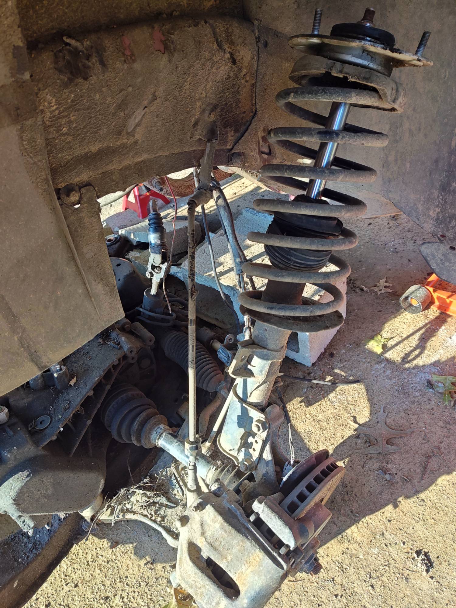

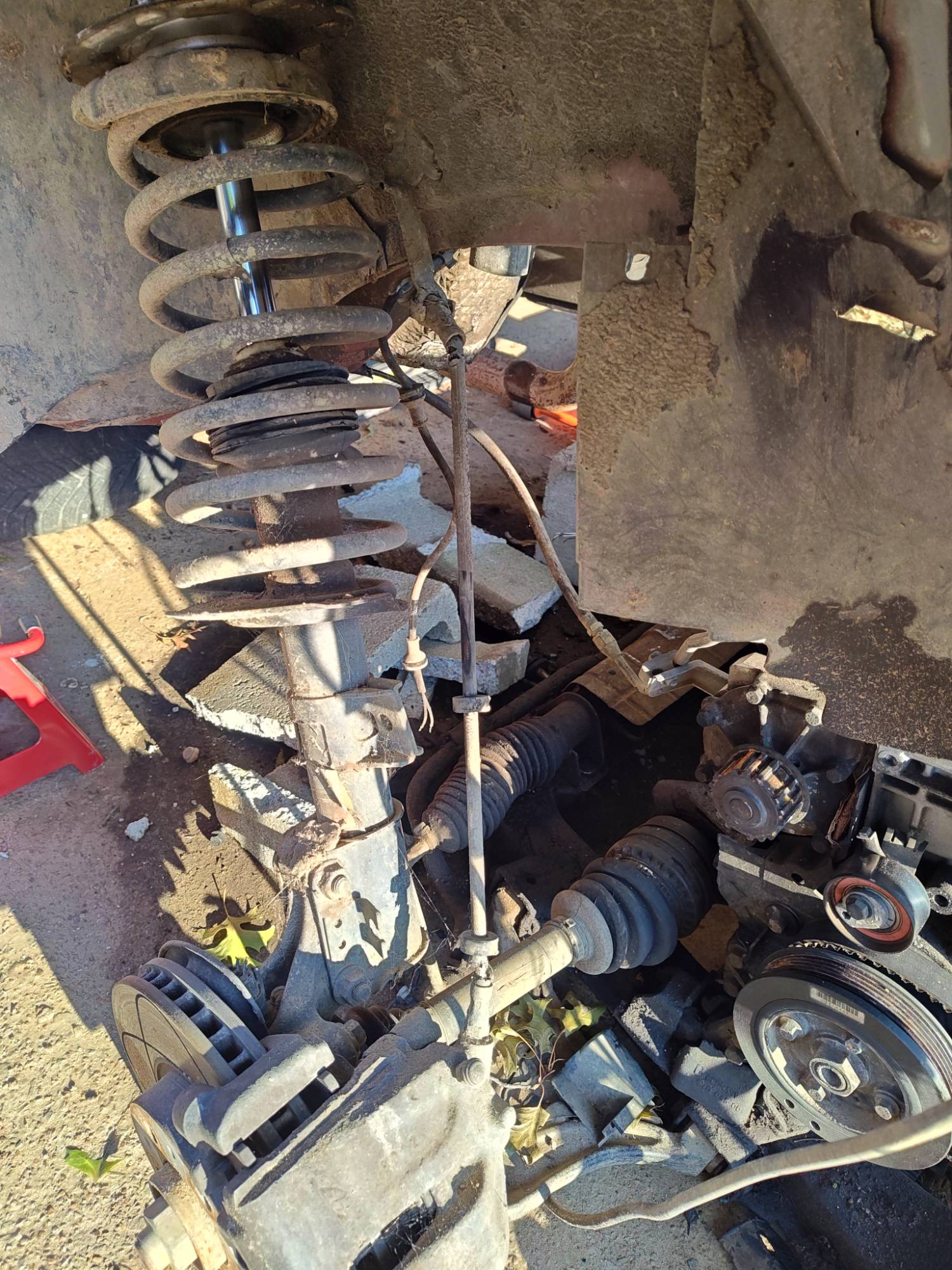

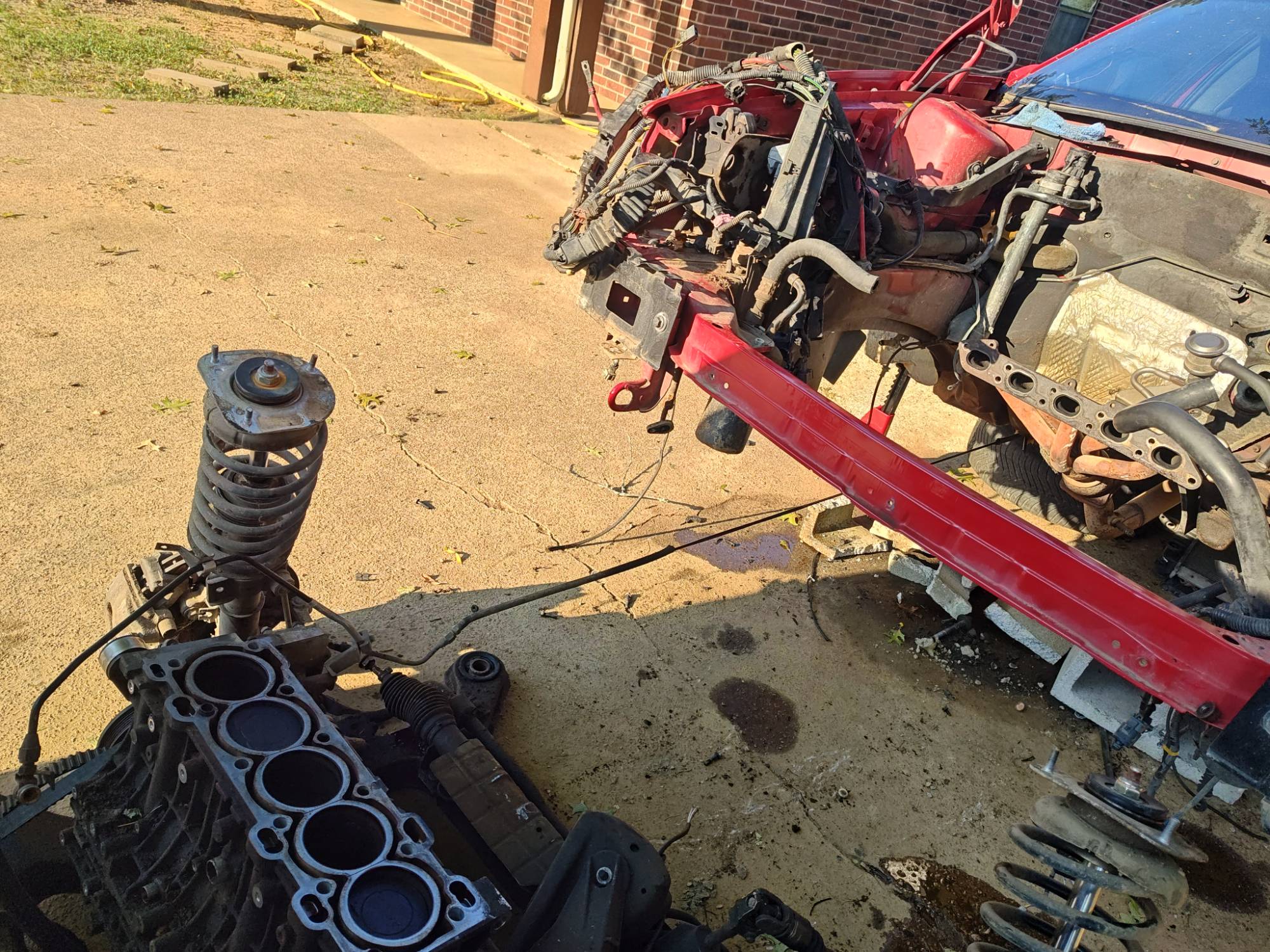

I forgot to disconnect the brake lines and fuel line. WOW how durable they are!!! See below.
As you can see, I managed to remove the spaceship ONLY by bending it upward before spinning it.
I had already loosened the 12mm nut on steering rack to drop it out. I thought that was all that was required. OH BOY I tried dropping it out and that one bolt held the entire weight of the subframe. WOW THATS A STRONG BOLT!!! But turned out the paired bolt had to be removed completely.
On the head, I noticed a difference in the carbon build up on the intake valves. The three on the passenger side and farthest driver side were all fairly similar. But second from driver side was kinda oily. Im assuming that was a cause of the misfire it had? However one of the far driver side valves had a strange gray crusty on it. Strange.

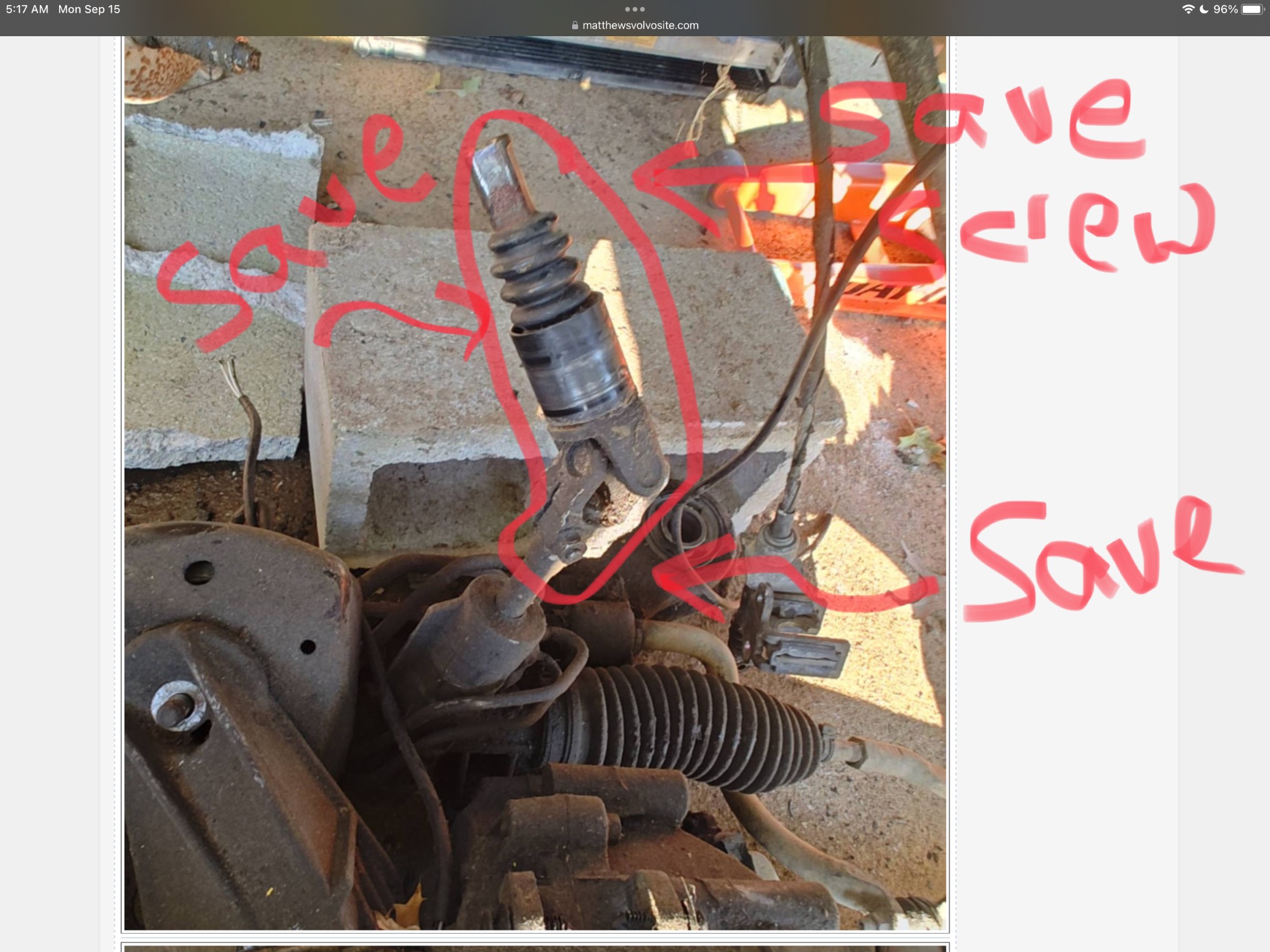

Save the spaceship and that steering coupler. Those aren’t available new any more

Be very careful using cement blocks to support things like cars and engines. Results like shown in your photos - broken. High risk of personal injury. Best to use wood blocks or jacks.

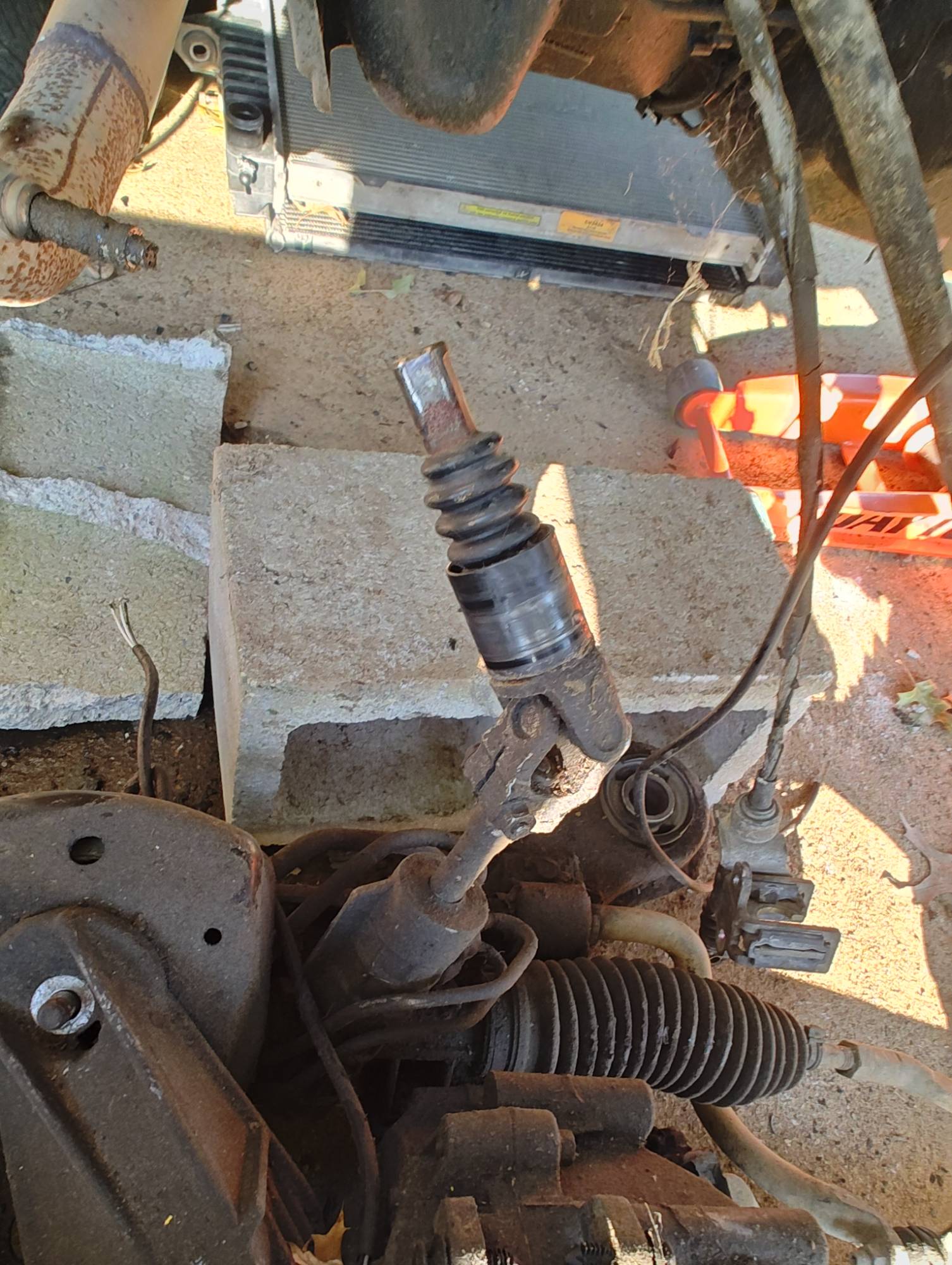

abscate wrote: 14 Sep 2025, 15:09 Save the spaceship and that steering coupler. Those aren’t available new any more
Ive saved the spaceship. But Ill figure out how to get the steering knuckle off. Are you refering to the steering rack or pinion? is it the thing I posted a pic of?

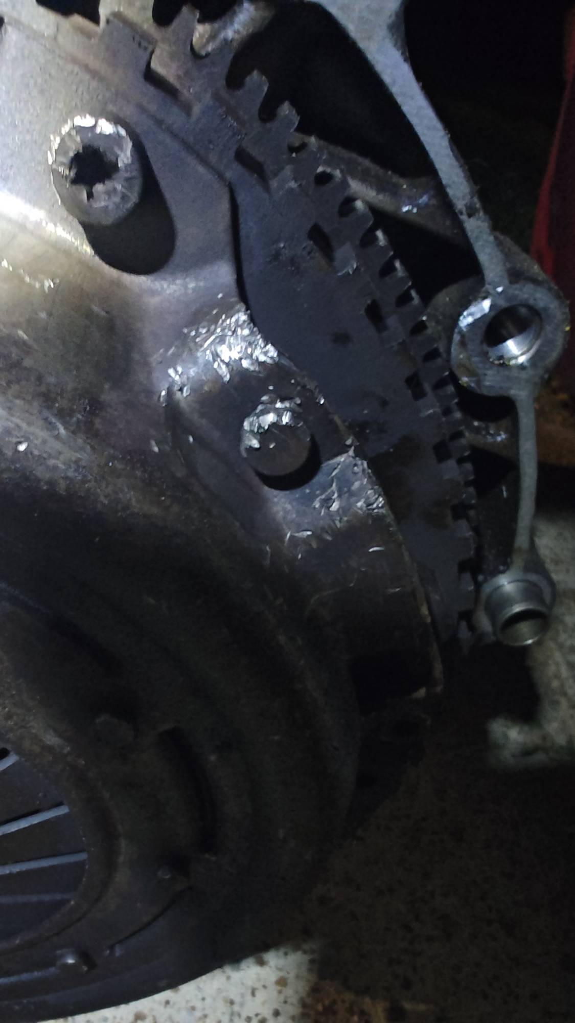

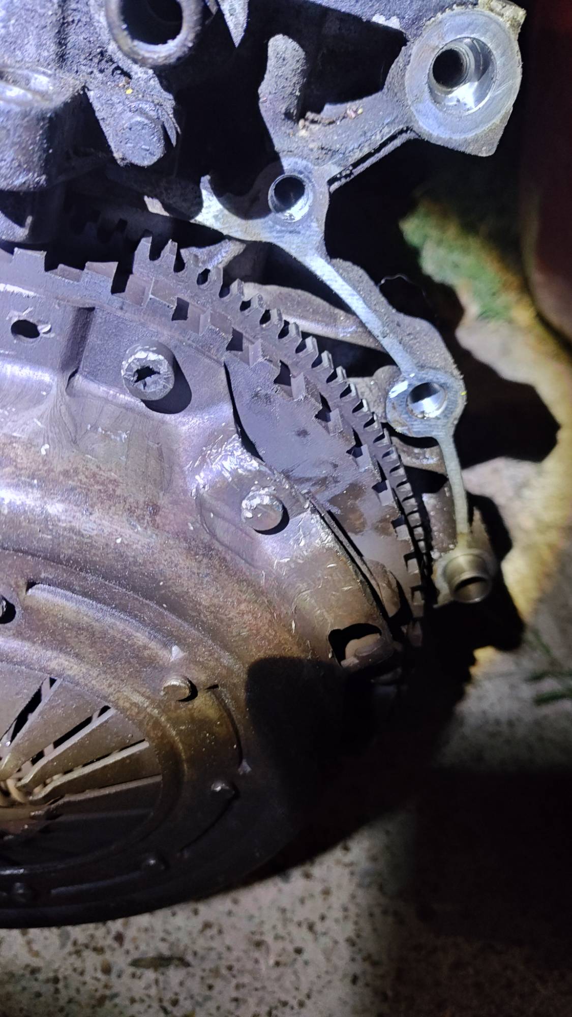

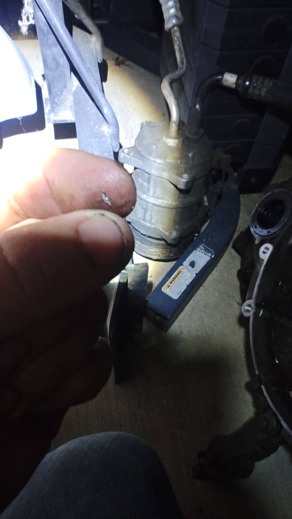

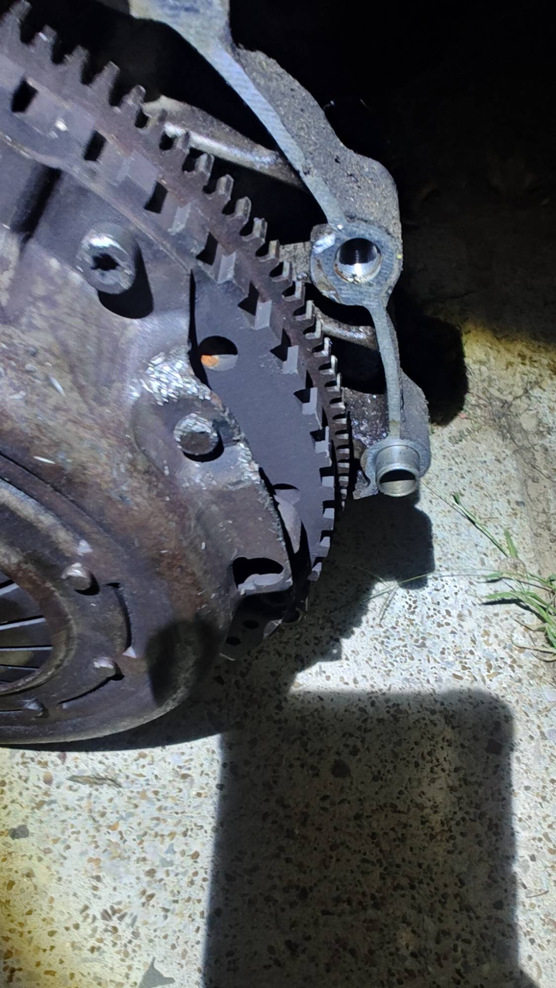

I have a few pics of some damage on the transmission (flex?) plate and inside the bell housing.

Nothing to worry about on that flywheel and clutch pressure plate

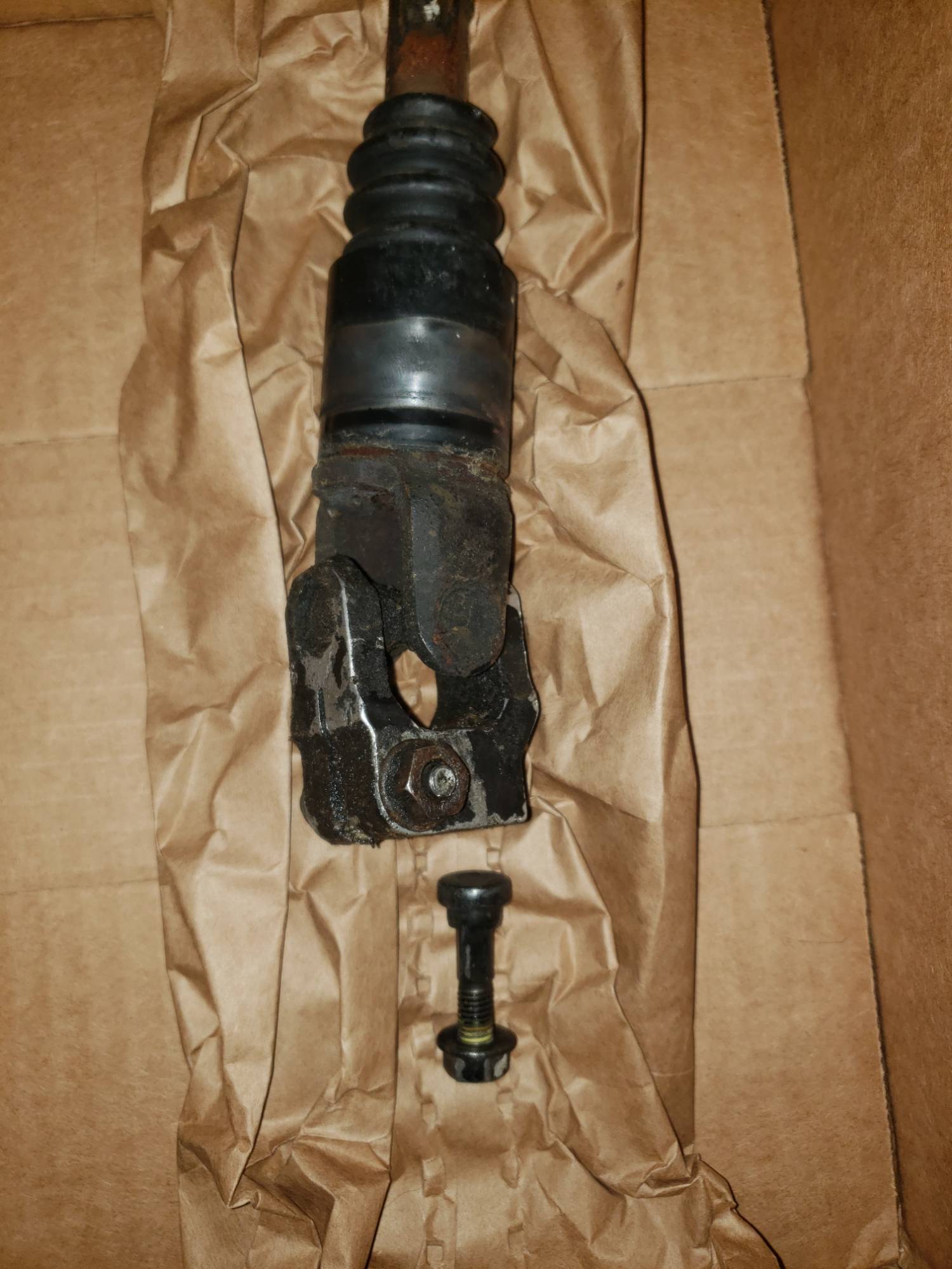

See pic for thing to save! You want all the hardware too, the funny butterfly bolt at the top is also NLA
The coupler should come off the rack ok after your remove that pinch bolt , soak it in liquid wrench or PBB for a day, then gently tap it up to come off.

abscate wrote: 15 Sep 2025, 03:16 Nothing to worry about on that flywheel and clutch pressure plate
Can you send it to me for $50 plus shipping?
So the housing and pressure plate are totally fine?
Yes will do. Will remove then get shipping info. I only have Paypal btw.
Also do you want the spaceship? I slightly bent the elbow in order to remove from manifold but can easily be bent back into place.

Abscate, I'm pmed you. The message is staying in the outbox and it has not completely sent. I don't know why. Checking that this is all you wanted. I saved the spaceship. Do you want that too? Please PM me the address to mail it. I'll send my PayPal email once you pm me.
