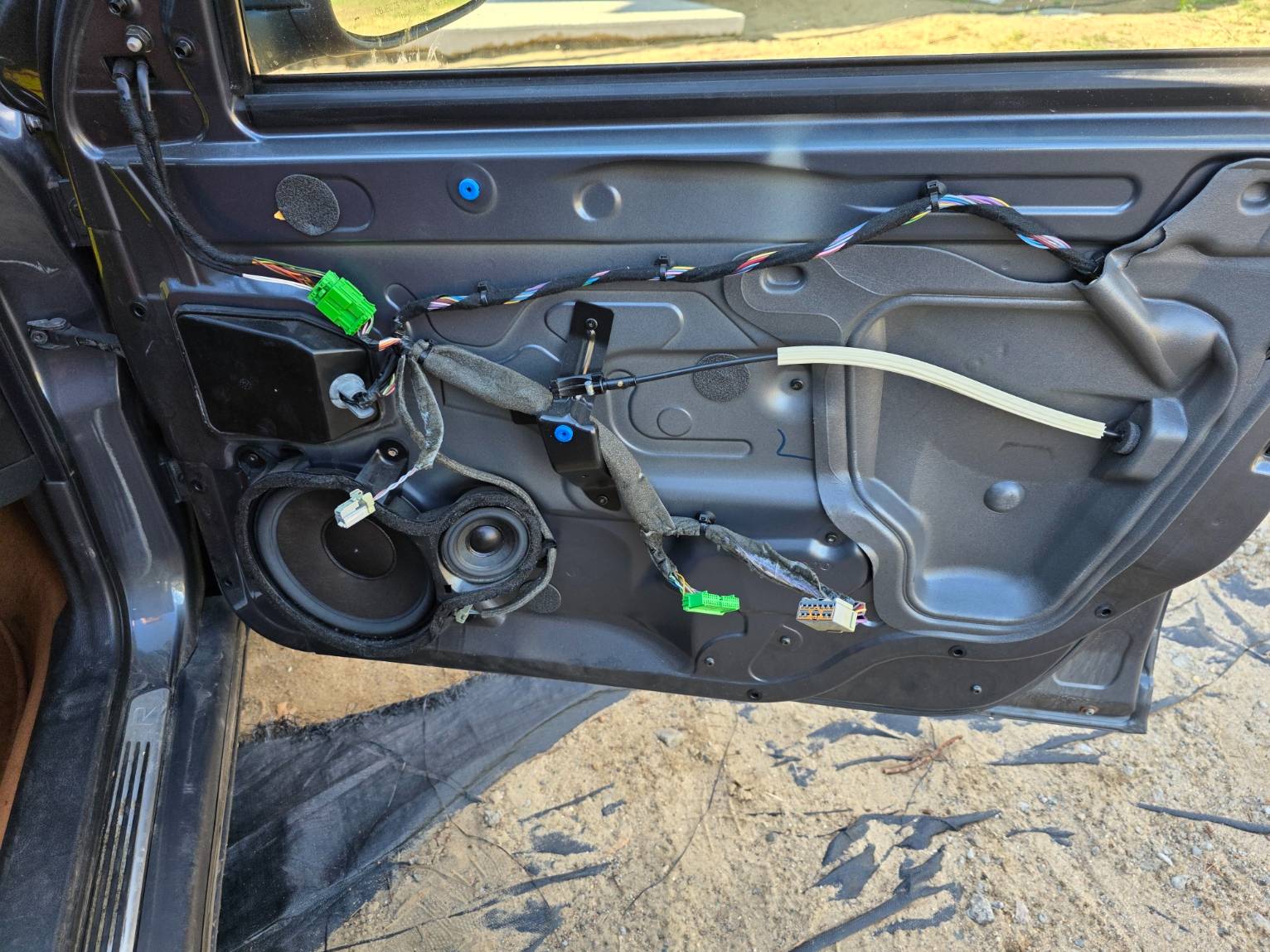

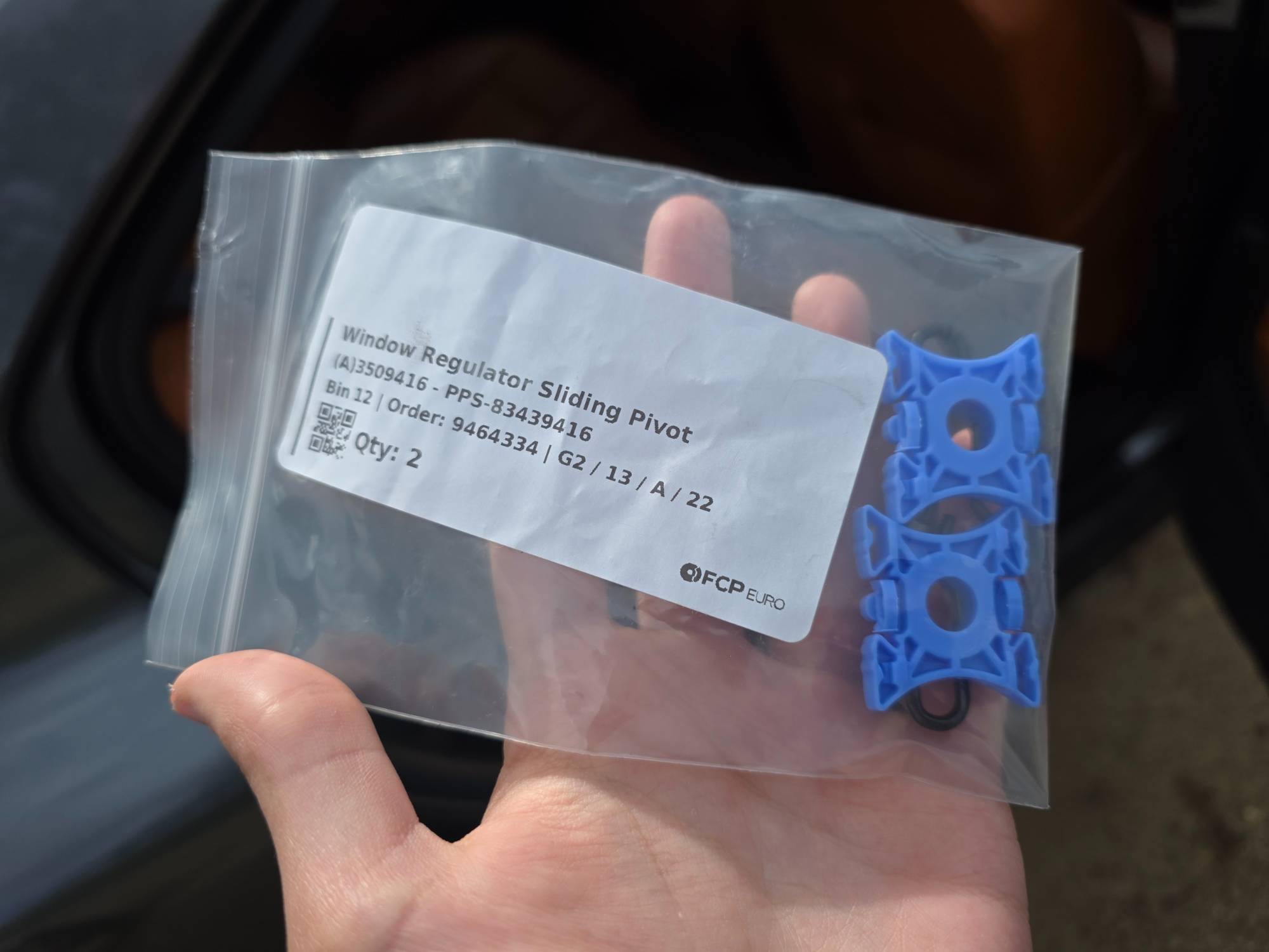

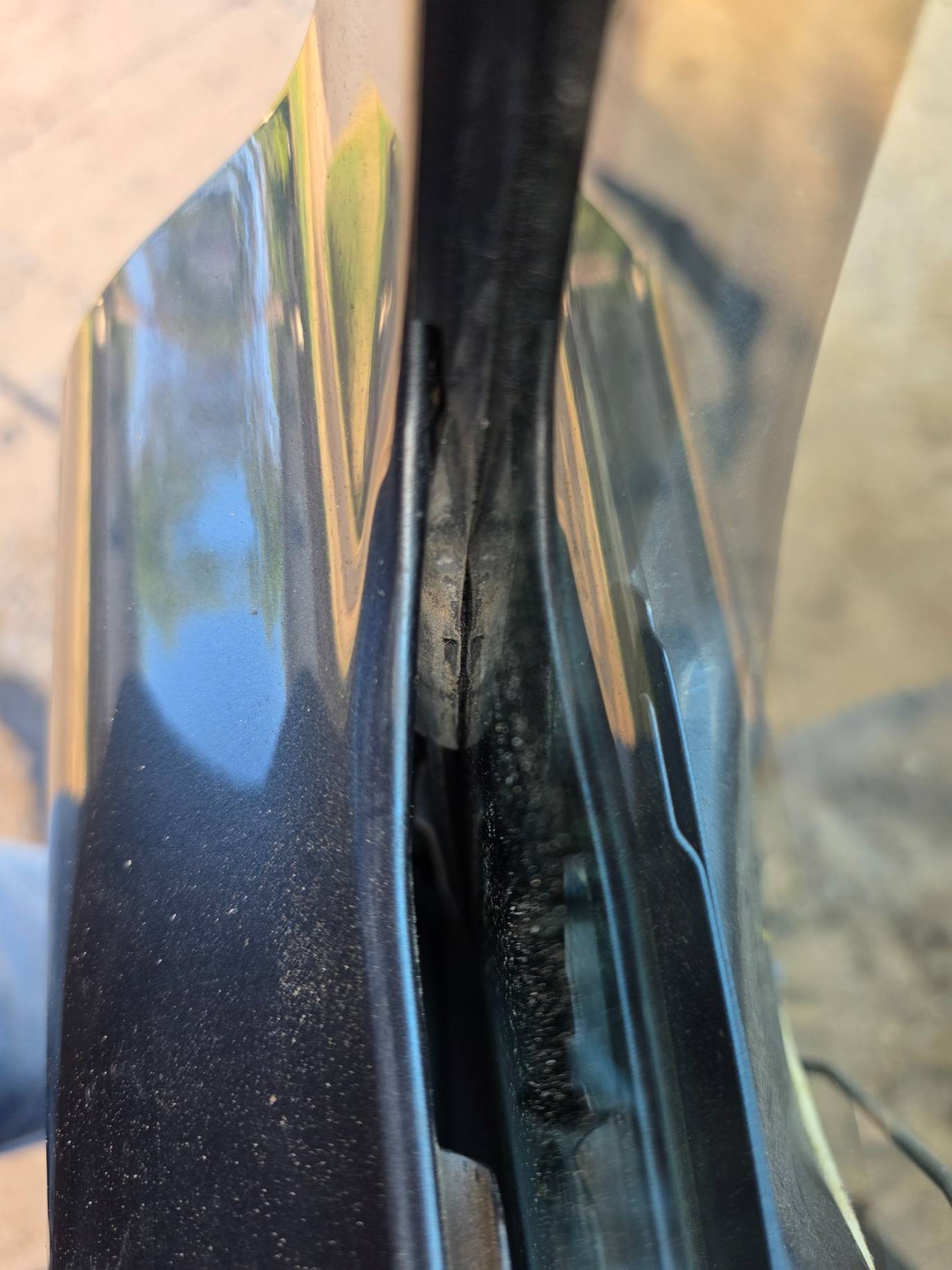

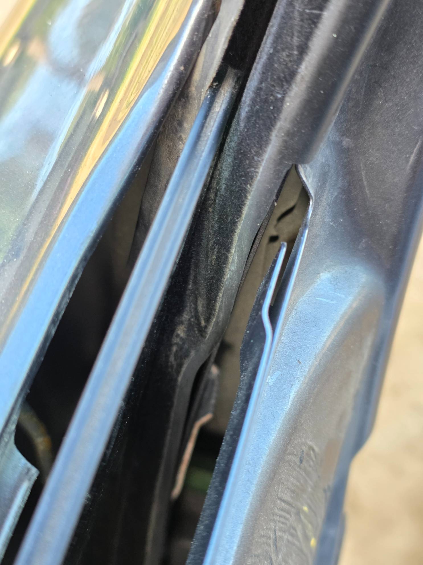

Fixed the nonfunctional front passenger window. The new window regulator sliding pivot parts from the previous owner arrived today and I got it fixed. I also found out why they broke in the first place. The rubber/felt window track somehow manage to get dislodged and wedged entirely to one side of the window within the door, causing the glass to get wedged and snap the plastic pivots. Over time this caused one of the regulator arms to get bent too. I bent the arm back to straight as best I could, removed the rubber/felt track and reinstalled it correctly and put in the new pivots and viola, the window works and the door is plugged back into the car!

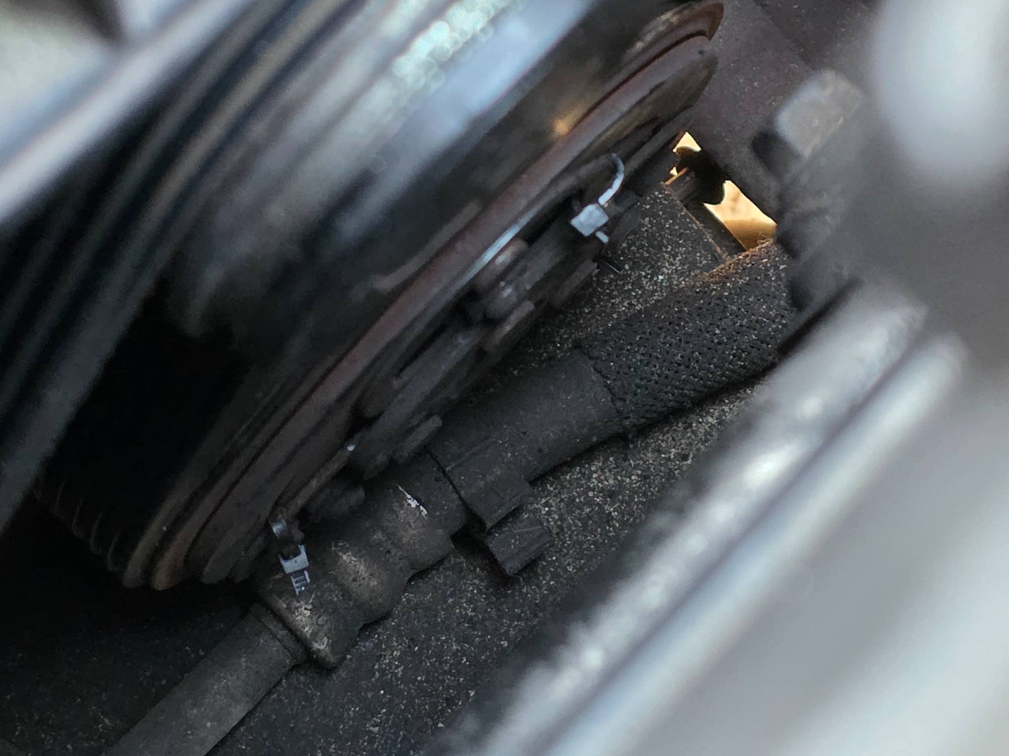

I shimmed the AC compressor clutch today. Sure enough, shimming it with three zip ties the same way as I did on my V70 solved the problem. AC now blows ice cold all of the time!
