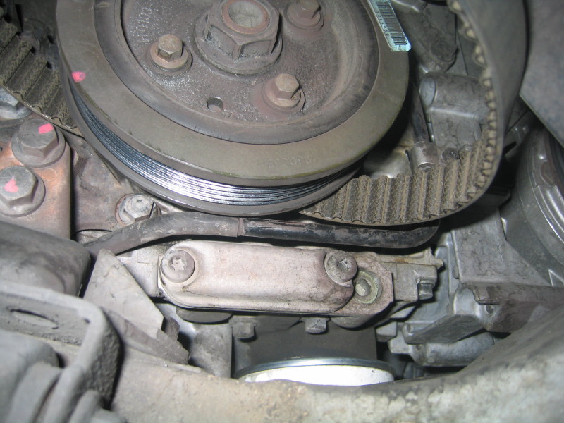

You think so huh? Take a look at this picture from my 1999 S70 non-turbo. See that hard gas line right at the bottom of the pulley. Ain't no way that belt is coming off without either removing the pulley or the gas line. The pulley is easier.

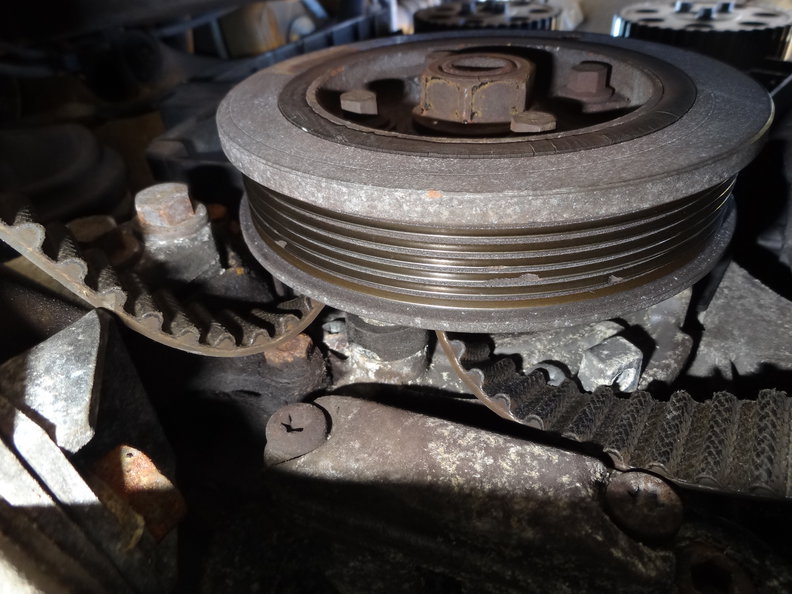

OK, just finished up a timing belt a few hours ago. Yes, the belt can be fanagled up into place. It's not easy as there is a piece of the engine and the plastic back cover than get in the way, but there is just enough space to get it up in there without taking off that pulley. (I didn't have any fuel lines there, though...)
I ran out of light and had very little battery left on my camera so couldn't really take a video of it, here's what I did... A little twisting, pulling from the top, pushing from the bottom.
Thank you all for the words of encouragement!

Nice picture of the mystery nub, the bane of many a timing belt replacement

It was quite a mystery nub indeed! :D

I notice you car doesn't have the hard gas line right at the bottom of the pulley.
https://www.matthewsvolvosite.com/forums ... &mode=view
In this picture the belt is hung up on the nub, not on the pulley. Is there truly no room between the pulley and the gas line? I have never worked on a P80 with the hard gas line there but since this is the first time I have ever heard of it, I suspect it is not on the way.
