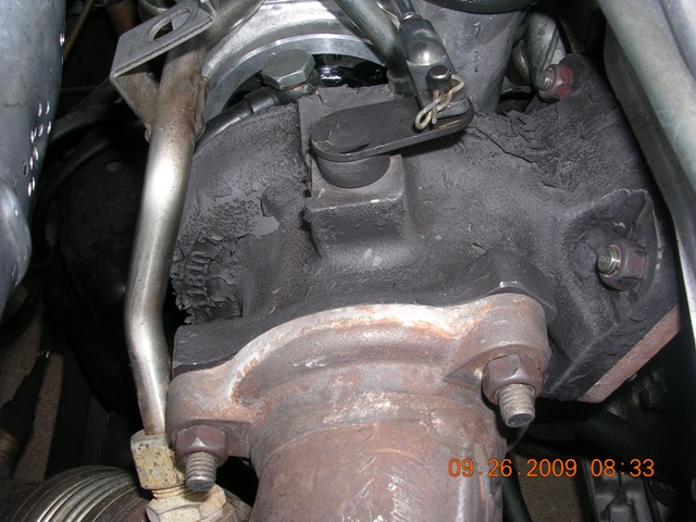

3) With dash temp gauge always horizontal - normal, going down the freeway running 205F, intown ~215F. Max I have seen 218F. Not sure if this is ok, seems hot.
4) the turbos 'paint' is flaking of as it seems hot. 5) If I put her back together ok, what else could be contributing to the higher than what I perceive is normal temps? Could I have a cracked block? How does one test for a cracked block?

PS - I had never responded on the burned paint on the turbo. I have never seen one painted. Did you paint it or did you get the car that way?
