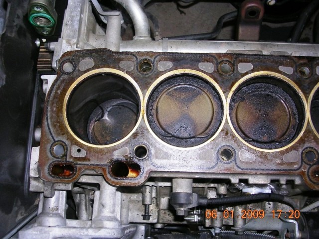

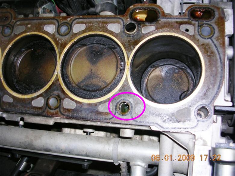

Six weeks from starting head removal – head off…..Just looking for (1) does this head gasket look ok? (2) if head gasket ok, what else is suspect…..thanks
Head off…..pics
Cylinder 3-4-5….note magenta circle……why blocked?V70 1998 3-4-5.JPGV70 1998 Cylinder 1-2-3V70 1998 1-2-3.JPGV70 1998 Don’t like rad fluid in head bolt hole?1-2 Bolt Hole Rad Fluid.JPG1-2 Bolt Hole Rad Fluid

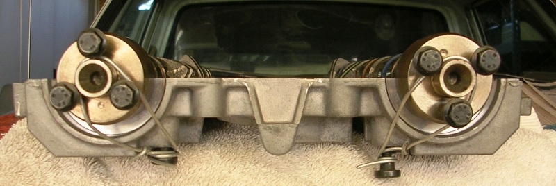

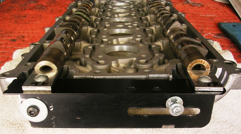

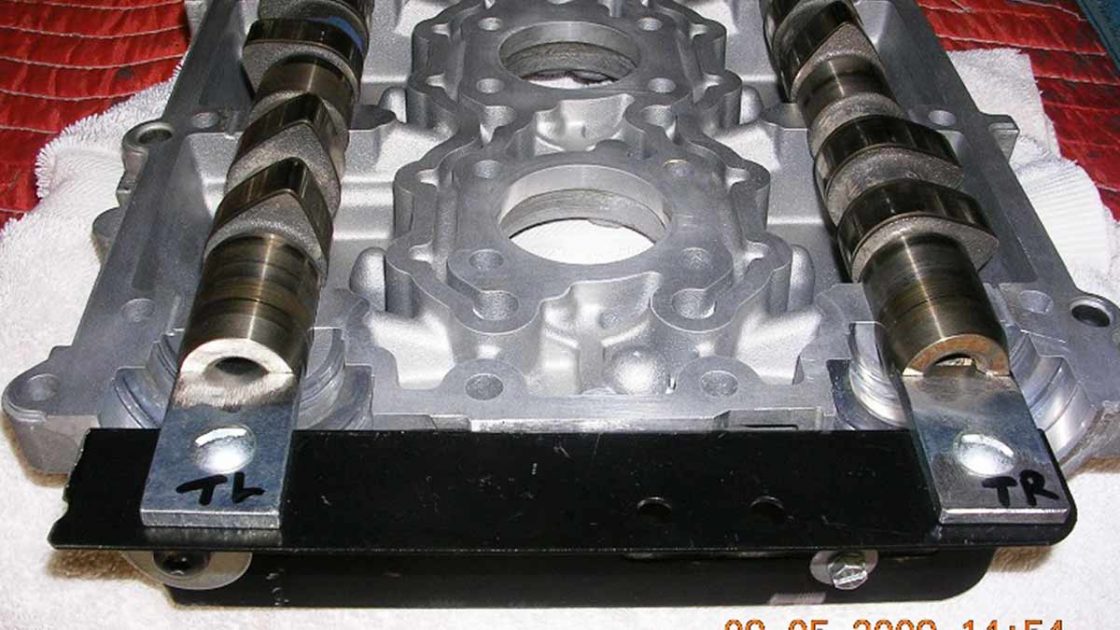

The homemade cam retention device
Fordman » A little labor today, homemade cam retention device fabbed from ‘all the stuff you can’t just throw away’.
1) does my cam alignment look correct?
Tomorrow the cams go on, next will be the timing belt (next challenge – don’t the camshaft gear ends need some type of alignment??)
Thanks to all….
