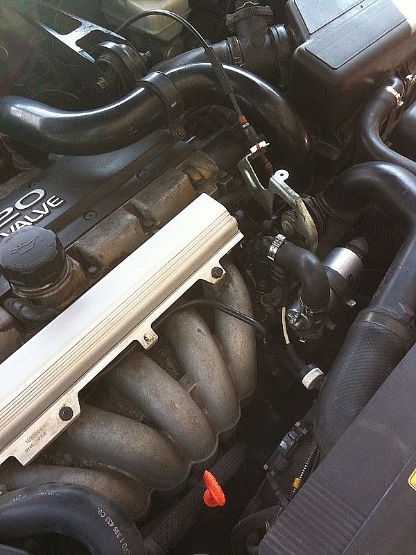

I like pictures because they really help me to understand things and I am sure it'll help others who are curious. So I want to understand the vacuum hoses. I took off the throttle cover and I believe I revealed the vacuum tree.
Here's the area covered by the plastic cover. The cover went over the part to the right of the intake manifold pipes.
Now here's a closeup of the vacuum tree area. I have put numbered labels on each hose that looked like a vacuum hose to me. Can the more knowledgable folks here identify each of these hoses?
Unfortunately for me, the only hose that looked even slightly worn and or brittle was #5 where it went into that cylindrical looking inline part that's half black and half white.
So I am still struggling with this problem. I see that someone posted a ECT as a possible cause. OK, now todig around to see what that is.
I'm looking forward to hearing back on the vacuum hose functions. Thanks everyone.

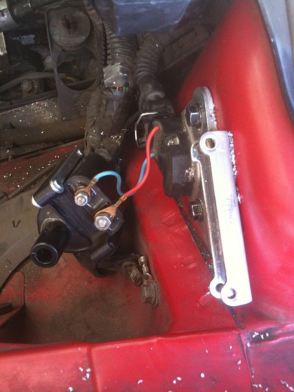

Everyone, after several months and 3 service visits and about $670 later, I have fixed the misfire problem. As you may have guessed, it was something simple but I sure went through a lot of !*&%$ to finally fix it.
Let's cut to the chase. It was a bad wire from the coil to the distributor cap. Now, I don't know how 3 visits to 3 separate service stations didn't reveal this. The fact is, they just never looked. The wire was fried crumbly inside. When I tried to remove it, it just disintegrated in my hands. First place told me they found nothing. $100

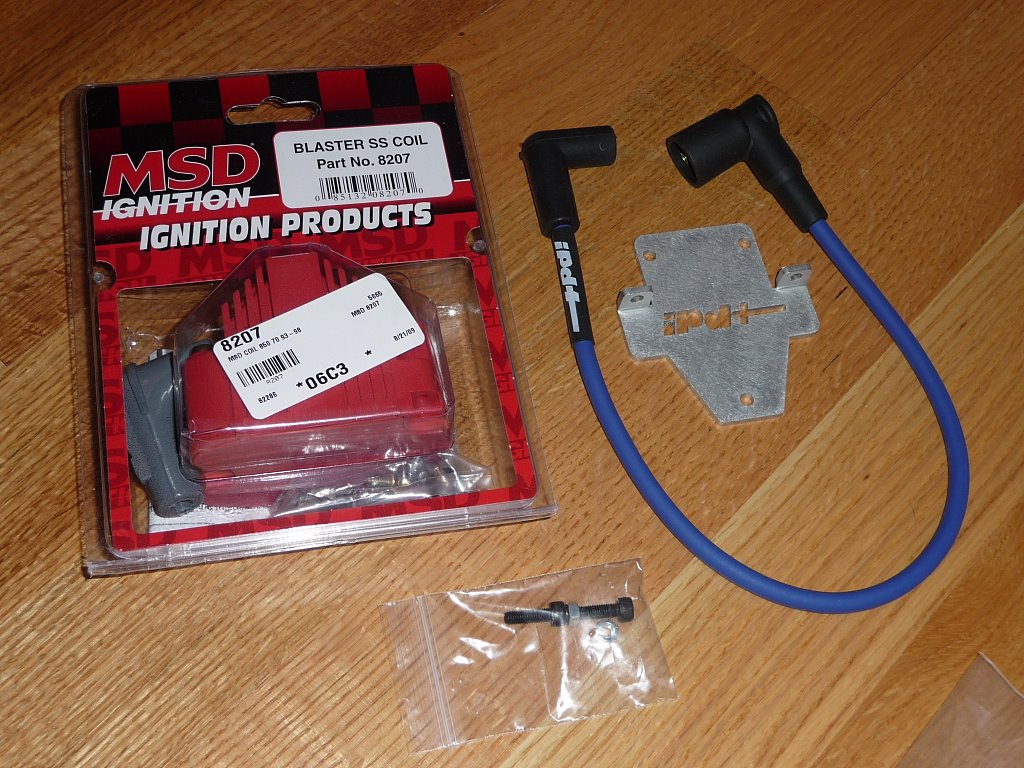

Parts bought: $276 + tax
OEM plugs from dealer: $56
Crank Sensor: $72
MSD Ignition upgrade: $93
Cap: $33
Rotor: 22

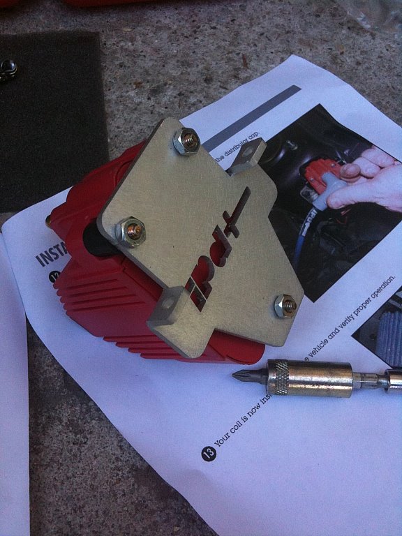

So I proceeded to replace everything they told me. I thought I would share in pictures. I will say that the thing I really needed was a new wire. I got that wire from the folks at IPD along with their MSD coil upgrade. The mounting bracket for the new coil is beautiful, but it'll never be seen! That's too bad.
