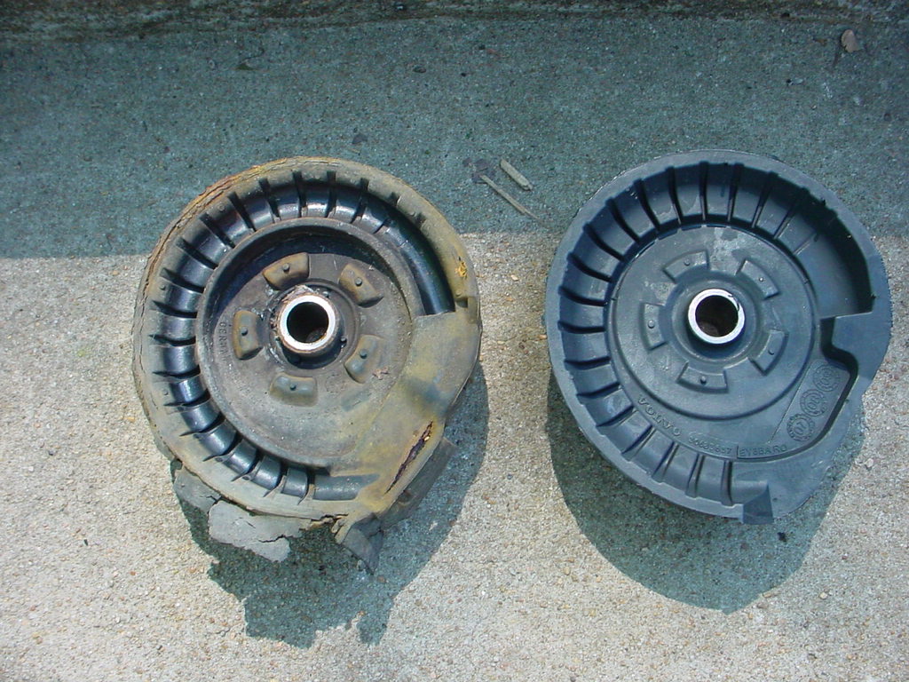

At the point where the spring makes contact they don't look significantly different, where the difference is is the amount of rubber around the bushing that always breaks, here is a side by side comparison. The top side looks identical.
I have always changed mine 2 at a time (along with the struts) so I really cannot testify as to whether mixing and matching them is a bad thing or not.
