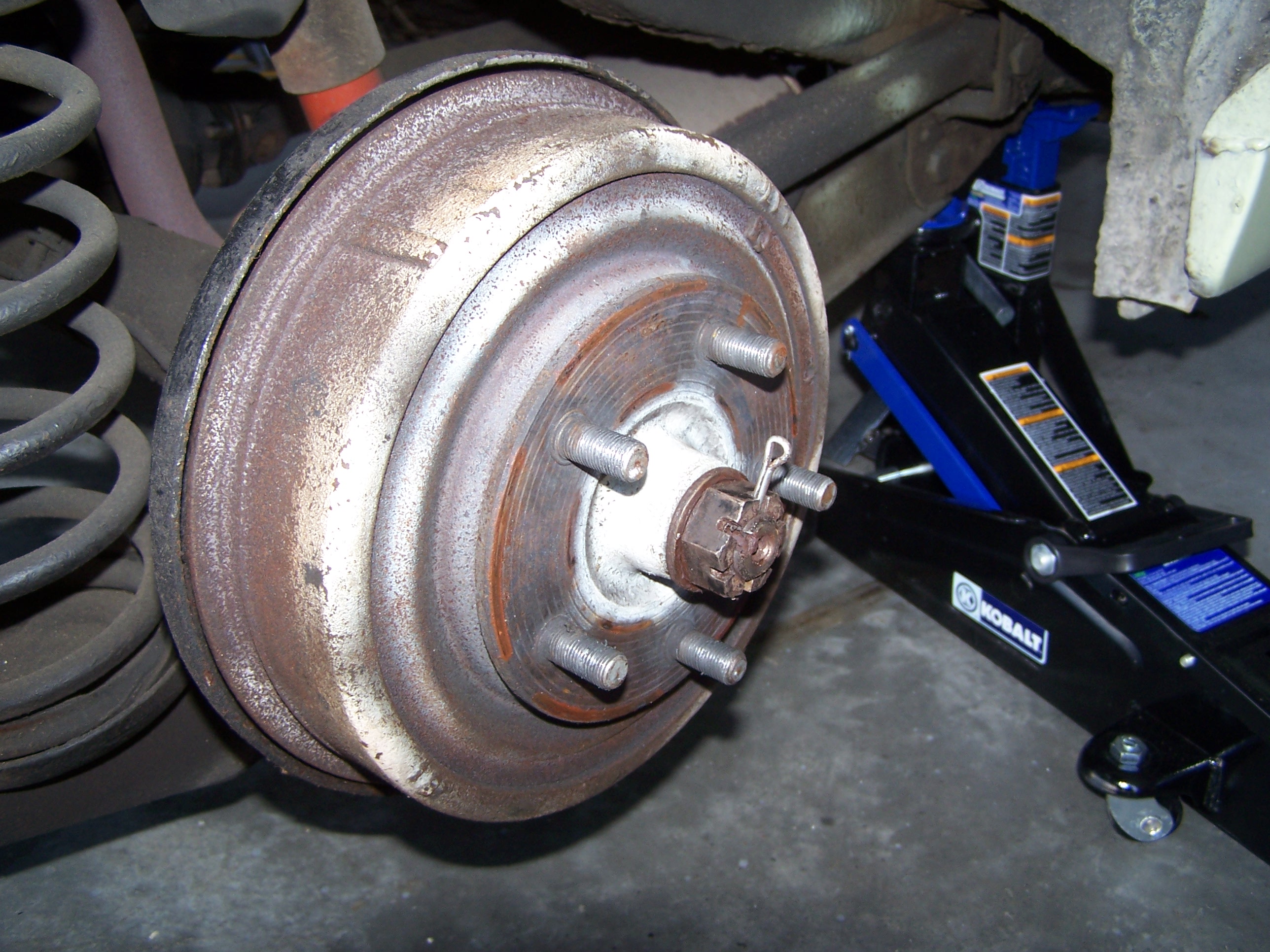

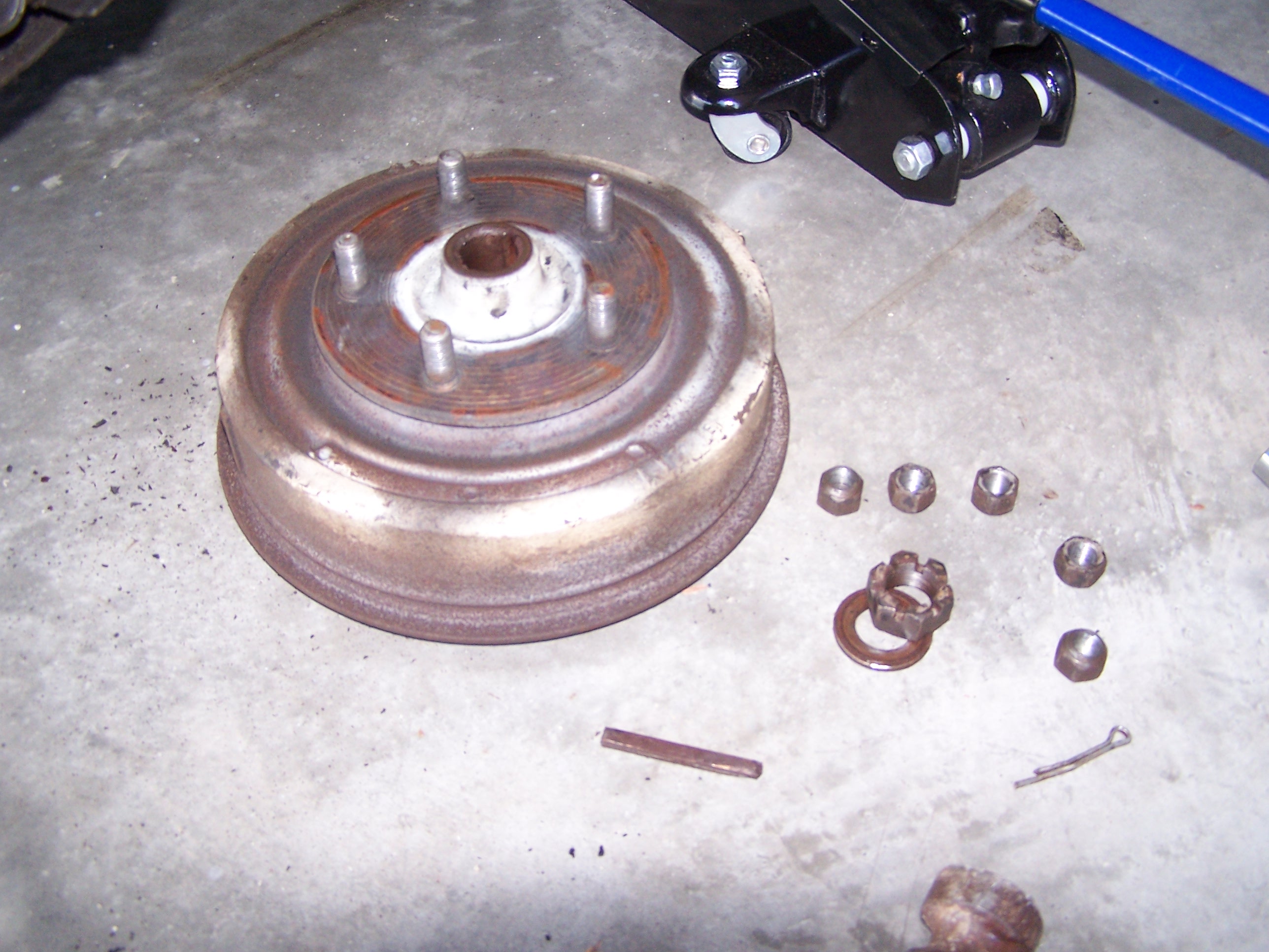

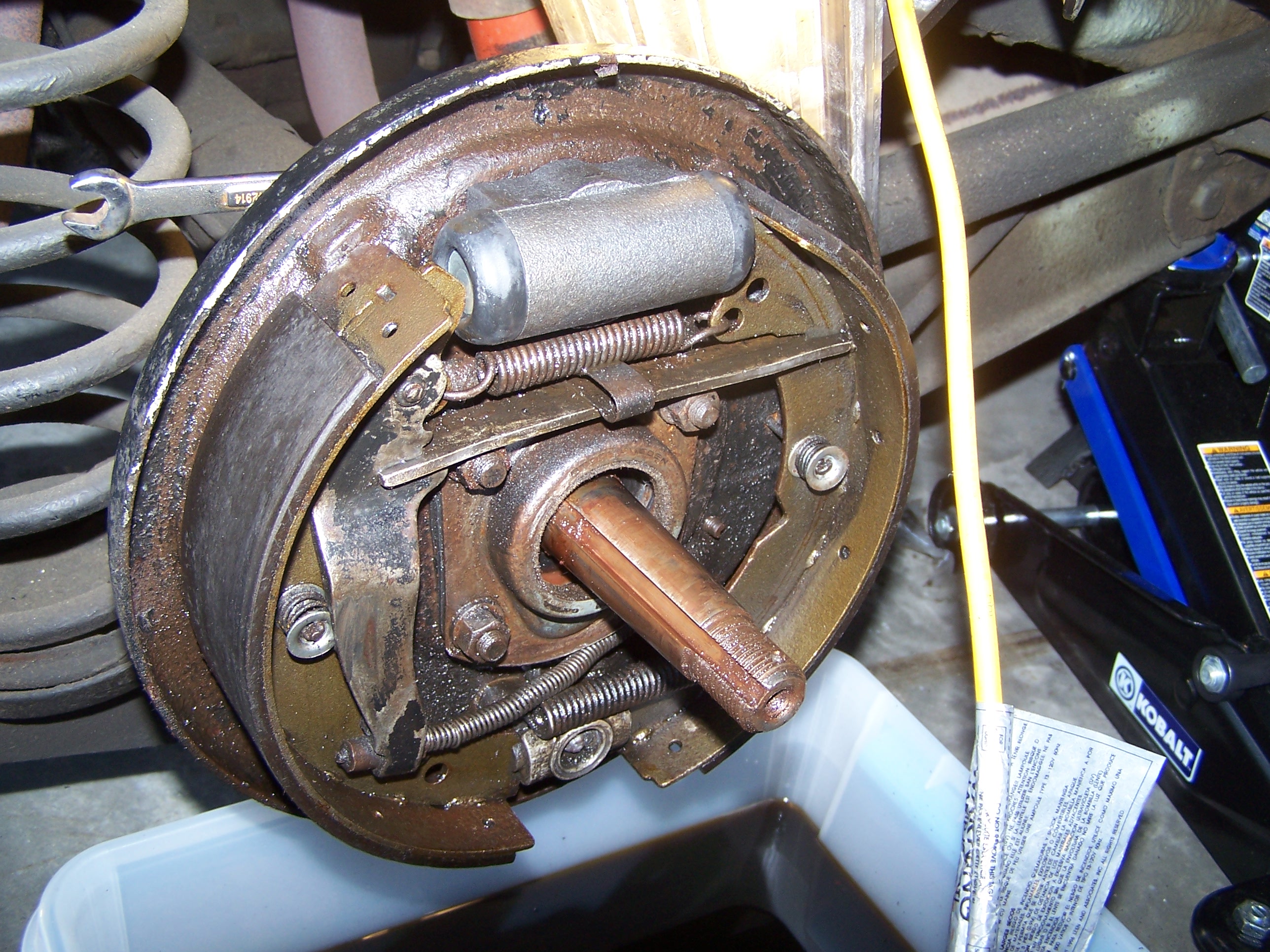

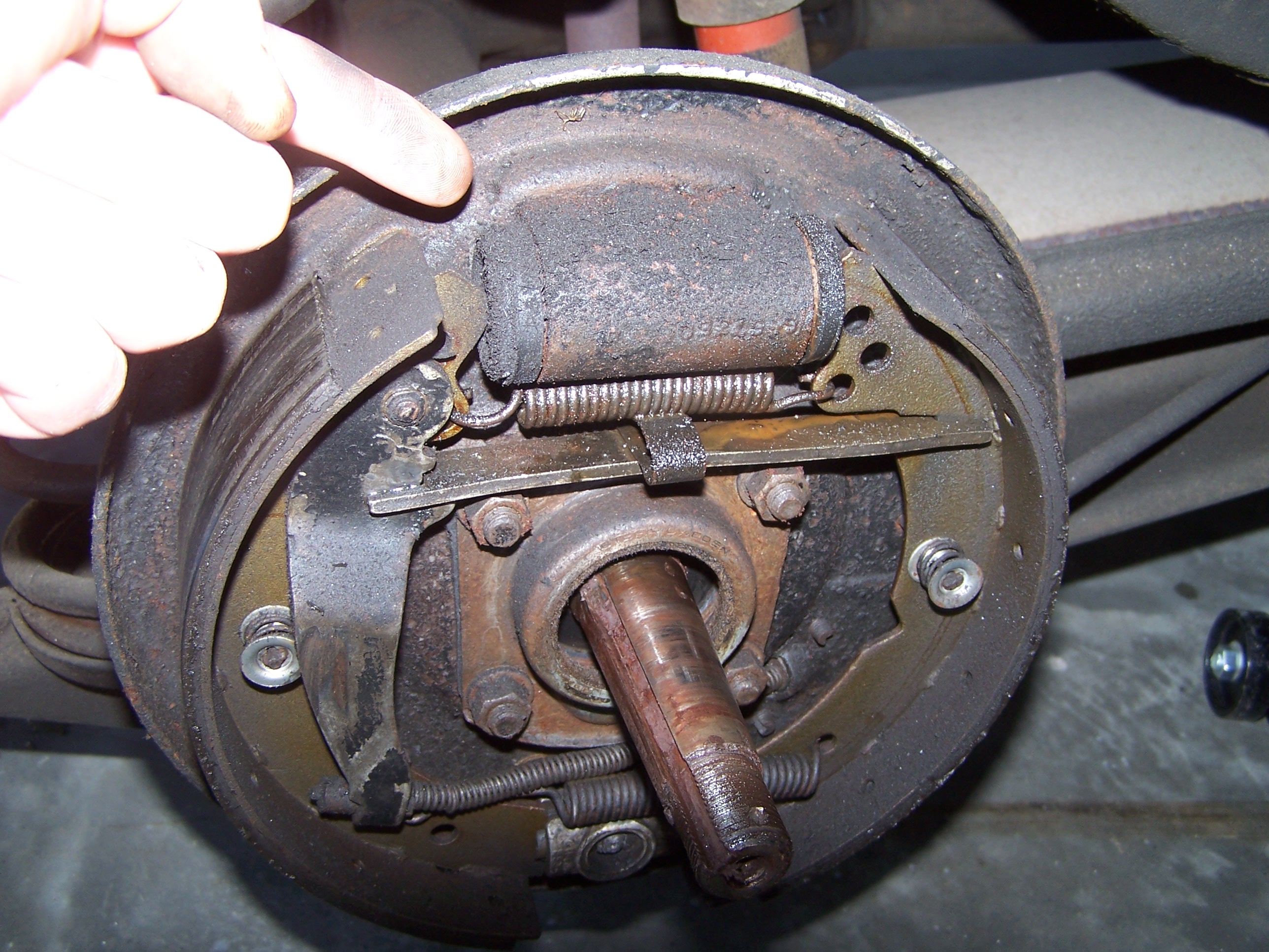

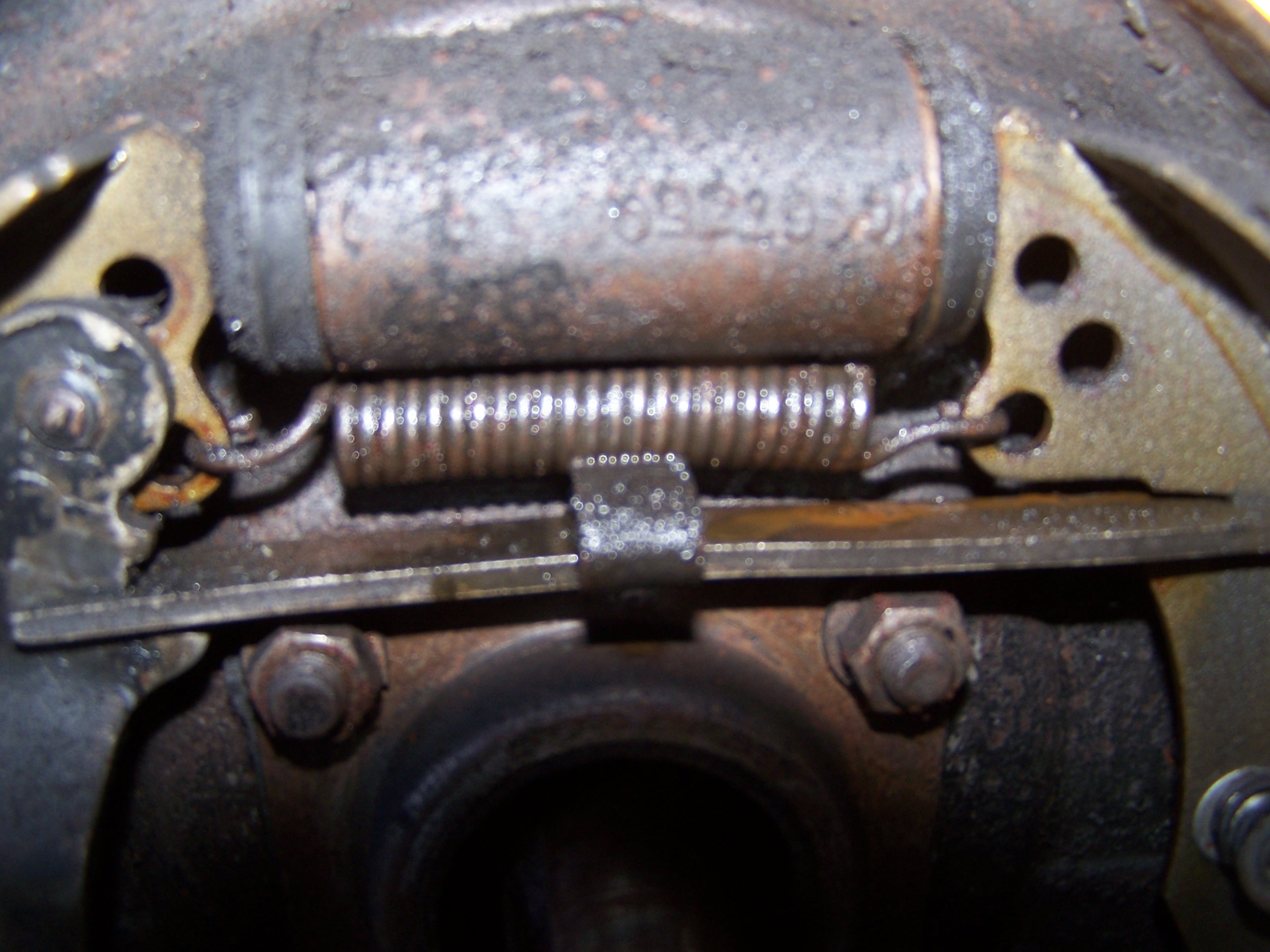

I replaced both rear wheel brake cylinders. Here are some photos of the process if anyone is interested.
- Removing the old cylinder was easy. I first removed the old bleeder valve because it sticks out and is in the way. Next, I removed the brake line..... careful not to strip it. I don't have a special wrench, so I got a standard wrench on tight and gave it a little hit with a mallot. She came loose easily. Lastly, I removed the 2 bolts that hold the cylinder n place.
