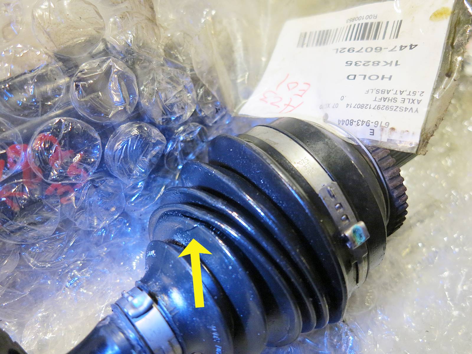

The grease is spraying out at the passenger side inner boot, but no visible tear.
It appears the surface under the large clamp has developed a leak on 2001 V70XC.
The two front replacements 2007 Axle Shaft with 53,000 miles arrived yesterday with a visible disappointing tear at the outer boot. These axles were supposed to be free of any damage.
Is there a source to order two GKN outer boot PN31256231?
Would following this thread help restore it?
tear at cv joint boot
