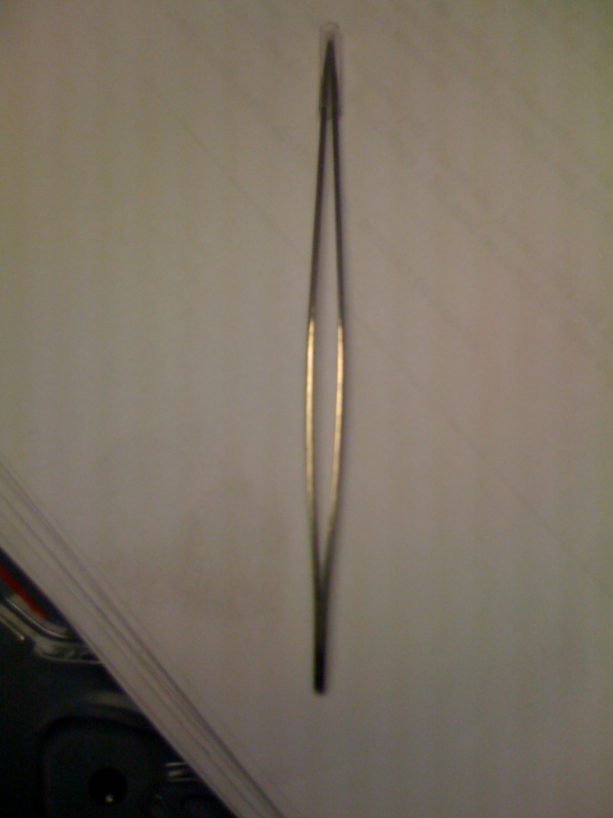

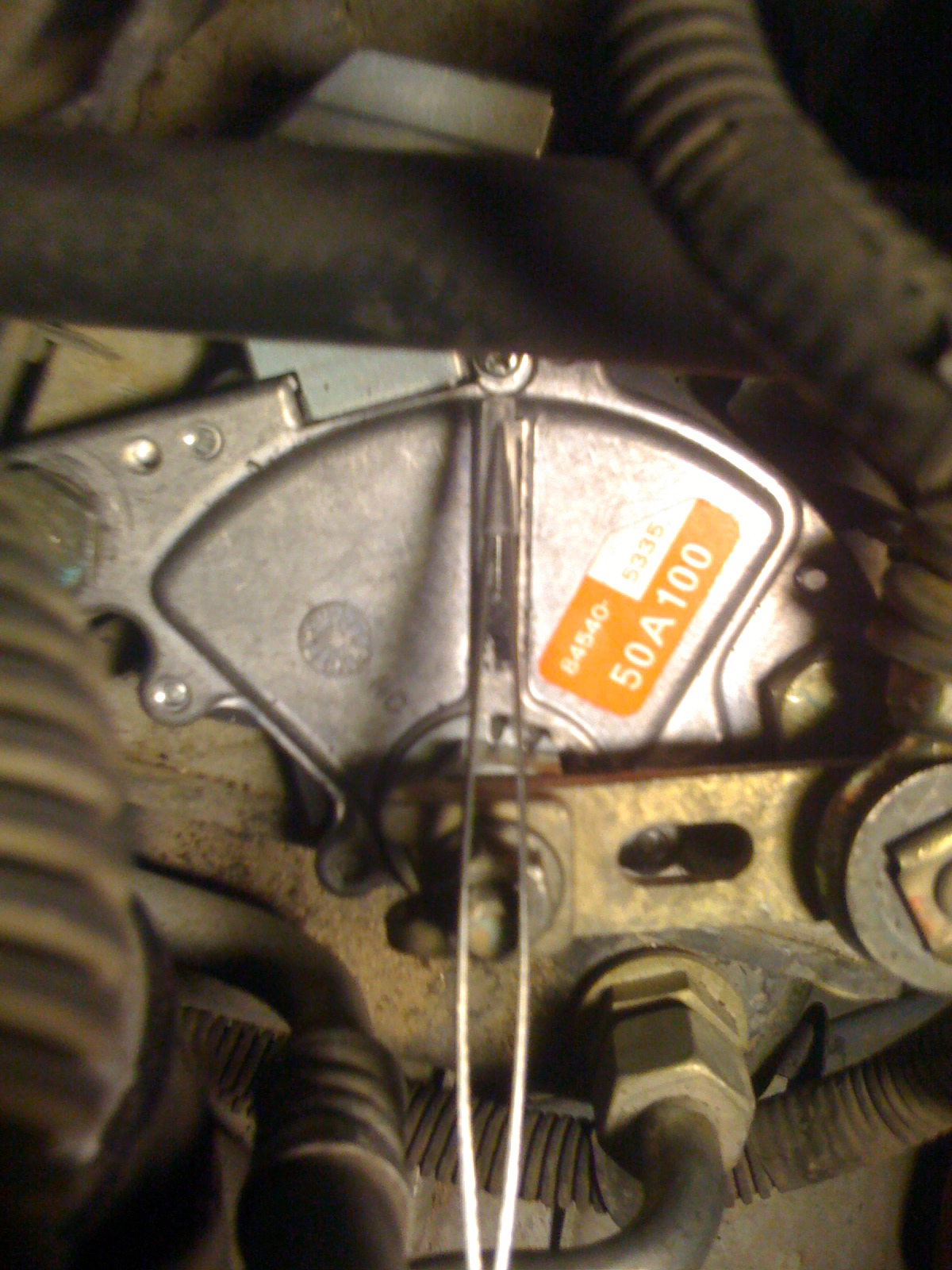

I found a simple method for PNP alignment that worked great.
I bought a 99 cent tweezer from the store.
Leave on the plastic end cap, it makes for a tight fit.
Slide them over the alignment nut and then angle the point down to the alignment marks.
It worked first time out of the box with perfect alignment.
Brian

I like this method. How is it working so far? Everything still fine?
Very well done. Just the section on getting the connector apart was worth its weight in gold.
Couple of comments. Rotating the switch to either extreme didn't turn off the reverse lights at all with gear shift in reverse. However, I found that taking a small metal ruler and laying it up against the flat on the transmission post served as a very good "tool" for aligning. I put it in neutral, set the ruler on the flat and rotated switch until parallel with index line. Is now working fine.

I could not get the reverse lights to go out in either direction, they stayed on the whole time. I adjusted until it would crank in Park and Neutral and used the tweezers to confirm. It will be a few days before I get to drive it as I have a lot of other stuff to do while the airbox and the turbo plumbing are out of the way.
