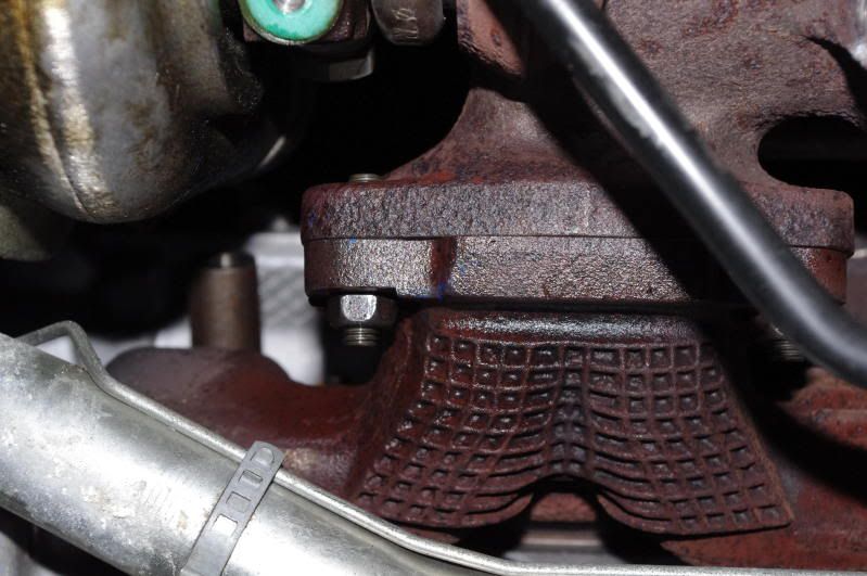

I have reached an impasse removing the turbocharger. The 3 bolts that attach to the downpipe were no problem. Then on the side of the turbo it attaches to the engine with 4 bolts. I've got 3 of them loose, but the lower one nearest the turbo is damn near impossible to get. It's right up next to the curved pipe, so you can't get a socket on it. A puny 13mm open ended wrench is not working either. I've removed the turbo oil drain pipe, but still no dice. Not sure what to do. Maybe I'll offer one of my mechanic neighbors 20 or more dollars and see if they can get it tomorrow.

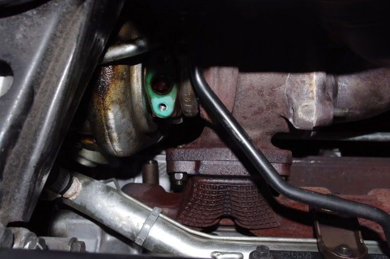

I remember doing our turbo. Could you send a picture of the bolt. If I remember correctly, we worked from over and under the engine. I think we used a 1/4" 13mm socket with a universal on that bolt. I remember it was fun, not. Be sure to use a lot of the penetrating oil. Good luck.

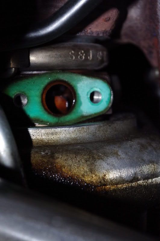

Yep, sounds like this one here.
You can see how there's a coolant rail in the way. It's the larger one in the bottom left. A ratcheting box wrench would fit in there, but Sears only had 12-sided ones.
Judging from the oil lacquer inside the turbo oil drain seal here, this turbo could probably use a rebuild or replacement.
