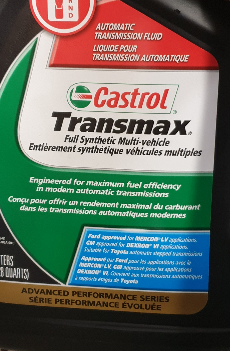

On my 2003 S60 2.4 that was flaring from 3rd gear when hot, I did 3 drains and fills with Toyota T-IV made in Markham-ON, with no success in eliminating the flaring.
Then I replaced my B4 servo cover, with no success. I was considering valve replacing vs. scrapping the car, inclining towards latest.
Then I did 3 drains and fills on my wife's 2006 S60, for she was feeling flares to the 3rd gear, which did nothing.
Then I changed my T-IV atf with CASTROL TRANSMAX Full Synthetic Multi-vehicle (3 drains) and the flares were gone.
Then my wife's with the same Castrol and the flares are gone. I suspect the T-IV batch was wrong so guys around here in Ontario, don't scrap your Volvo (yet) like I almost did, do a final try with this atf.
