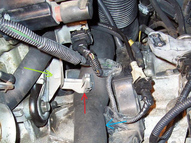

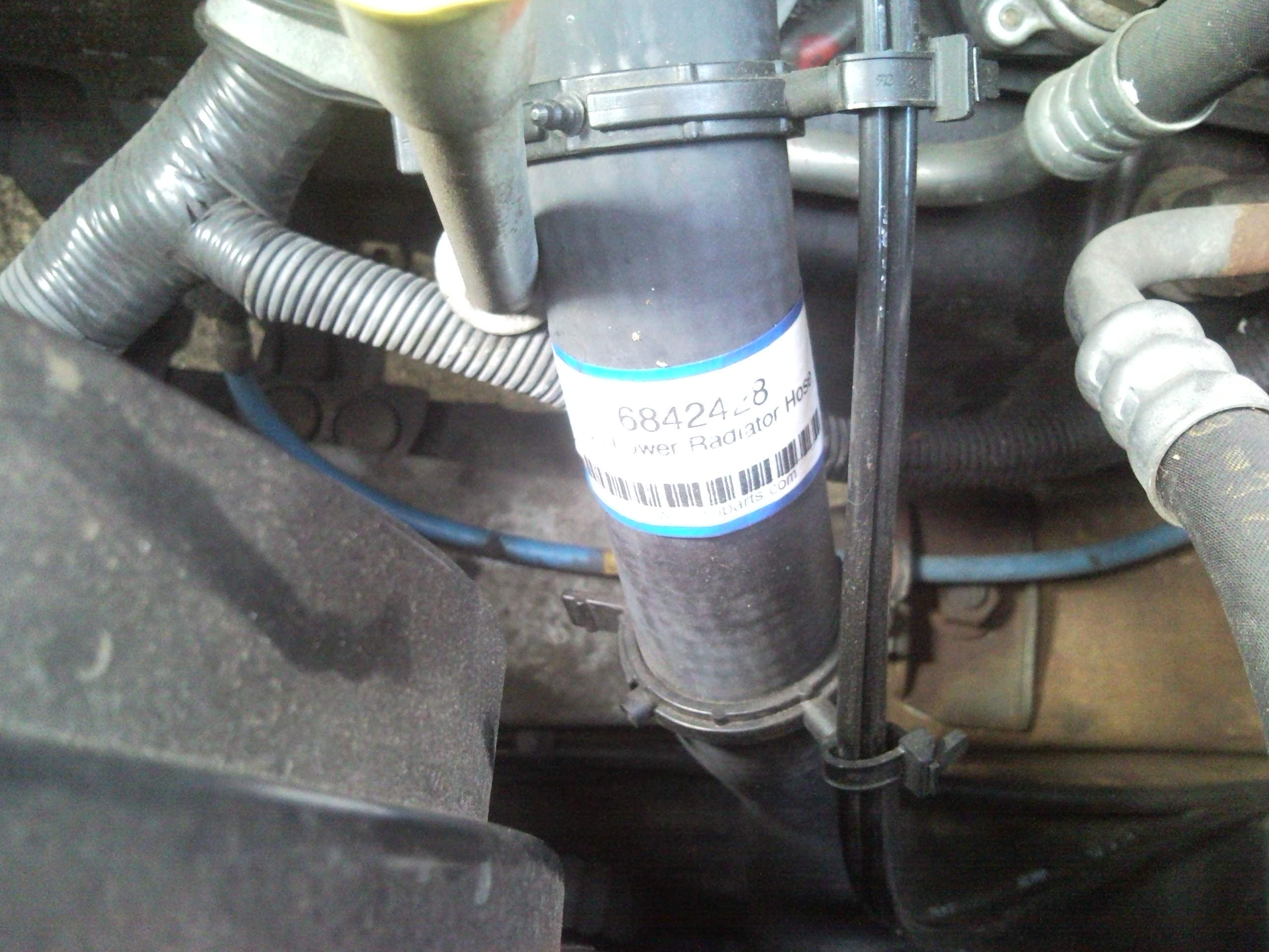

I need some help with the lower radiator hose routing. The photo below shows how I now have it but I'm concerned about the camshaft position sensor connector support bracket (green arrow) pressing against the hose (red arrow). Do I have the bracket mounted to the correct motor stabilizer bolt?
It seems like the wiring harness has a support to keep the hose in position (blue arrow). I think if I loosen the hose clamps at each end I can rotate the hose to make it more to the left in the photo.

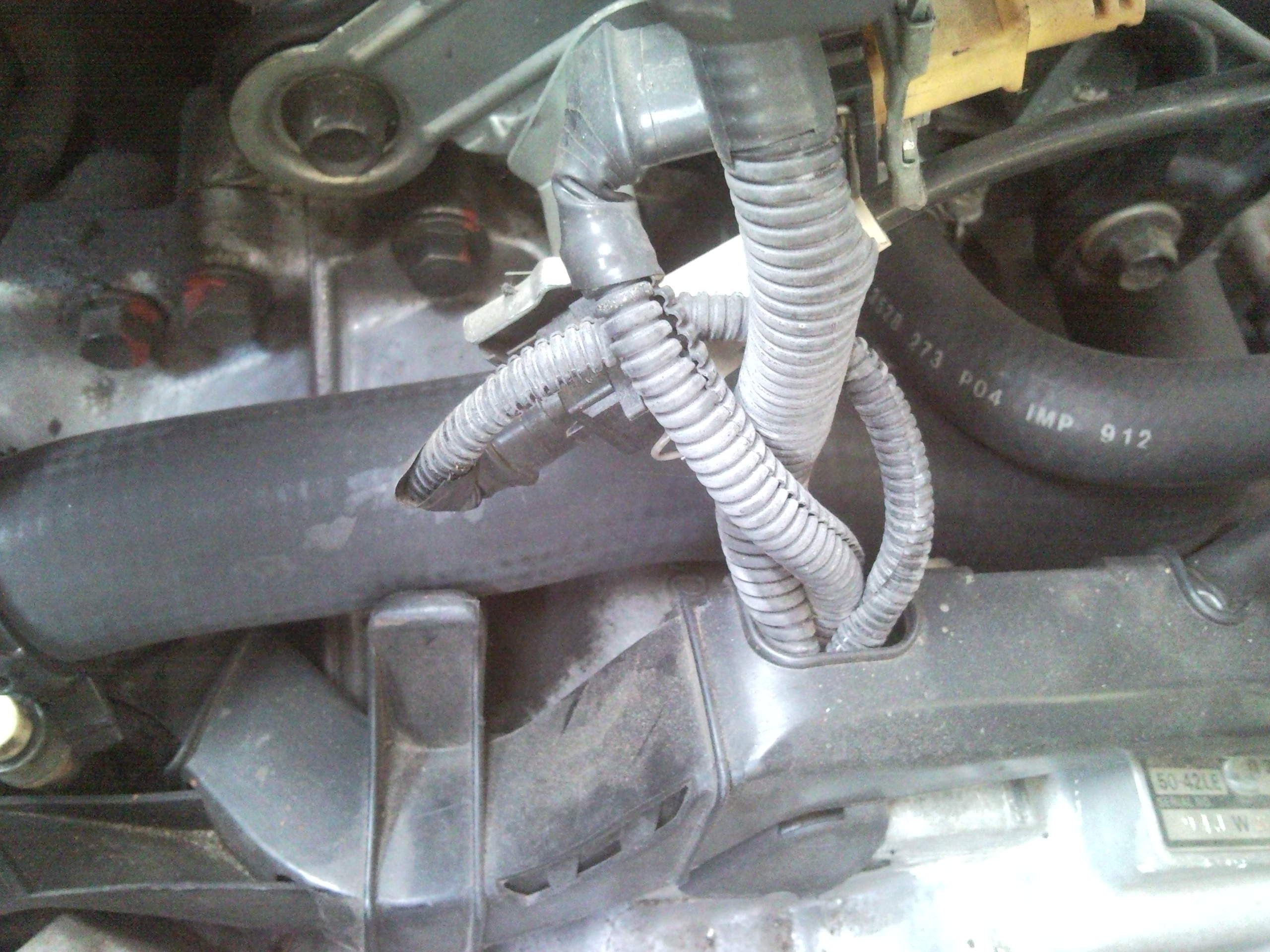

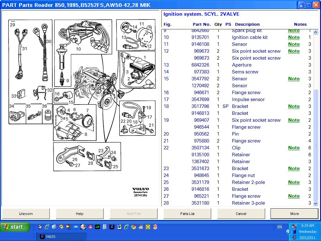

The bracket you have pointed out is the cam sensor/crank sensor connector holding post (for want of a better name) You seem to be missing the other section to this assembly as I can see your cam sensor connector is lying loose. Yours is bent or incorrectly installed as it is not even close ro rhe radiator hose in my car. Straighten it or refit it. (refer photo below)
The lower hose sits inside three open ended plastic clips as in the photo. Vadis could not help me here with a part #. (can anyone help here?)
I've attached a parts breakdown from Vadis for the cam sensor/crank sensor connector holders.
You may have the rest of this assembly lying around in the wagon and just don't recognise them.
Hope this helps. Keep us posted

You're a big help Mike! I learned a lot from the photos you posted. Actually, the white connector goes to the crank sensor (the loose one) and the yellow connector goes to the cam sensor. And you're right, the bracket is bent down from its correct position. I noticed from your photos that I'm missing the plastic radiator hose clamps that guide the wiring. I also noticed that I have a transmission to engine bolt missing. I believe it is in the box of parts. The rest of the support bracket is not in the box.

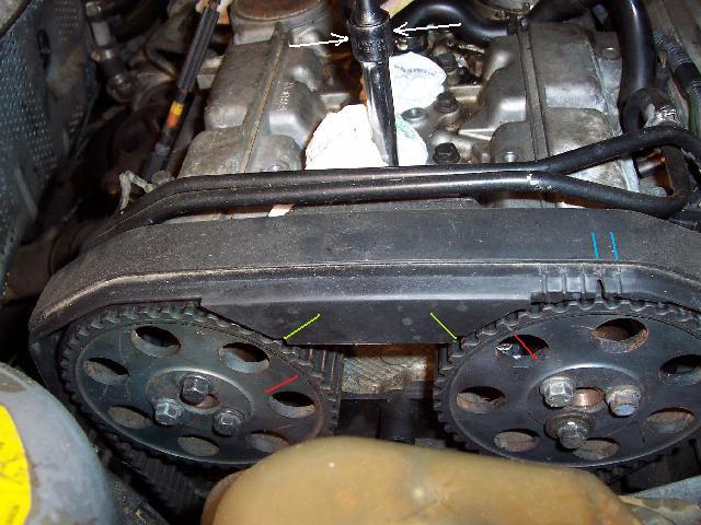

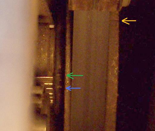

The poor quality photo below is another attempt to identify what I now think is the camshaft timing mark (green arrow).
When the crankshaft locking tool is inserted and the crankshaft rotated counter-clockwise to its limit the mark on the balancer hub aligns with the mark on the oil pump. There is another raised area on the balancer hub (blue arrow) that is about 4 times as wide as the timing mark. The yellow arrow identifies a notch on the perimeter of the balancer that may be associated with the notch and 10 degree marks on the plastic cover.

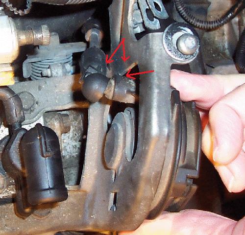

It appears that something in the throttle linkage is bent causing the binding.
The single red arrow marks where the bracket rubs against the linkage. As the throttle opens more the link rises and the side of the link rubs against the bracket. This engine has endured rough treatment since there are several bent brackets.

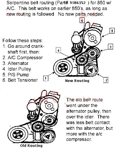

I can't even begin to imagine how difficult it would be to time an engine with the accessory belt tensioner & accessory belt in place.
Pull the tensioner around with a box spanner in the square hole (plumbing type) and insert a nail into the front hole when it lines up with rear hole. Then remove the two 12mm bolts.
I've attached a belt routing diagram in case you get stuck.
