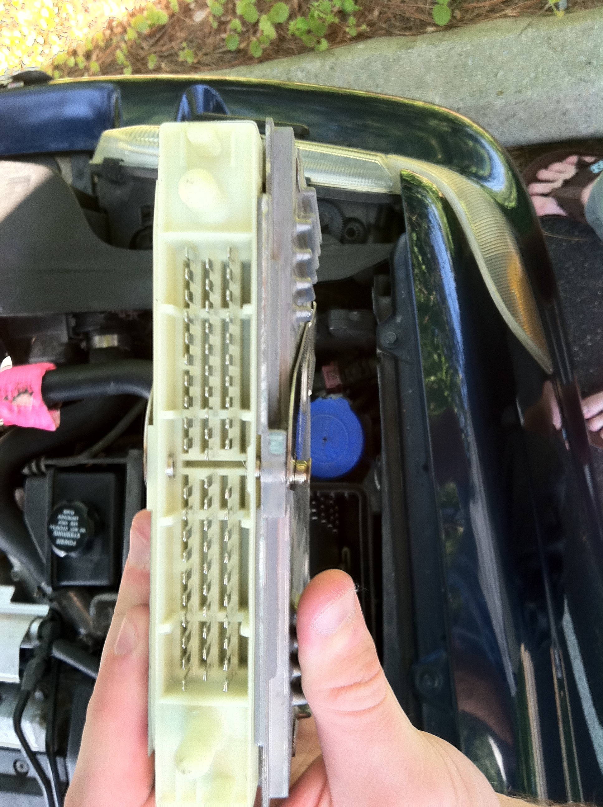

ECU/TCU look brand spanking new. No corrosion on anything. I will bring them in with me tonight to see if I can get in the innards and see if anything is visually wrong, like a blown capacitor/chip or something of the sort.
Now, time to start pulling stuff out of the way to get a look at the wiring to the tranny itself.
I'm really hoping I don't have to drop it out. If it comes to it, I'd probably take the gamble and go in and replace solenoids first - since there was a code for those; im not sure if the codes really mean anything other than its just confused. Maybe 40000 miles ago, it usedta give me trouble where it would just drop out of 4th gear on hot days for no reason, but other than that it has always shifted fine and never slipped/hunted for gears.
