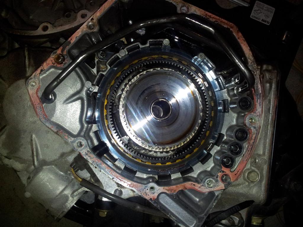

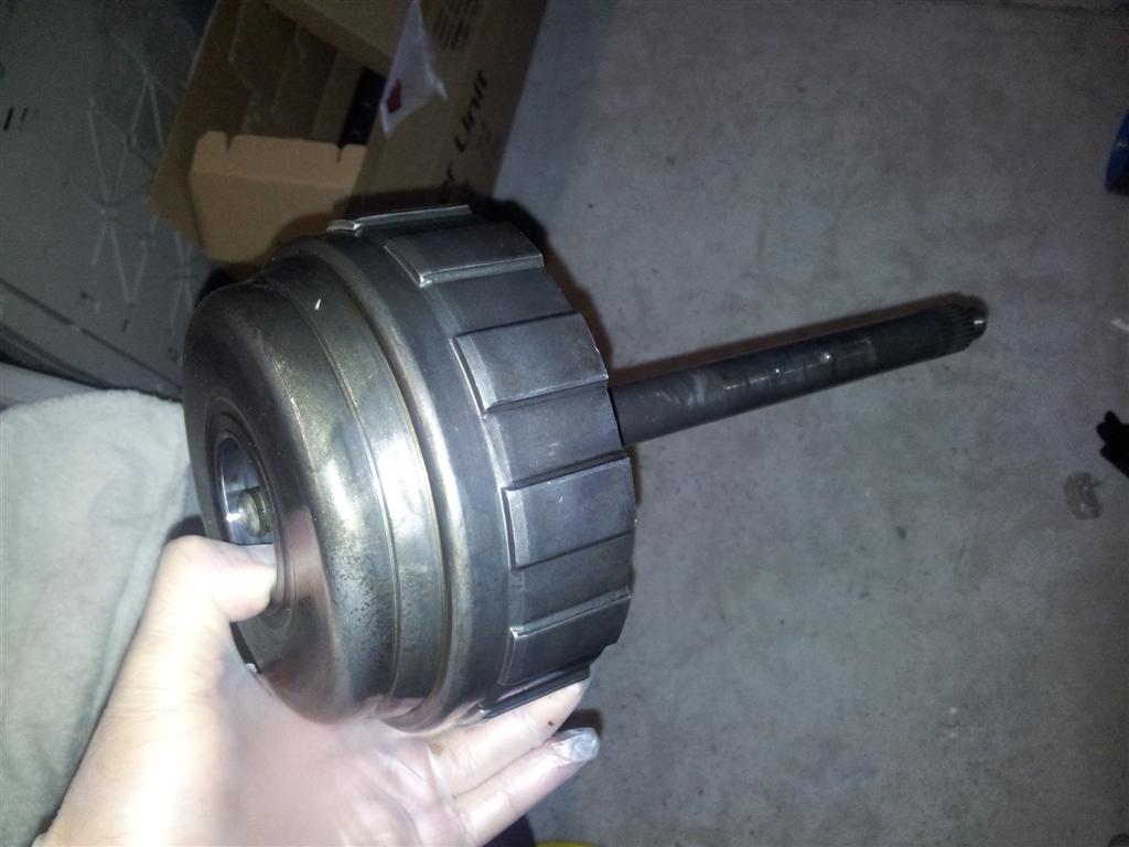

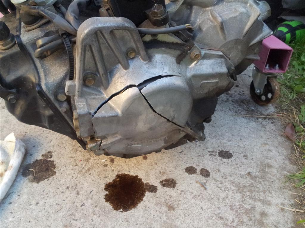

Well today was a mixture of good and bad. The bad was I cracked a gearbox casing and the good is that the gearbox is redeemable with some reassembly.
You may ask: How could one be so careless as to do this and on a near new 68K mile AW-50-42 example??
Well I thought that the easiest way to reassemble the engine gearbox combo was to bolt the torque converter to the engine first, then slowly re-insert the gearbox by slowly torquing up the 10 bolts around the housing.
I was doing up the bolts and found that I was meeting some resistance so I just tightened them more going around in a circular fashion. I thought that I was overcoming the weight of the gearbox, not an incorrectly mated torque converter. The groans and noise I heard was thought to be the spiles mating on the torque converter with the gearbox output shaft.
It may be fixable as the rear of the casing connects directly to the front (small) output shaft. Fortunately all the force exerted went straight to the rear casing and not to rest of the gearbox. I have a spare gearbox from a '99 V70 which I can get the casing from or I can visit my friendly Volvo wrecker for a rear casing from a damaged gearbox. Learned one big lesson today: Always fit the torque converter to the gearbox first, then maneuver that assembly to the engine.
