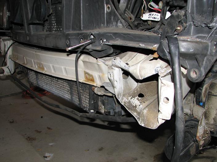

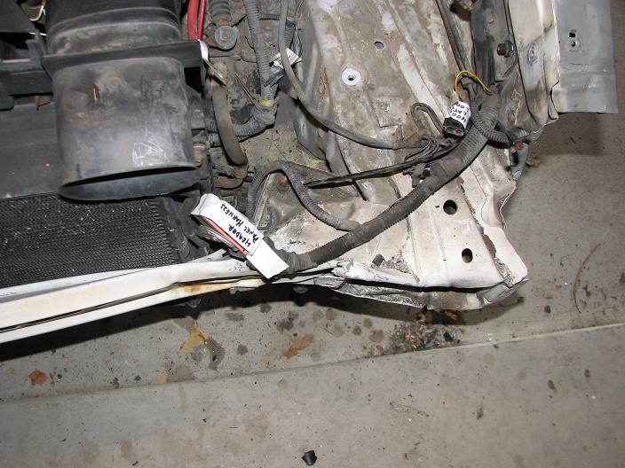

I thought I would update this thread. I have photos on other threads, but I forgot how involved I was with the story on this particular thread.
The car was rescued and revived. It was a project getting it back in order, and pretty much all the advice from everyone was not disregarded. I taught myself a few things along the way. Thanks for looking.

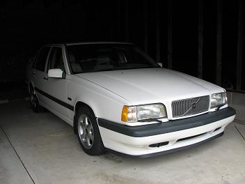

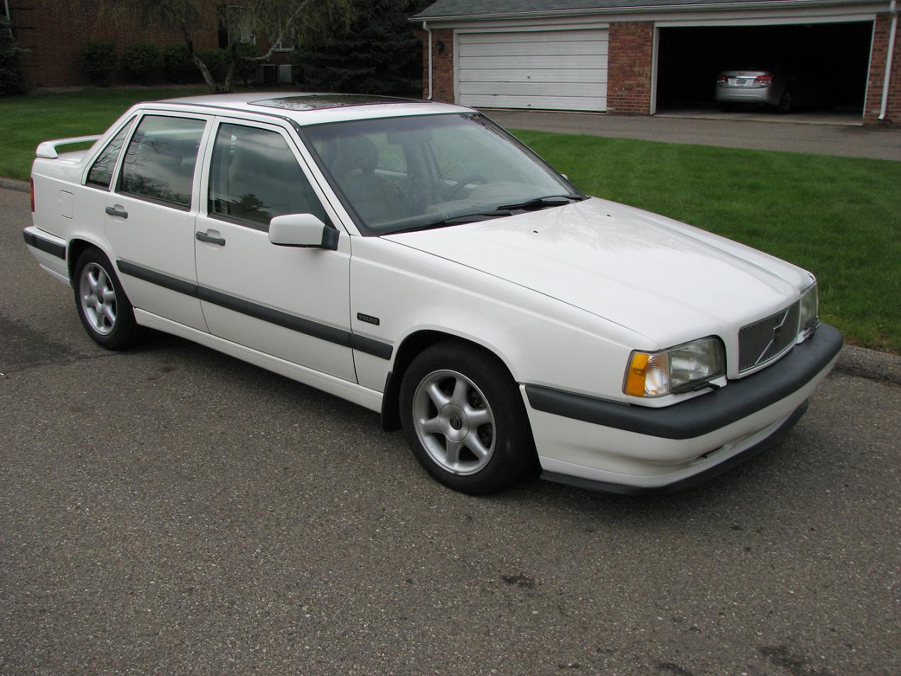

The photos can speak for themselves, but I combined a '96 front bumper with original '93 Alter I headlights and corner lights. I am happy with the look. That takes care of the superficial aspect.

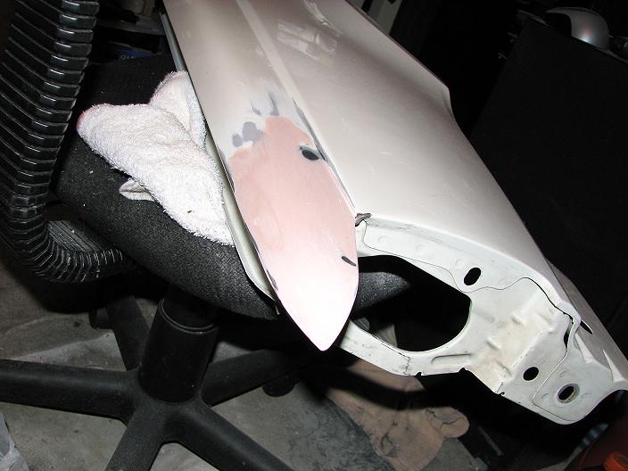

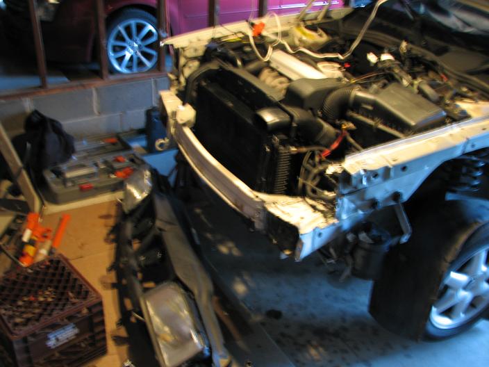

I replaced,
Bumper ( $36.20 Complete '96 reinforcement bar/absorber/top cover/spoiler)
Header panel. ($36.)
Headlight/corner light($60. combined)
Wiper motor/arm/blade - (headlight) (free)
Radiator-(salvaged from '00 v70 with fan/shroud/relays included. $62.00 !!)
Fender- (refurbished one I already had)
Both front seat belts ($7. ea.)
One B-pillar cover (free)
SRS-system ECU (free)

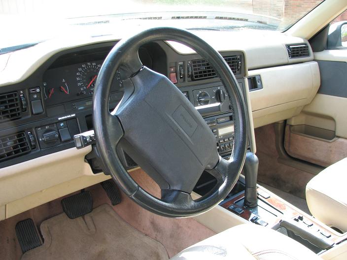

Steering wheel/airbag/clockspring ($40. for all, and upgraded to leather)
Dashpad/airbag ( $36. Airbag included)
Windshield-New ( $223. total-installed)
I also changed the door and fender moldings to the larger Alter II type, to match the new bumper. ($12.00 all six pieces)
The only part I chose new was the windshield, even though I did get one from the junk yard for $30. it had wiper scratches and for $70 more than I was going to pay for installation, I just got a new one.
So do the math. I did spend about $200. on hydraulic tools and rigging parts, but I now own it.
The photos did not upload in chronological order, but I think you can figure it out.
Thanks for the input. It was a learning experience on many levels.

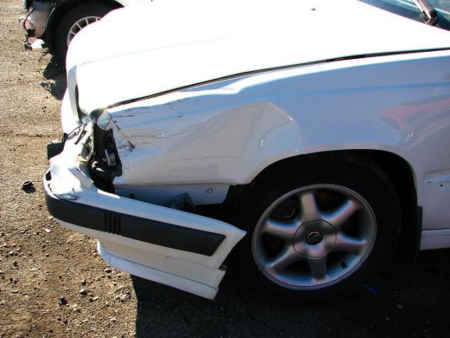

Air bags Deployed-Left front damage

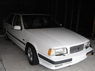

I had $5.00, and some time on my hands this long weekend. So why not?
The grille that I painted is from a spare hood. The one I used for comparison was not hurt in the collision.
The hood that is still on the car is the one from the collision. I will eventually replace it. But for now, the 50-at-50 rule applies. (Fifty feet away, at fifty miles an hour. It looks great.)
Thanks again for looking.
