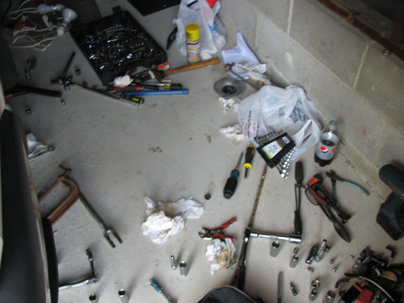

I enjoy the '93 type. they were the first I had known of these cars.
I have seen them at the yards, while wanting to put them on the rest of my '93- '96 vehicles. Timing was unfortunate, either no money on hand, or not enough time. They would be gone by my next visit.
I continue to search them. They may be taken for $15 a piece.
After not owning a way to press bushings carefully, I had taken mine to a local parts place, it was $35. per arm for the two bushings.
I was fine with that. (Still am) which leaves another choice of what you care to spend on the ball joint.
I had thought they would always be done this way. My early Chevy bushings needed to be pressed. The bolt on ball joint seemed very cool.

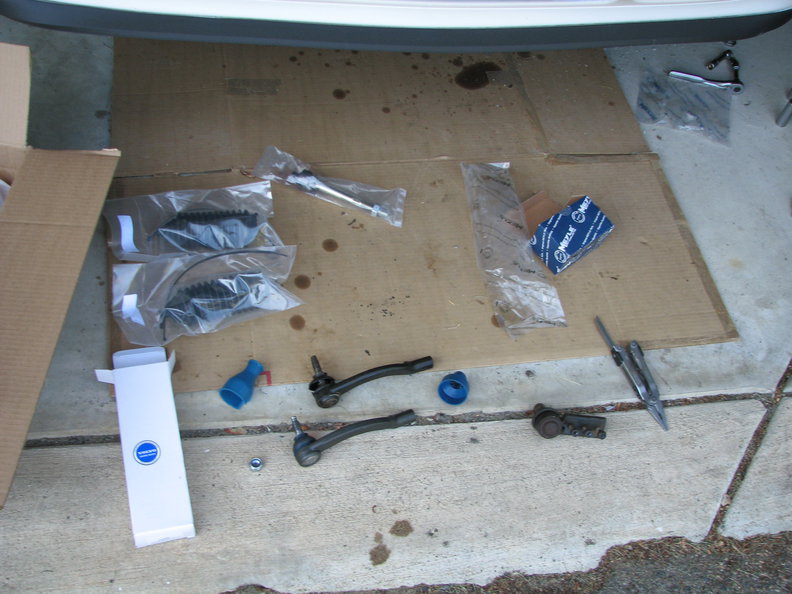

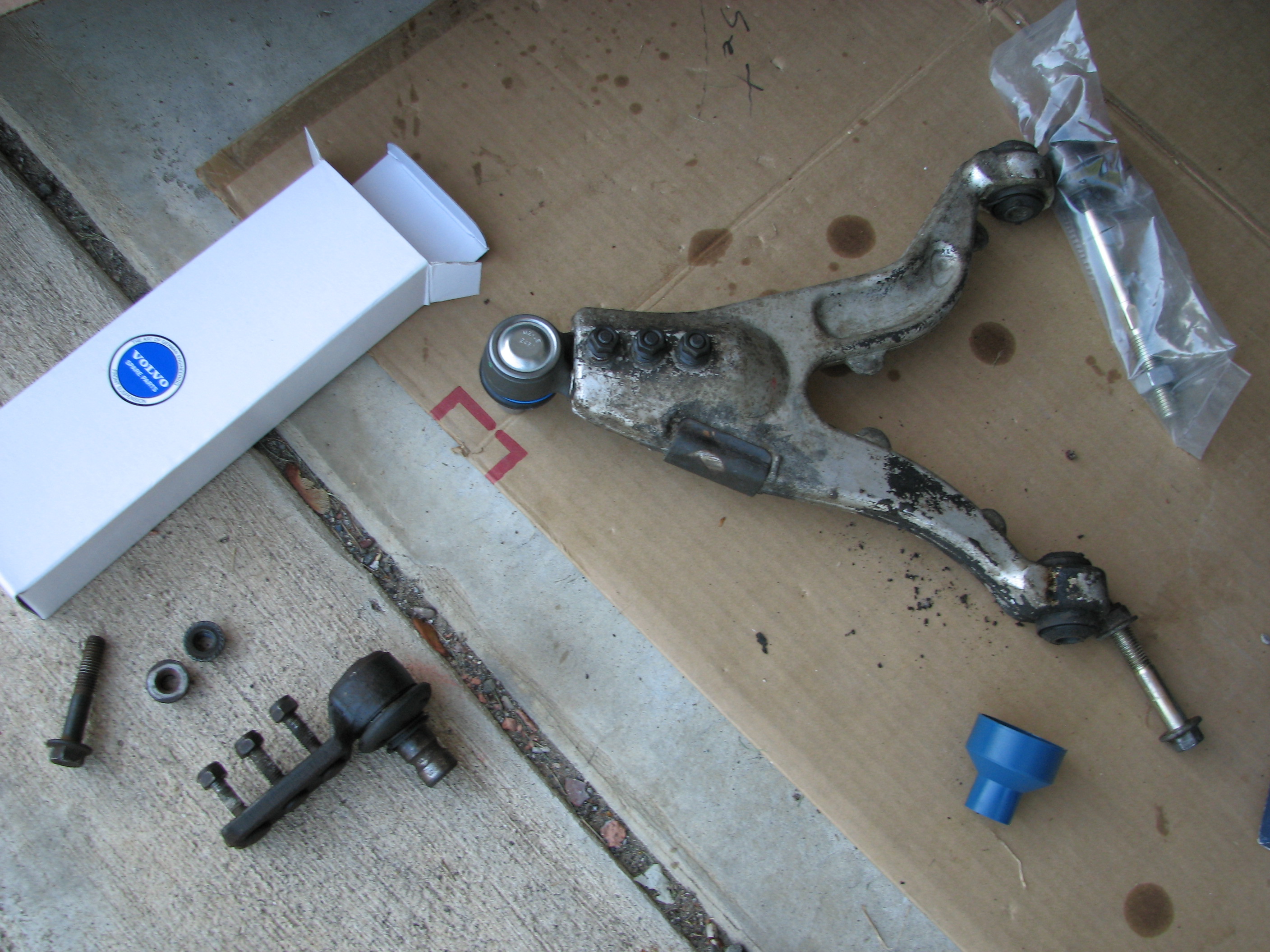

My first.
My first.
At this point, I had used the Meyle ball joint and tie rod ends.

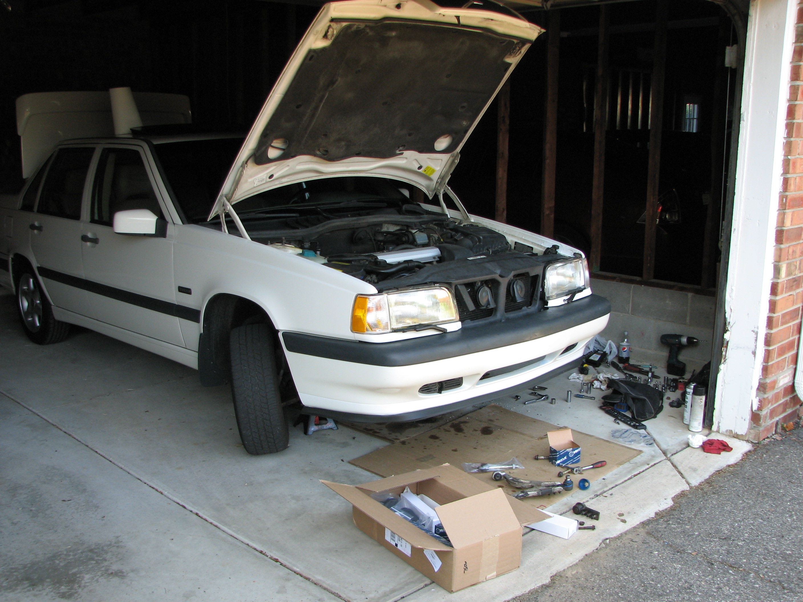

Needed the car the next day, so duplicated the other side a couple days later.
I had no pictures of the other side. I had no garage @108 degrees. Michigan that summer.
Choices are nice. The aluminum control arms are nice, I now can press my own bushings, very nice.
