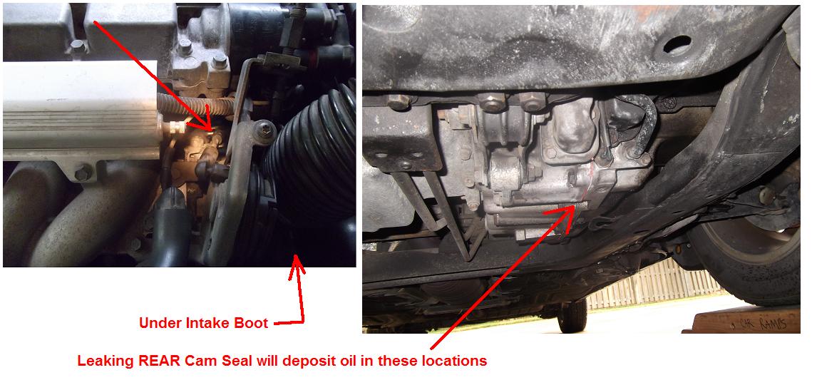

2001 V70XC with 141k-mi shows fluid at the bottom of engine at transmission housing as the photo indicates. I will look pass the air-intake tube and vacuum lines to locate the housing for the rear-exhaust cam seal.cn90 wrote:I forgot to mention that if you have a leak from the REAR Cam Seals, you will find out at these locations:
- At the 2 small hoses feeding the PCV system (directly under the cap/rotor area).
- Oil will pool down below the Intake Boot.
- Oil will be found under the Transmission Housing.
Meanwhile, this is a single VVT engine hence only rear-exhaust cam seal, rear-intake is capped. Therefore I ask... Would the core of the procedure be any different than this DIY?

Had to laugh when I read this, because mine blew on a trip from Maryland to Texas. Oil pooled on the tranny housing...on the cat...on the undercarriage...on the back bumper...on the back window...and on the windshield of the van I was following in. the only places it didn't pool was in the engine and the driveshaft (it's on a shelf in the garage).- Oil will pool down below the Intake Boot.
