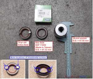

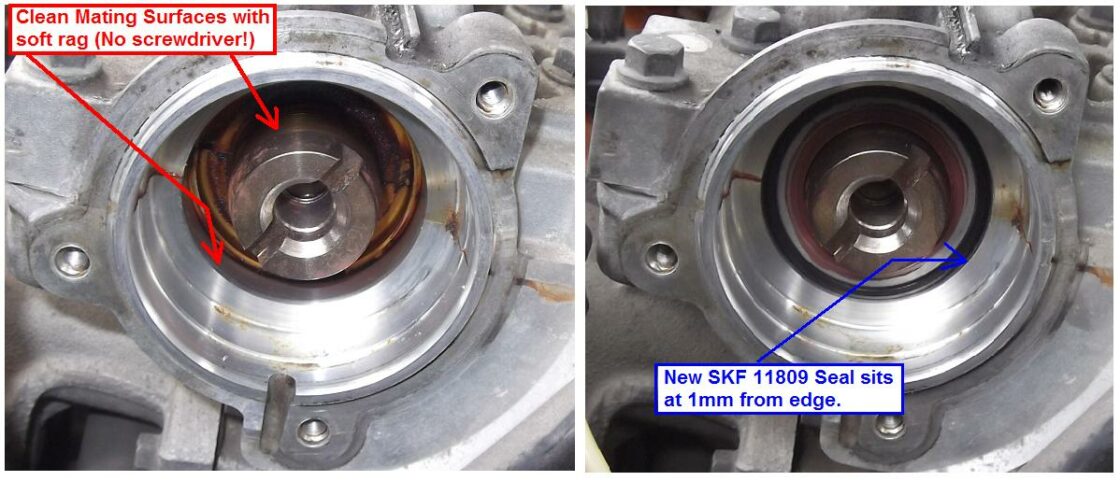

There are a few DIYs for REAR Cam Seals but sometimes little tricks (i.e. ow to mark and how to remove seals) are not mentioned.
I just installed the SKF Rear Cam seals using SKF 11809. In every respect, it looks identical to the Volvo seal.
I bought the SKF 11809 Seals from local SKF dealer (semi-truck parts dealer): $6.50/each = $13.00 total. NAPA autoparts also sells this SKF 11809 seal for $9.50/each, make sure you ask specifically for this seal. Anything other brand, you will be a guinea pig. Local Volvo dealer wanted $33/each!!!
