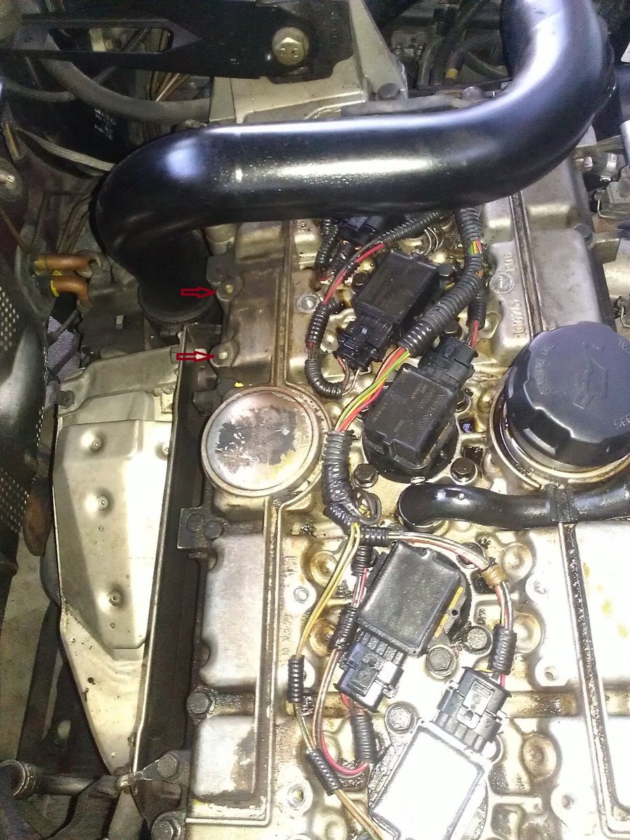

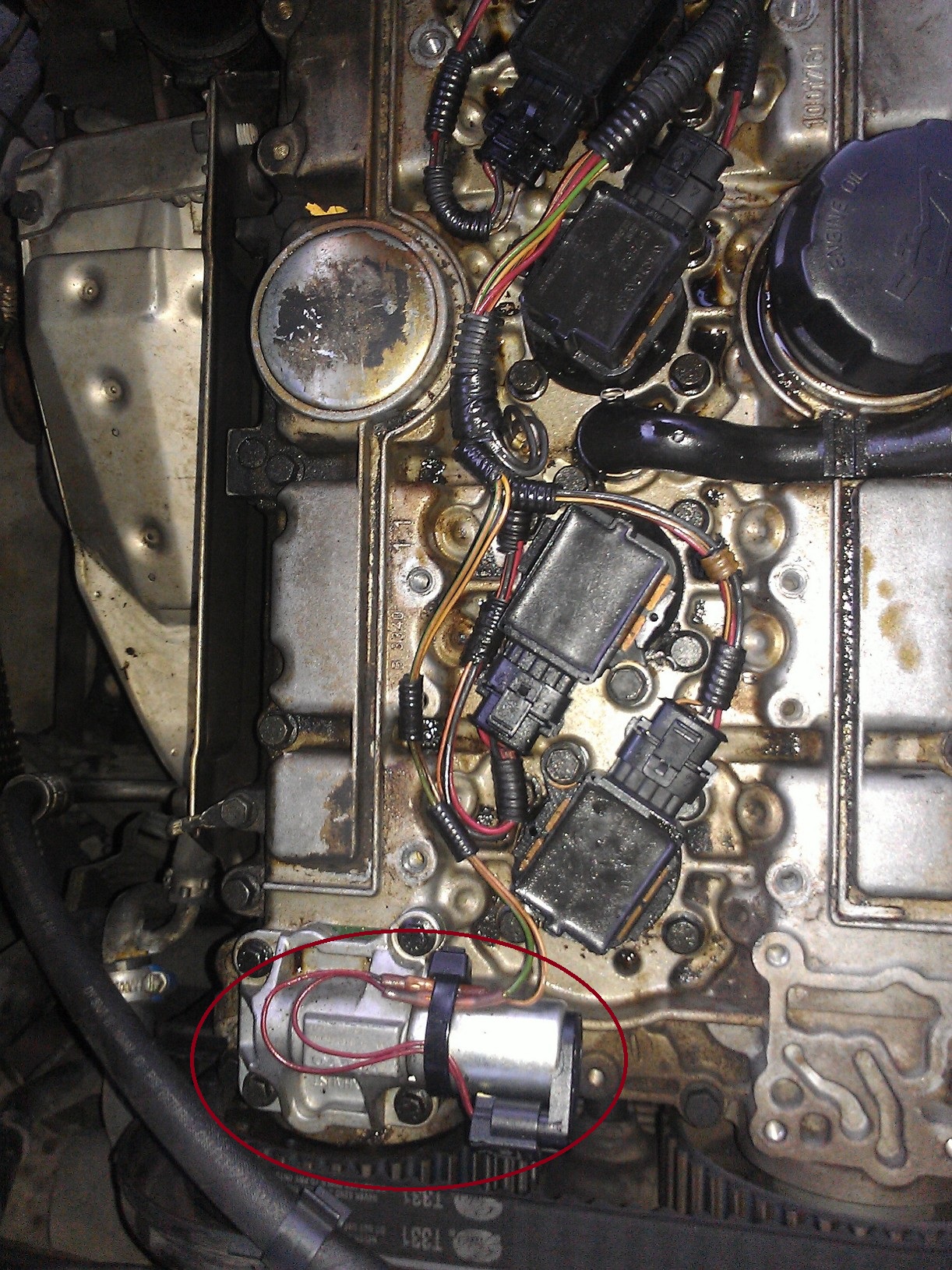

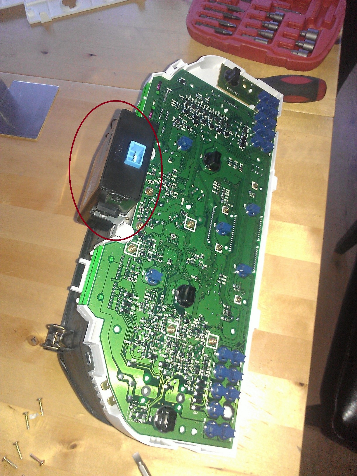

I have a couple questions about a few things in the vehicle that I could use some identification help with. 3 pictures for your review. I'm just more curios about what these things are than concerned about them.
This appears to be some type of electrical motor or sensor. plugged in on the exhaust side of the engine underneath the spark plug cover.
And finally, what is this module on top of the instrument cluster?
What are these 2 screw holes for? They are outside of the spark plug cover on the rear of the engine near the turbo pipe.

This first one looks like a cam phaser for the VVT, which I assume this year has. Exhaust only perhaps?
Is the connector on the top of the cluster 3 or 4 pins? I bet that it is shown on the electrical diagrams, and knowing the number of pins would make IDing it easier.
I don't know what the top holes are for. My 94 doesn't have them, and my head casting does not have blank bosses in place.

The connector on top of the custer has 4 pins, I should have taken some additional pictures of it from other angles. It simply mounts to the top of the instrument cluster, but doesn't have any direct connections to the cluster.
