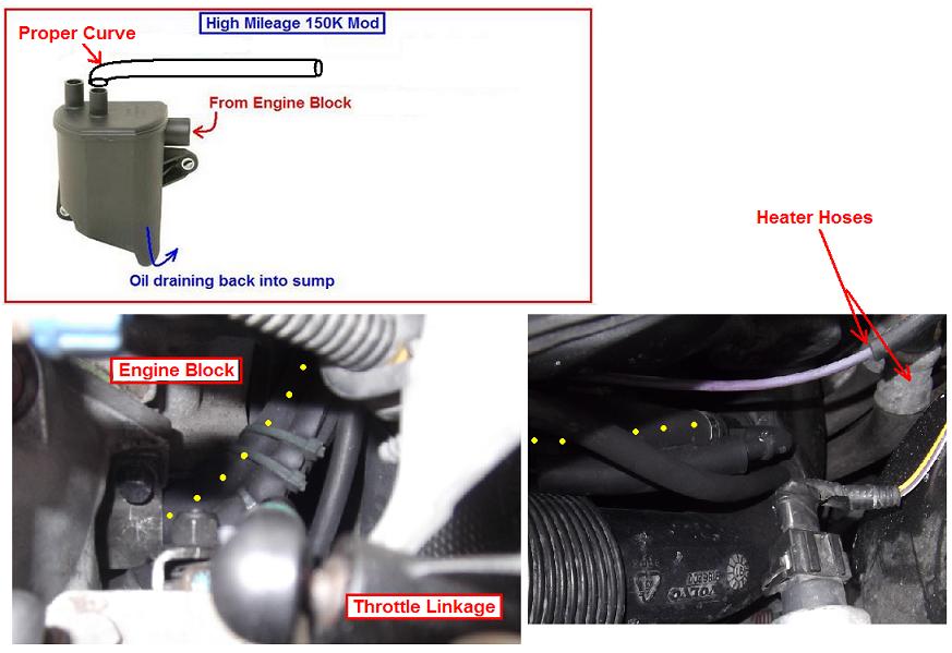

Update,
About 1,000 miles later and no smoking dipstick.
Some people have emailed me worrying about 5/8" hose can kink causing blockage.
Legitimate concern but if you pay attention to ensure proper curvature of the 5/8" hose throughout, you will be fine.
- At Oil Trap: ensure no excess hose or too much pulling, simply build a curve with 90 degrees.
- At Engine Block near the Throttle Linkage area: nice gentle curve (see yellow dots).
- At PTC area, again nice curve (see yellow dots).
See photo:
