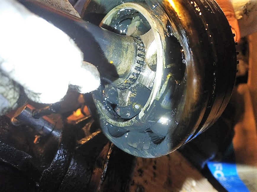

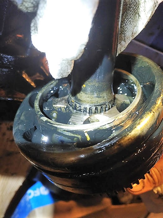

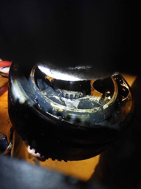

Dead thread revival - I'm baffled about this on my V70's axles. 99 T5 manual, which seems relevant because there are some changes between years, engines, and transmissions, though I seem to share most in common with erikv11's 850, which, if it's one of the ones in his signature, is an older NA car. As in his case, there are no apparent circlips on the inner race of the outer CV joint, but something is holding it on and it's not clear to me what.
I've got my boot off but can't get the CV apart (pictures below). I gave it a few pretty good whacks through a drift and now it'll slide in and out by ~1/8" easily, but it's catching on something. I'm afraid I've damaged it and I've definitely put some chips of wood in it, so I must disassemble this joint and clean/inspect it before I'm confident repacking, re-booting, and reinstalling.
Based on the first few responses in the thread it sounds like:
- there is some version of this axle on which there is an accessible circlip in the outer joint (pictured in Misha's post, cn90's thread, and the Volvospeed post cn90 links in that thread)
- there is some version that does not have an accessible clip but just takes some vigorous whacking to remove (referenced in mikealder's post, and apparently what erikv11 has)
- there is some procedure for one or another of these axles - not clear which - that involves hitting the inner race, possibly extremely hard, and then rotating the axle. At the very least the orientation is important.
Can someone who's done this explain how these pieces of information fit together? Pictured is my axle. The circular cutout for circlip access is absolutely, positively not present, so i have the second version referenced above.

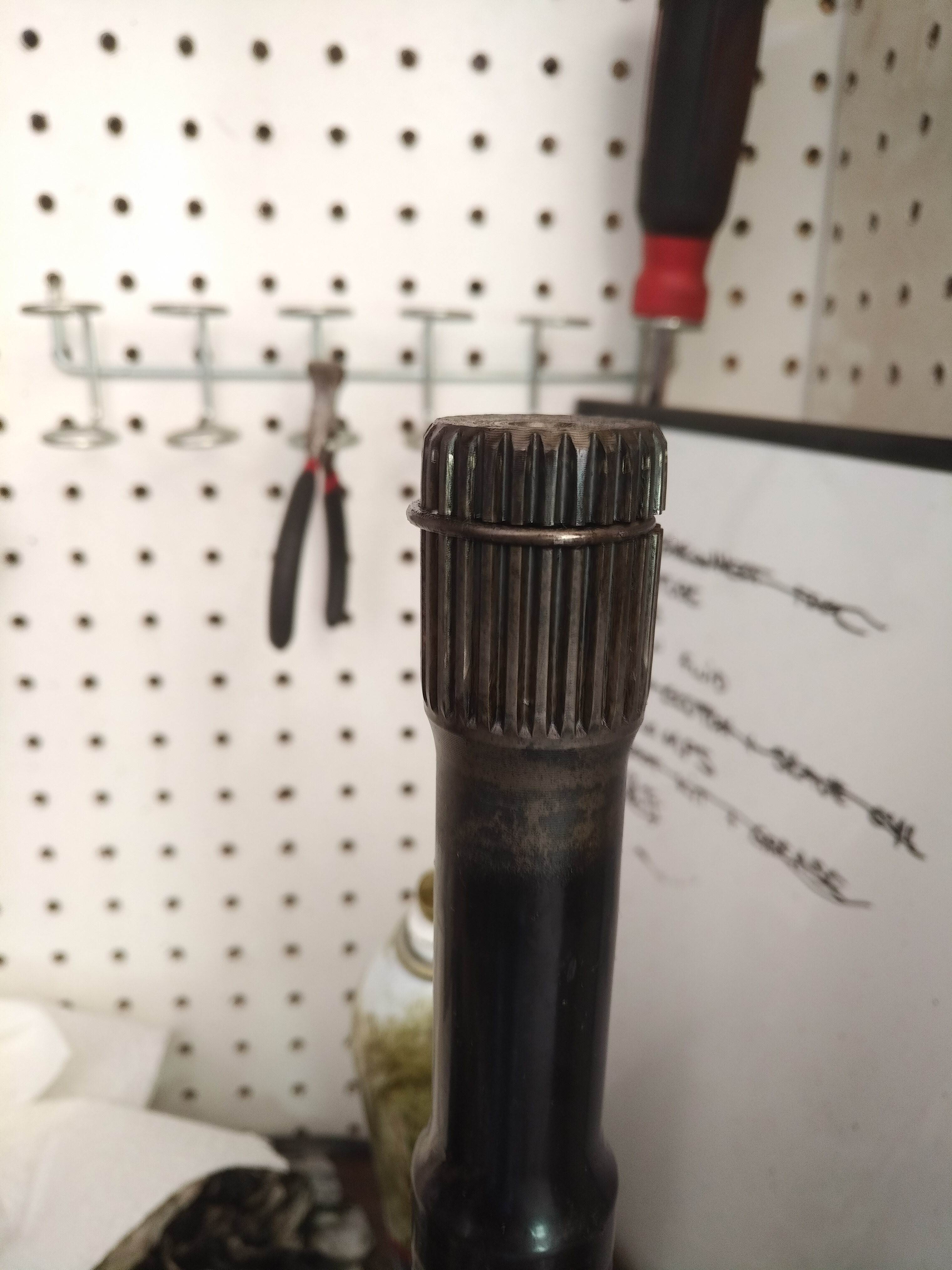

Update: yeah, just hammer it. Here's the circlip holding that CV joint together. It's entirely contained within the inner race of the outer CV joint, and there no access hole for it. Nothing to do but whack the race until the ring squishes in and let's the CV slide.
It didn't take a ton of force. I used a 1 lb sledge and a drift of 3/8" round aluminum stock. A few good whacks - I am not a big guy, and it did not take all my strength, but they were sharp blows - popped the race off the ring, whereafter I could pull the CV joint off by hand.
