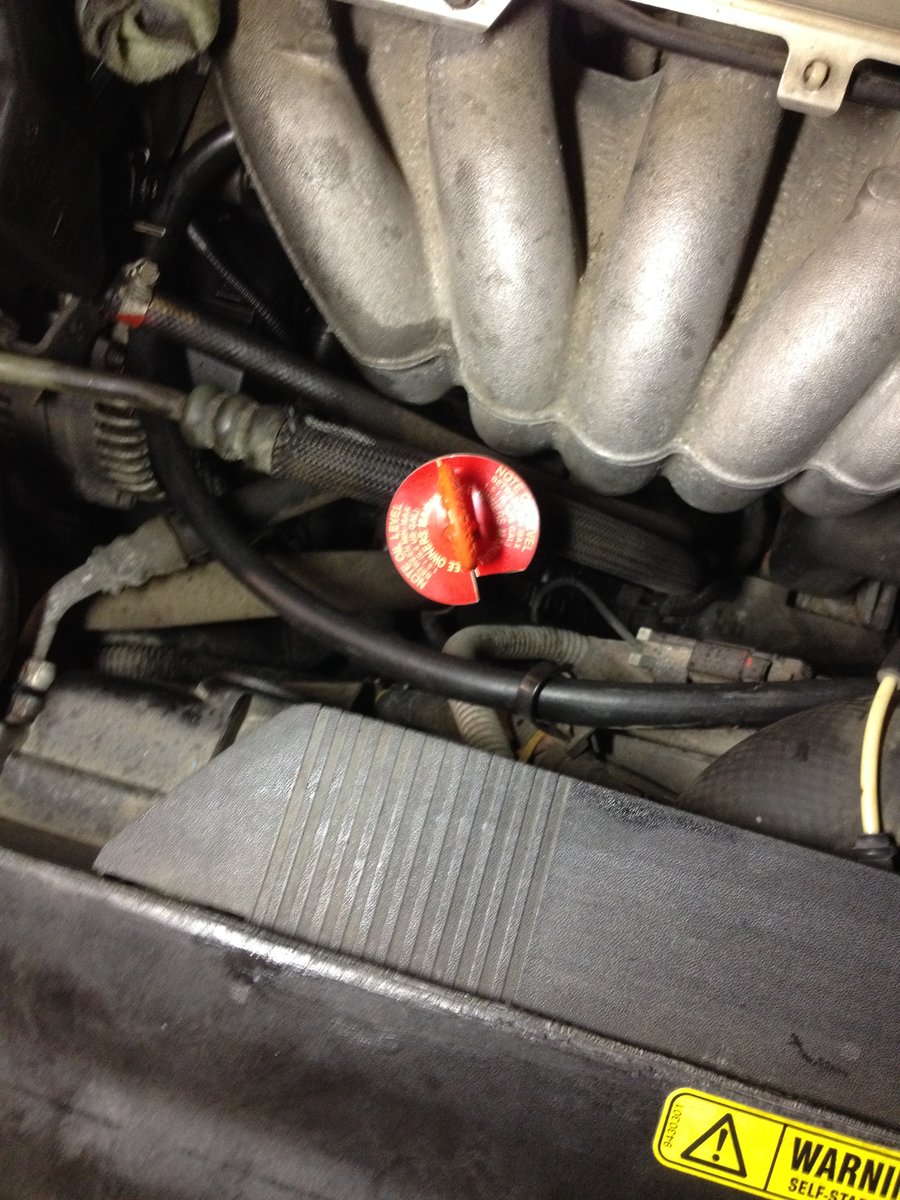

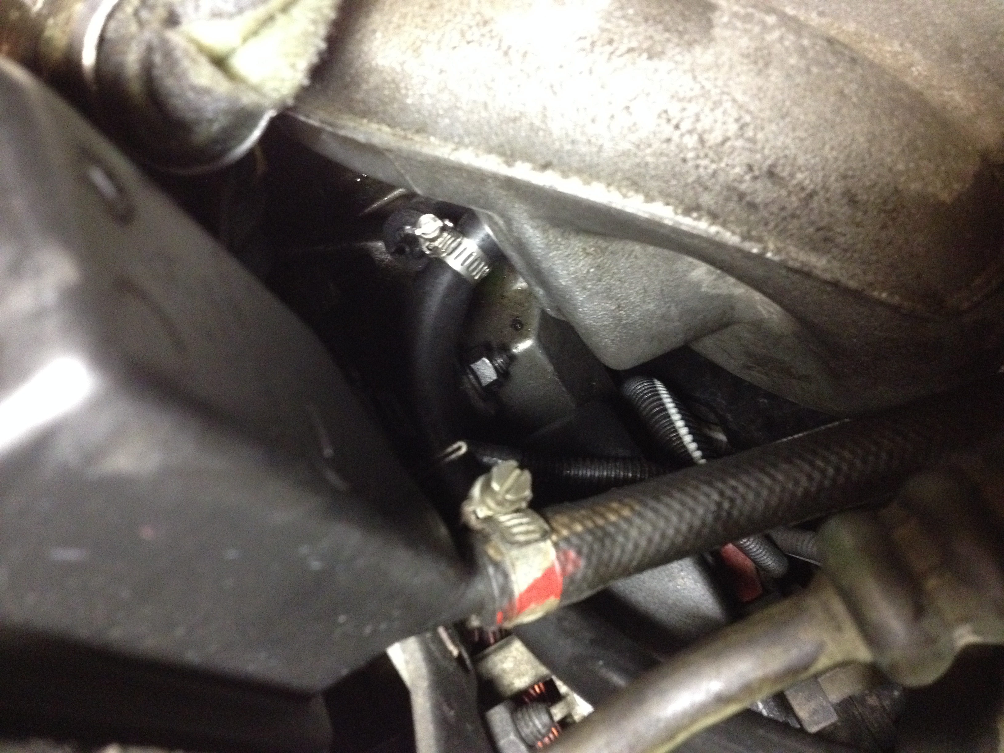

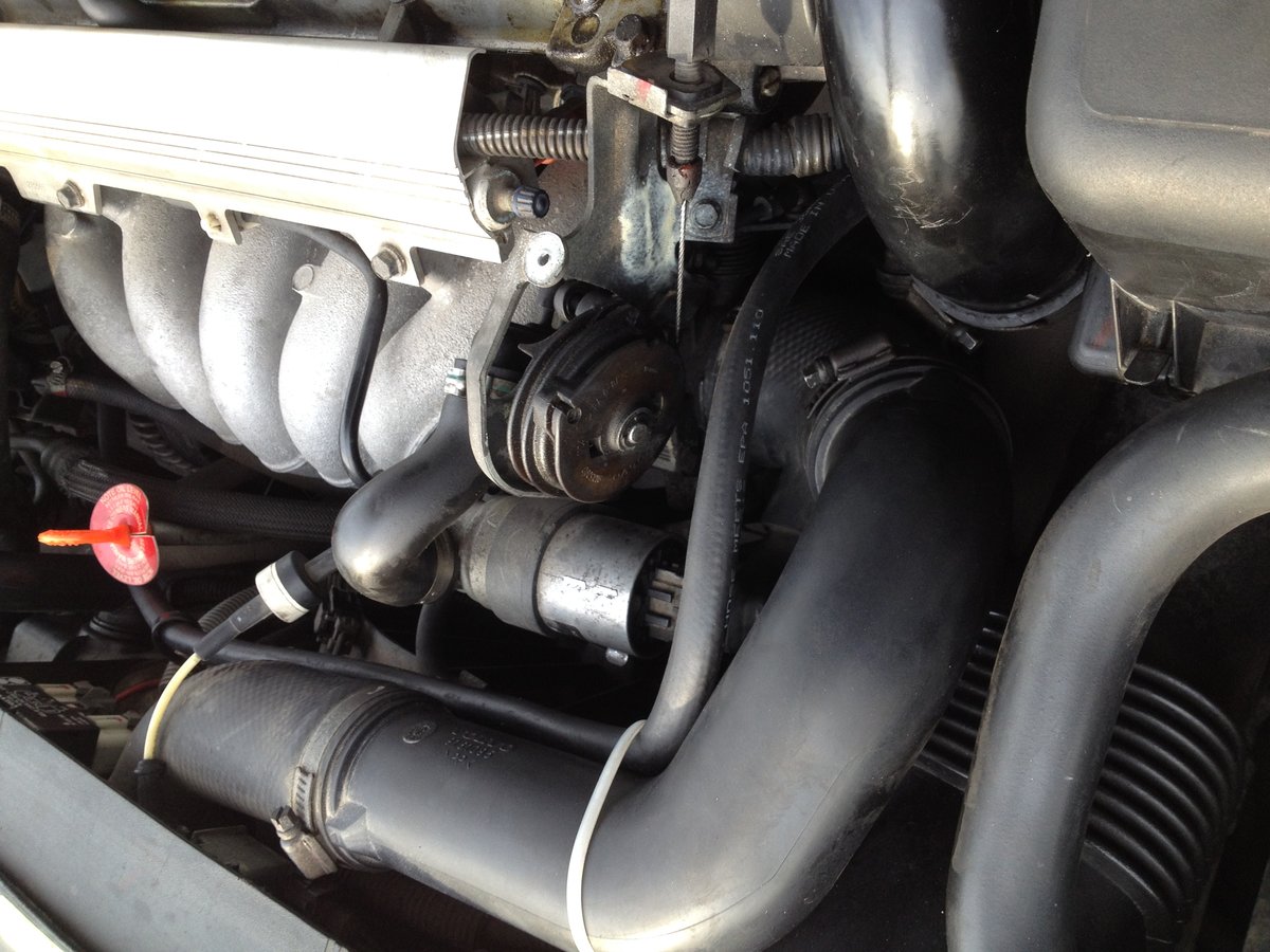

I tackled this problem last night, I had a bad feeling it would be a bitch and I was right; even though it looks easy.
First thing I did was remove the upper radiator hose to get access to the elbow. I was able to remove the elbow with a angled needle nose pliers on the manifold side. The other end of the elbow was stuck to the hose. I hosed it down with Liquid Wrench and after about 20 mins of trying to pull it off it finally came apart slowly in pieces because it was so brittle.
I tried installing the new elbow; well there was a lot of swear words. I felt like punching the sweedish engineer who designed this hose system. Getting the elbow onto the intake manifold was a bit tricky but I was able to do it. Getting the other end of the elbow onto the hose is virtually impossible because it is a tight fit and you need to find a way to hold the hose and push against it. Good luck, there is no room. Maybe with two people, but I'm doubtful.

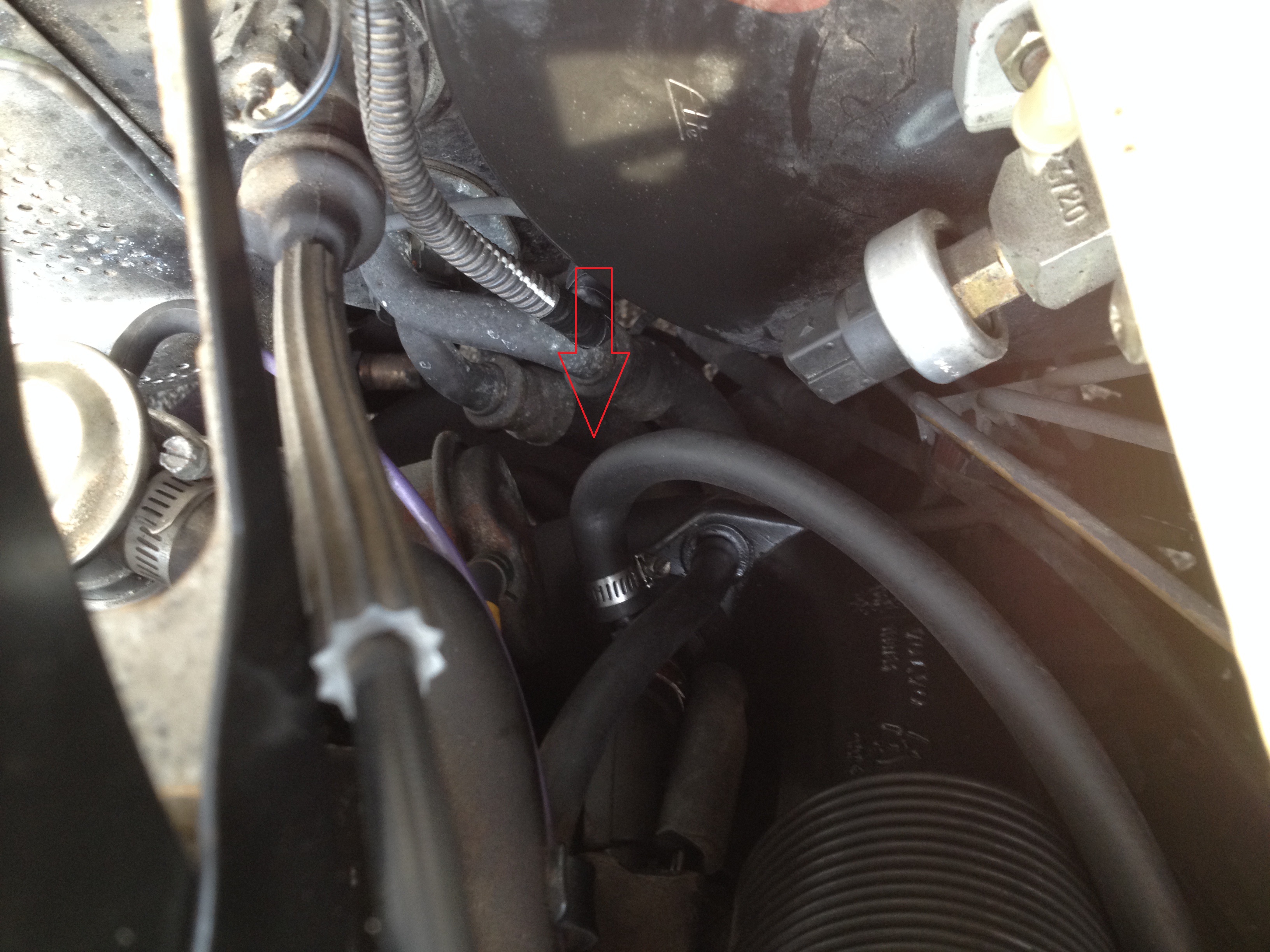

So I caved and ran a new line to the PTC valve. I'm not 100% sure I connected it to the right port but I believe I followed the line correctly (not easy to do because it is hidden).
Does this appear correct, see Red arrow.
