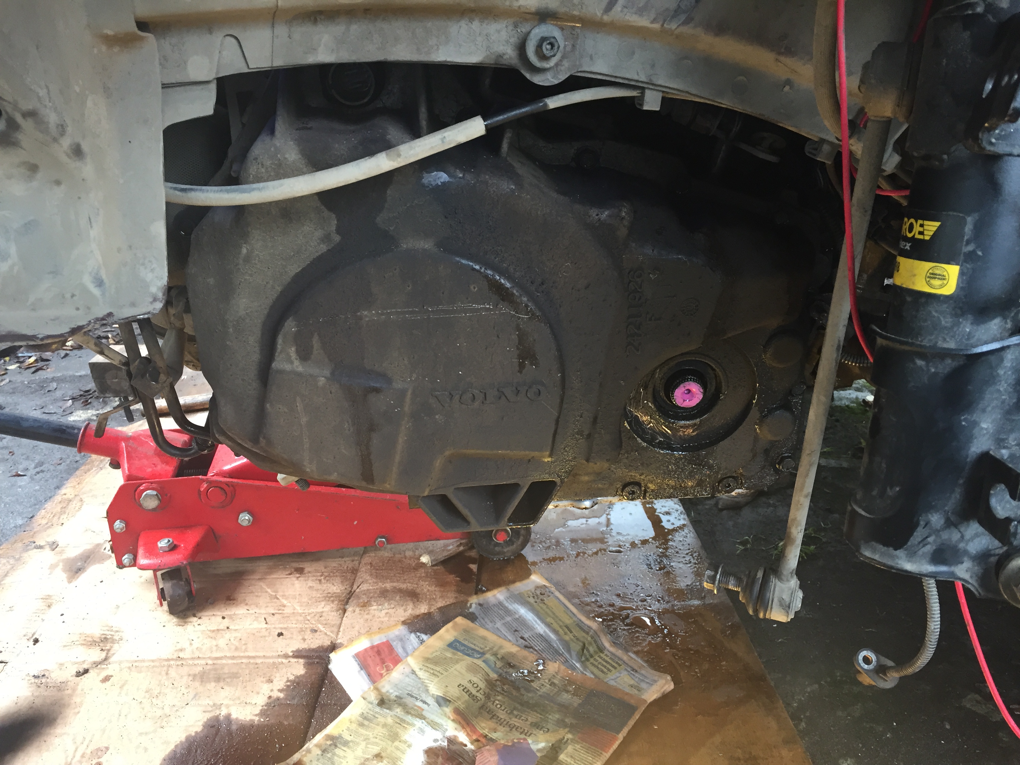

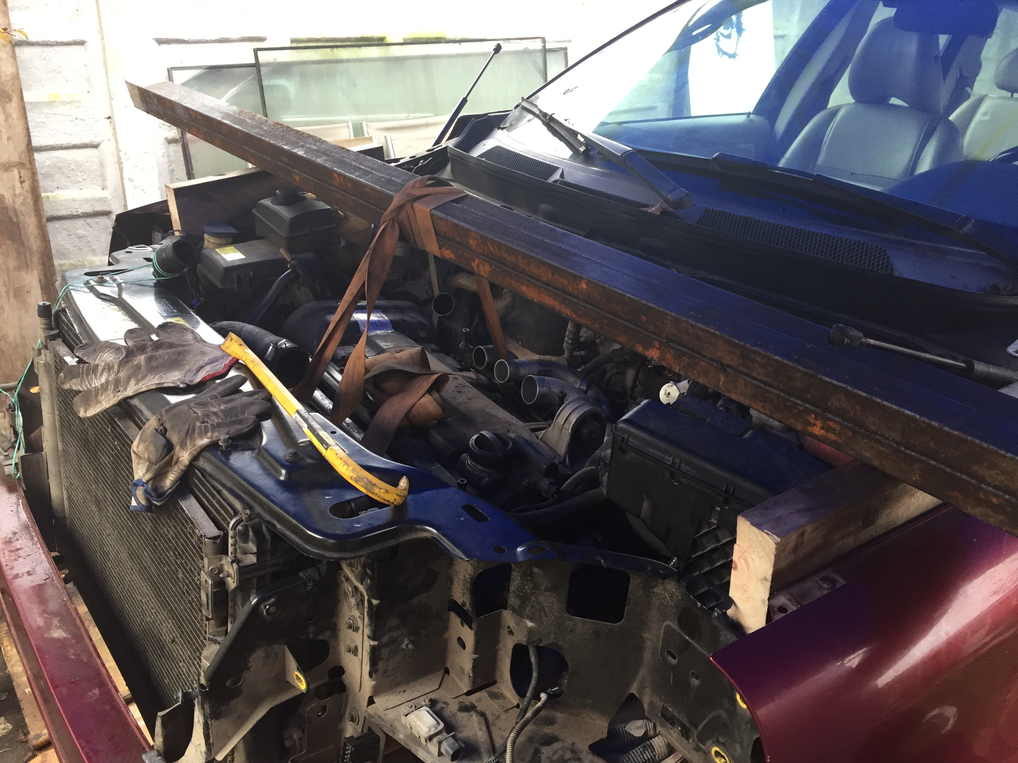

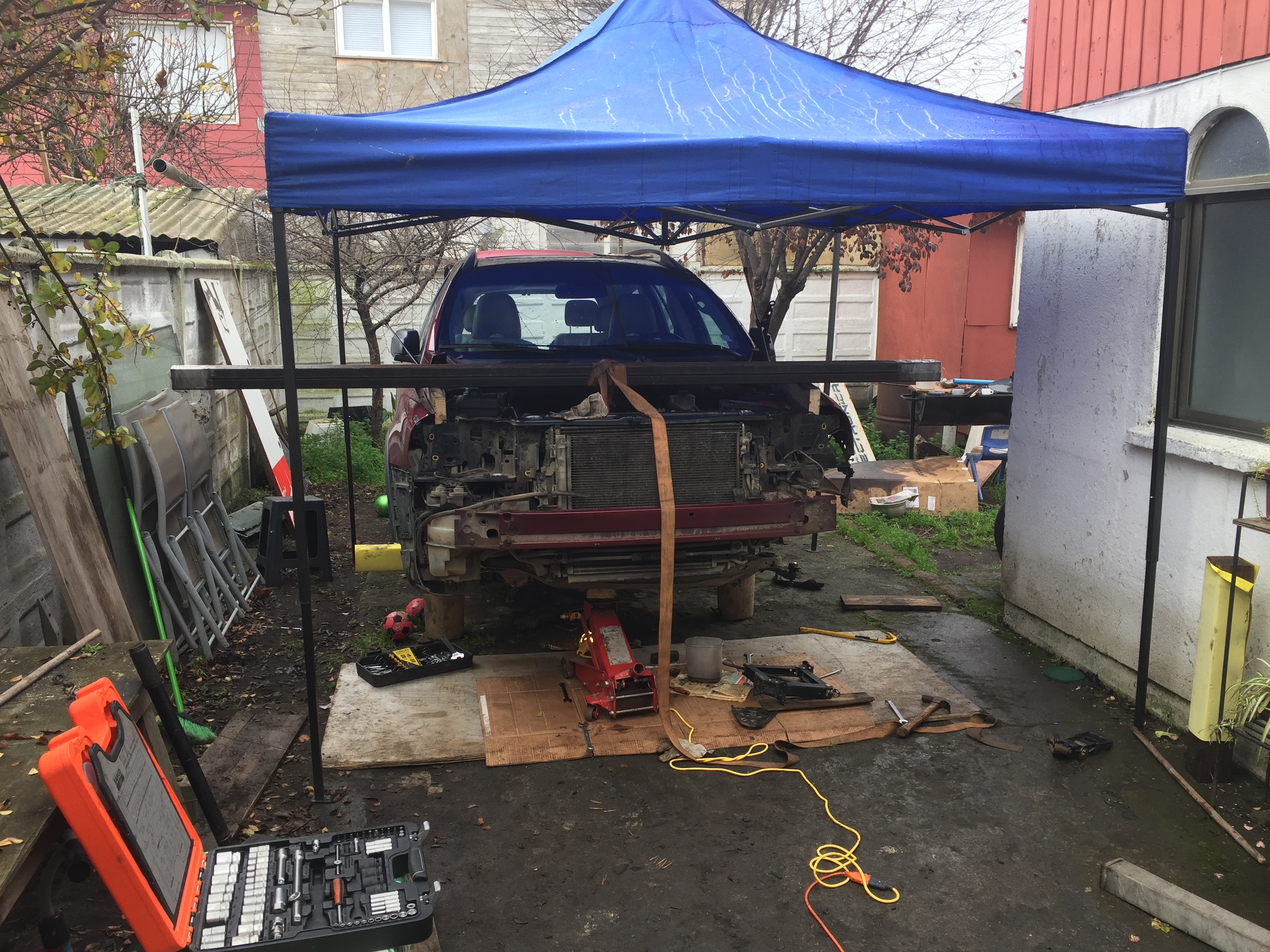

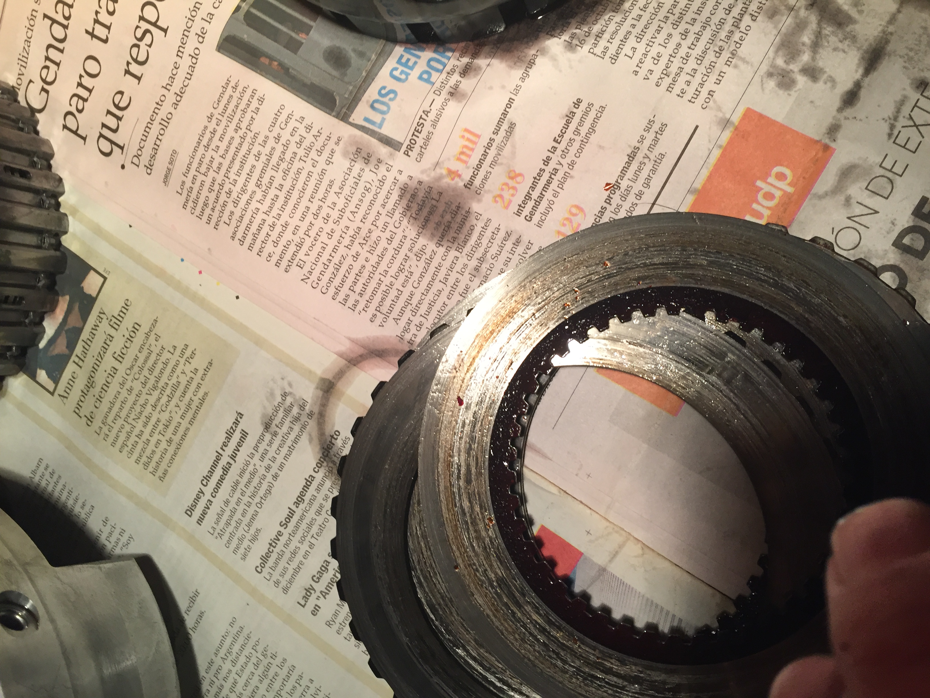

I'm doing this clutch change on my 2006 xc90 and obiously this post was a HUGE inspiration to do it. so thanks to OLY
I'm already changed the friction and steel plates of the 2nd and 3rd clutch and I'm hoping to start to reassembly it this weekend
just for reference we take off al the subframe just because in XC90 the gearbok must be far down to work on it than in a S80
I'll post some photos just for reference, and yes, those who looks like steel plates are in real friction plates all worn out, I'll pneding on this post if someone wants more information or pics.
