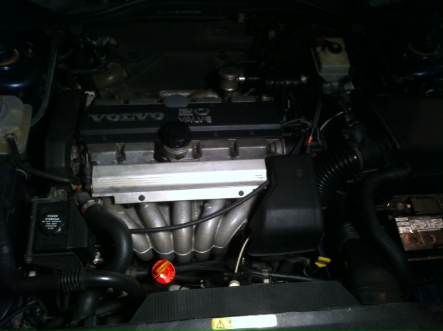

Gentleman. We have a FIX.
Symptoms were....
Strong fumes in car.
The dreaded Smoking Dipstick
P0172 code as well as a few others that may not be related. (Cat and Fuel press.)
Found rotted vacuum hose on pass side of manifold. Then discovered that both hoses were disconnected from the firetrap.
Remedy. With the help of Erik and others on this post, I began the task of running a new vacuum line over the top of the manifold rather than underneath which is impossible without major work at which point I would just do a full service on the PCV. I then found that both lines into the firetrap were totally disconnected on top of the vacuum line on the pass side of the manifold. I left the old vacuum line there as I know I will get it once I do a full PCV service. While I had things opened up, I cleaned the throttle body a bit. It was actually pretty clean. I also cleaned out the firetrap. My mass airflow looks pretty clean also. I followed Erik's directions and ran the new line over the top as well as attaching the other hose to the firetrap. This has fixed the issues with the fumes in the cabin as well as the smoking dipstick!
I have also ordered a Volvo fuel cap as this car has an aftermarket cap and one of the codes indicated that it may be an issue. I will check my codes tomorrow, but feel as though this has solved my issues.
Bottom line. $7 on some vacuum hose and $2 on a clamp combined with about 2 hours of labor and some help from the boys on the Forum!! Bring this car into a garage and I guarantee you are not getting out for under $300 for the same job. Thank You. I will post a few pics.
