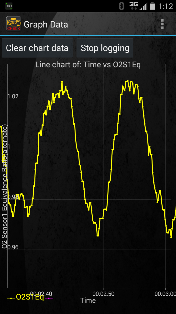

Here are 2 snapshots of front and rear o2 sensors. Looking at the time scale I count about 10 sec for sensor 1 and 12 for sensor 2, which is complying with the 2 sec rule that sensor 2 switches less than 1. That tells me the cat does it's job. Engine load was about 25% at 50mph steady to indicate cat flow. Hope this helps.

quietcoolone
- Posts: 61
- Joined: 24 Aug 2013, 07:54
- Year and Model: 04 S60 ,02 S60/V70
- Location: Brooklyn, NY
that is pretty much the waveform of my my front sensor (can only measure current)
The voltage and waveform on rear sensor is not as steady as it should.
