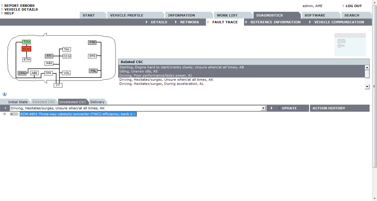

Helping a buddy trouble shoot with the vida dice. I seem to recall 02 sensor goose chasing on a similar code on my 01 and/or 03 but wanted to start a new thread in his world of 2000.
ECM-4801 Three-way catalytic converter (TWC) efficiency, bank 1 -
I've seen mention of injectors, cats and 02 sensors...I recall talking with people before that the down stream sensor being out of spec and trigger the upstream (bank 1?) or maybe just replace the upstream. Yes, no, maybe...
How does one go about troubleshooting this...as it seems many in the past just throw money at the main variables till they figure it out...no thanks!
EDIT: I should add he has no drivability issues everything seems happy to him in this newly aquired 180K mile ride.

HI Jimmy, How do you know that this car's rear O2 Spenser is unstable in the .65 to .75 voltage range? I am trying to understand Shawn's screen shot. I do not see anything relating to voltage.

Maybe I can get him back over and hook up Dice again and do a live reading with tests like you said...and share that data...or do you agree with Mattie Moo that it's most likely the downstream sensor.
Kahl, what I shared only shared are codes. One of the tabs shows a snap shot of values at the last failure...and you can also select live data values for many sensors at once too...which we may do next.
