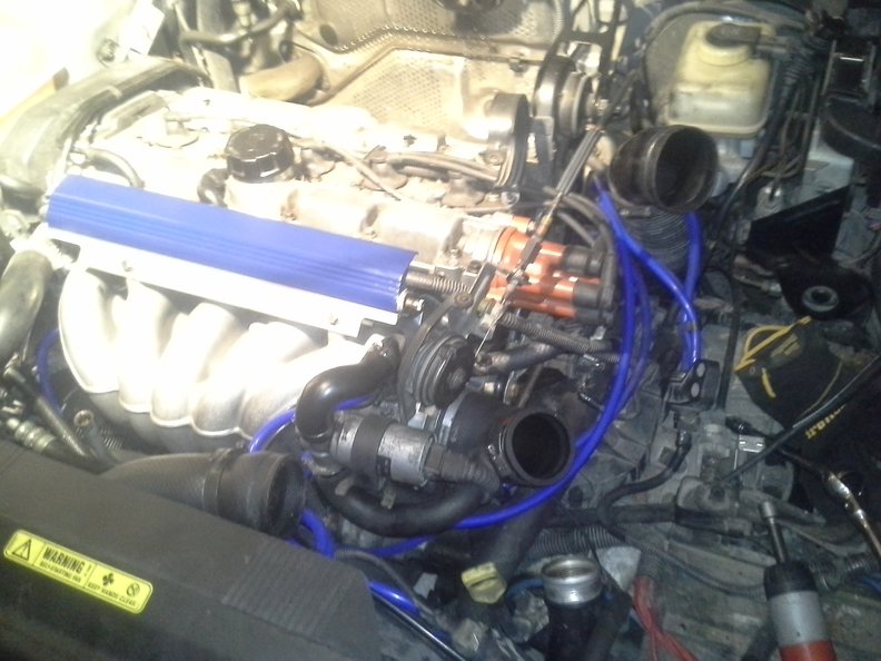

I betting if he looks under the distributor he will find the rear cam seal has blown out. I kept putting my dipstick back in and that's what happened. doing a complete pcv/oil trap service as soon as the parts arrive

Sorry my post never got put up that I made last night. But I drive at the most about 100 miles per week just to and from work. I have a new oil trap in hand now. My next question is how do I tell if the EGR valve is still operational? I have it out and in hand. Its pretty clean already but I lightly cleaned it up some more with a tad bit of carb cleaner, being cautious of the rubber diaphragm. I took a pick and inserted it into the rear end where the copper tube goes too and pudhed in on the nub and it comes right back with no hesitation. Is that good?

Also I was able to get the oil trap overnighted but not the dipstick gaskets. But they are in transit. So now I have all new : intake gasket, EGR valve gasket, silicone vacuum lines, and new oil trap. Like I said im judt curious about the EGR operating correctly or not. Thanks for everyones help and advice by the way, especially during the holidays.

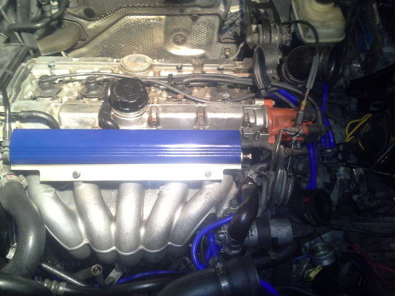

Okay, its all together and running great. Still waiting on the oil cap seal and dipstick gasket to arrive. But on the short one mile trip I drove it, there was no oil spewed but tgere was very light smoke coming out of the dipstick tube.
I had a compression test done when I had the timing belt and water pump replaced and it was all in spec. But on another note, I really pulled a dumb move and let my brother do the gasket surface cleaning. In his process he used a wire brush and 400 grit sandpaper ugh! Its all back on already. So once I get a chance to check to see if its leaking and if it is, do I have to get it milled to repair it?
