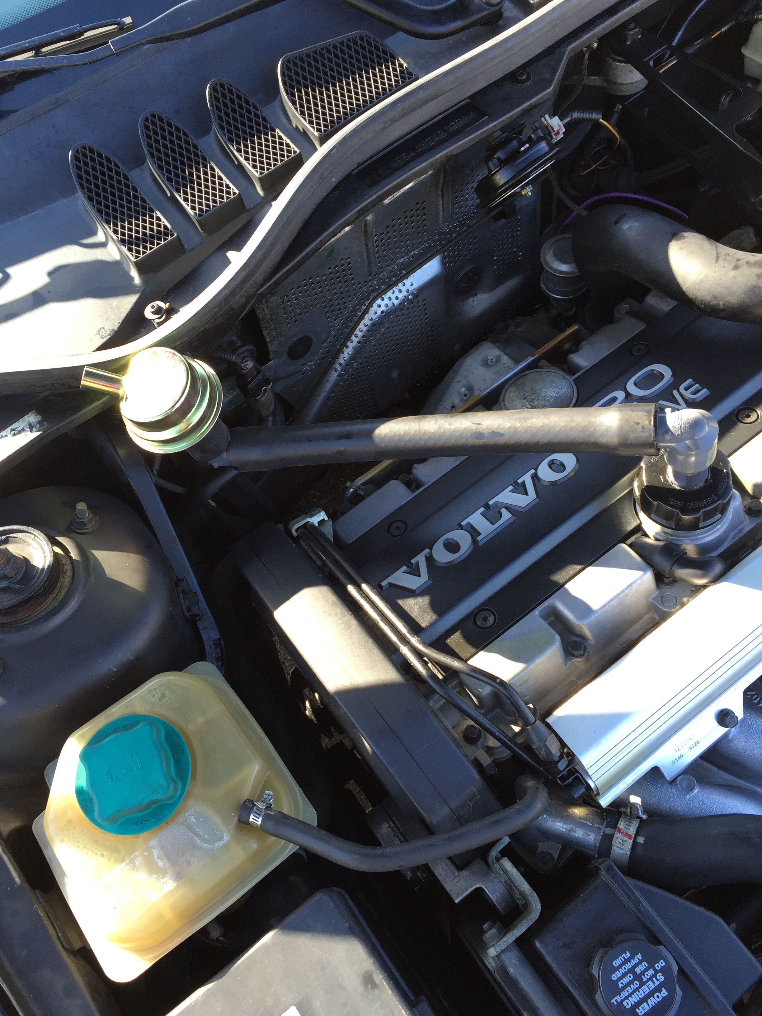

I ended up releasing the pressure build up with a snorkel off the oil filler cap and a vent tube off of the dipstick tube as wheelsup suggested.
I attached a picture of the snorkel 1.0

Looks like a clean engine bay!
Couple thoughts on the snorkel:
- Won't that fill up with oil?
- Its exhaust seems rather close to the fresh air intake for the cabin.

The engine bay is clean because I've had to pressure wash it several times due to oil spraying all over:)
Snorkel 1.0:
-Ideally the pipe is at a slight angle so the oil that does build up will drain backwards from the last 90 degree elbow in the hose, plus I'm hoping that breather filter stops the oil?
-I bet the exhaust will be a problem with the fresh air cabin intake, hopefully it's angled enough away from the intake?
-that's why it's snorkel 1.0....I'm sure there are going to need to be improvements:)
Thanks for your feedback..and where do I get this "snake oil"? Do traveling salemen come around from town to town and sell it out of the back of there buggies?
Snorkel 1.0:

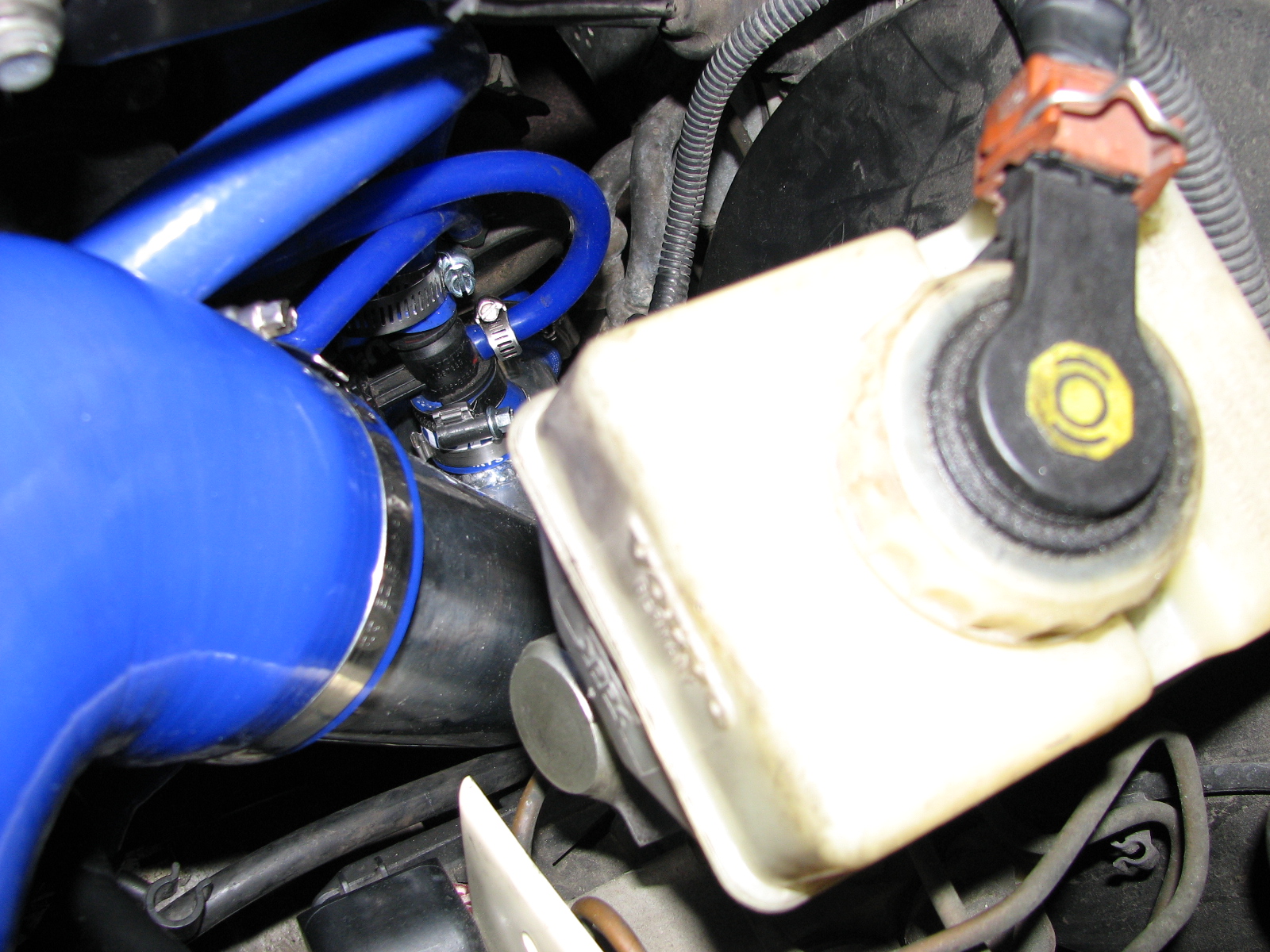

That "Snorkel" is creative, and is venting directly to the area of your cabin air intake.thedawgfather wrote:You are right precopster...the numbers didn't change much by taking all of the spark plugs out.
The car runs and drives fine, but like you say, maybe I'm just used to it?
Just wanted to point that out. I see you have noticed that while reading back.

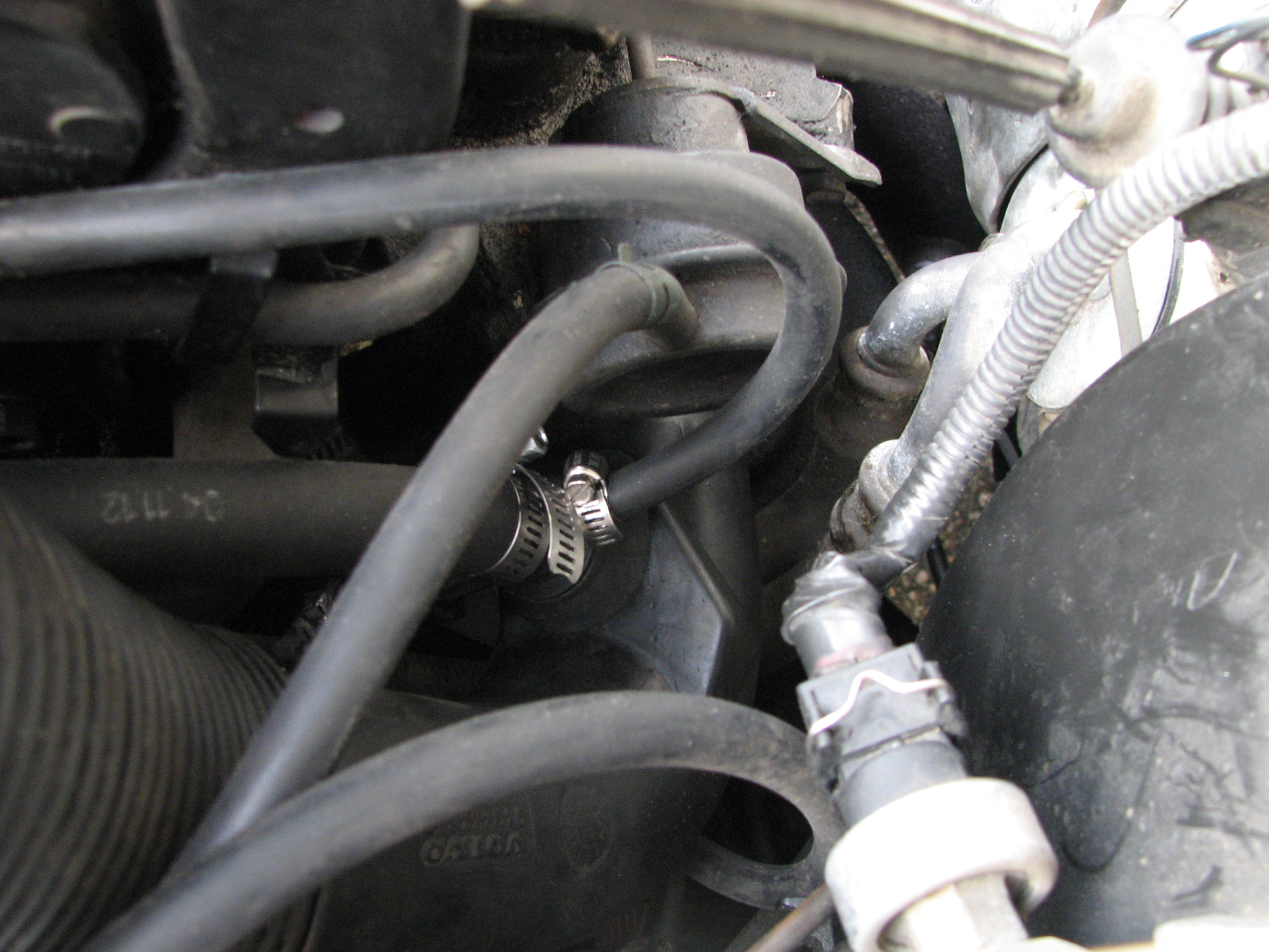

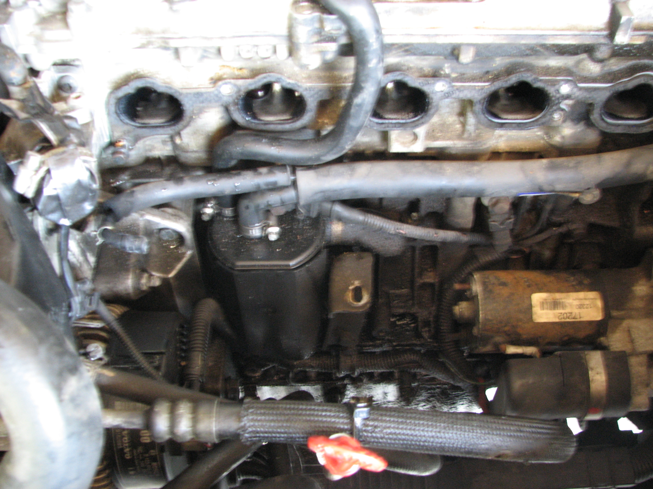

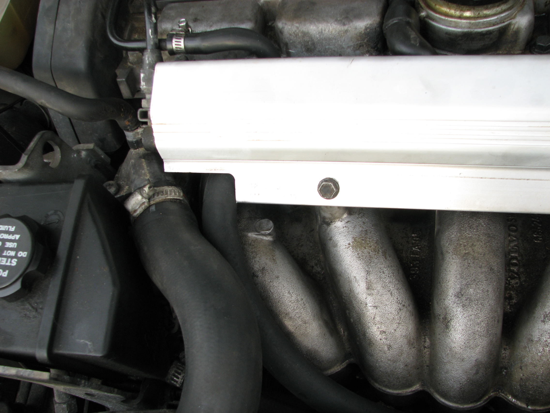

If the passage to the sump from the oil separator has been cleared, the only other alteration I have had, or wanted to do, is to simply use a hose from the oil separator back to the induction tube.
It appeared to have been done once already to the wagon before I had taken ownership. PCV replacement. Cleaning? I don't know.

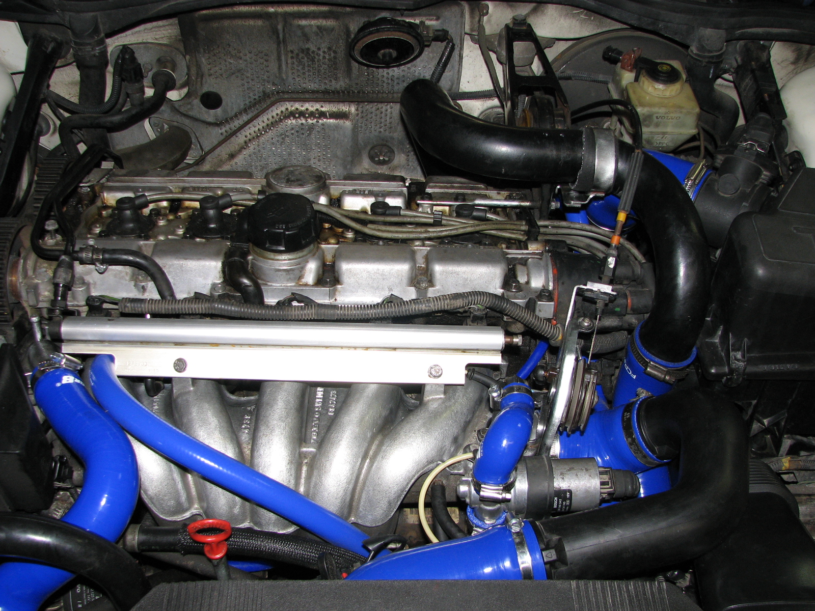

This was my cleaning and re-routing immediately after taking ownership.
This is the '96 Turbo wagon after the 3" intake upgrade. (Above.)

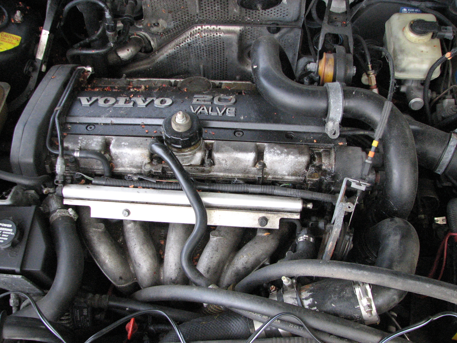

Below is the N/A ''93. Not as pretty.
The Turbo is running at a substantially higher performance rating than "stock" at this point.
It had all the normal symptoms of clogged oil separator passage to sump.
Since cleaning that sufficiently, and adding a simple hose to delete the hard plastic tube, all is fine.
I have a '98 LPT like yours that I will be doing all the same things to, likely next month. I will update you then.
One last Photo.
The T-5R I also will be doing the same to seemed to have been hastily modified to be killed as a track car. The previous owner had almost succeeded. I have some frame and body work to do as well.
I will have to get the manifold off to make sense of the hoses, but I believe they are all simply dumping crankcase vapor.

Answer these questions please:
(1) It's seems to me that the pressure build up from the top of the engine would be routed down by the hose that going down in between the intake manifold to the oil separator box that once the vapor enters the oil separator box that in fact the oil separates out of the vapor and the oil drains down through the box into the crankcase/oil pan and the vapor rises and gets pulled through the hose that runs out of the oil separator box, around the engine block to the PTC where the vacuum line that comes from the intake manifold (under the heater hose that run into the thermostat) attaches to the PTC nipple and vacuums the vapors into the intake manifold to be combusted in the combustion chamber/cylinders and exhausts through the exhaust system out into the world with all the rest of the exhaust. Now if that's the case, and if I wasn't worried about saving oil, I'd run the hose from the top of the engine to the vacuum nipple on the side of the intake manifold, right? (I know I'd need adapters but I'm talking about the concept)
(2) My other question that wasn't answered yet about the fact that I secure a rubber glove around the oil filler hose and the glove stands up at idle and gets sucked down upon reeving the engine, same as when the smoke from the dipstick tube stopping upon reeving the engine...would that indicate that in fact the vacuum that is provided at the vacuum line attached to the intake manifold is, in fact providing enough vacuum to do it's job?
I'm thinking of my new Snorkel 2.0 modification and I think since there are so many people that are concerned about my well being and that I don't pass out from oil vapors while driving i.e. the fact that the snorkel exhaust is near the cabin fresh air intake, that I'm thinking that I should run a hose connecting the breather filter/snorkel exhaust with a empty nipple on the vacuum tree?

OK,
# 1. If you look at the photo of my '93, that hose was not even utilized yet as a means of ventilation.
I believe it may have been added later to relieve pressure from valve seals.
If it were (venting), sending it directly to the induction tube would not be a good idea.
I have been collecting service manuals over the past couple years. I have not yet found the one in which this system is dealt.
#2. No. Since you have now provided a "Snorkel", it is no longer a closed "System" as it was designed.
The applied vacuum is no longer doing what it was designed for. That being said, the solenoids actuated by said vacuum are also invalid.

OK,
To this day, there is no venting from the head of my '93. No smoke. No blown seals since cleaning and " Flame Trap" delete. (n/a)
