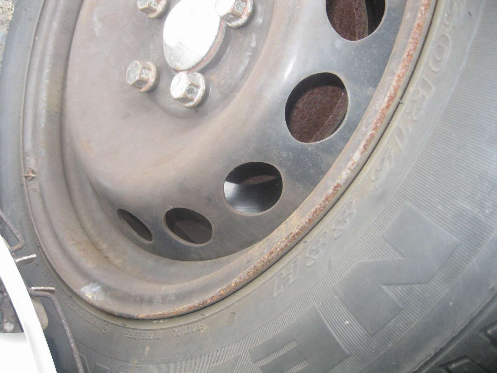

So i guess the rotor drums are like the old brake drum and shoes, since it's really the same thing there, where the shoe would catch on the drum if there was even a small ridge near the edge of the drum due to wear. With my first drum type brake job i wondered what could be holding that drum on. I found out it was that ridge and the tiny clearance between the drum inside surface and brake shoe.
I checked the rotor surface a little, by looking through the holes in the wheel. I see a shiny surface, with some grooving. So the surface itself does not appear to be rusty, just the outer edges and the outside of the drum is rusty. Maybe that rust is causing something else to stick so it doesnt retreat as far as it should?
I thought maybe the rumbling was because of the ABS system detecting a partially locked brake, but the brake pedal itself does not move at all or pulsate or anything like that.

Right, every rotor on these cars has a rusty "hat" surface, unless it was painted for cosmetic purposes. The remark from the shop that the problem is rust on the rotor is a strange one. If they meant the caliper is rusty and sticking, that would make some sense. Perhaps the caliper does not separate properly from the rotor.
