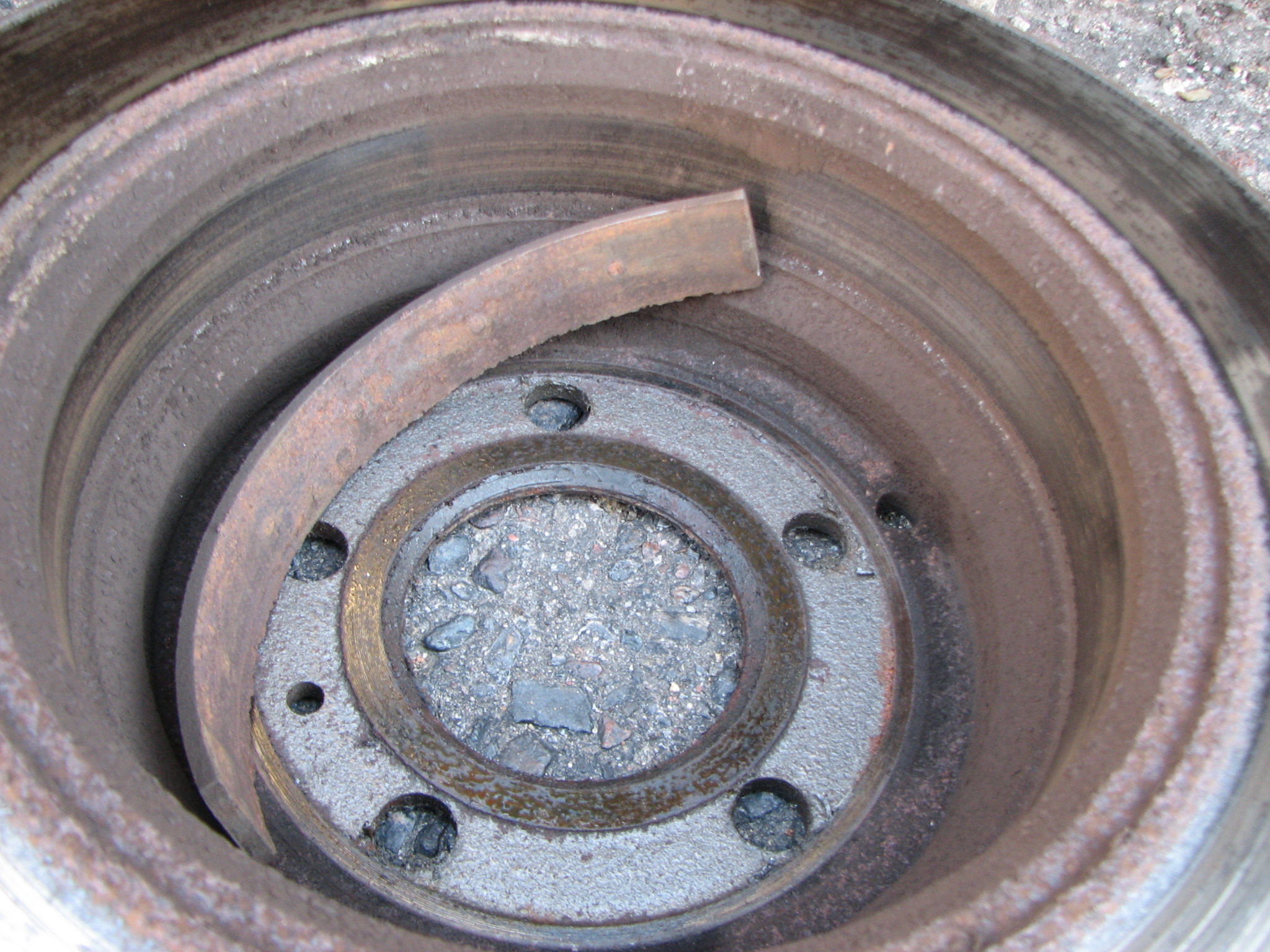

It's pretty common for the parking brake shoe material to just fall off one of the shoes and be riding around inside the brake drum, I have seen it a few times now. The inspection idea would pick that up.

^^ Yes, EstVolvo's pic shows what I was talking about. Very common.
