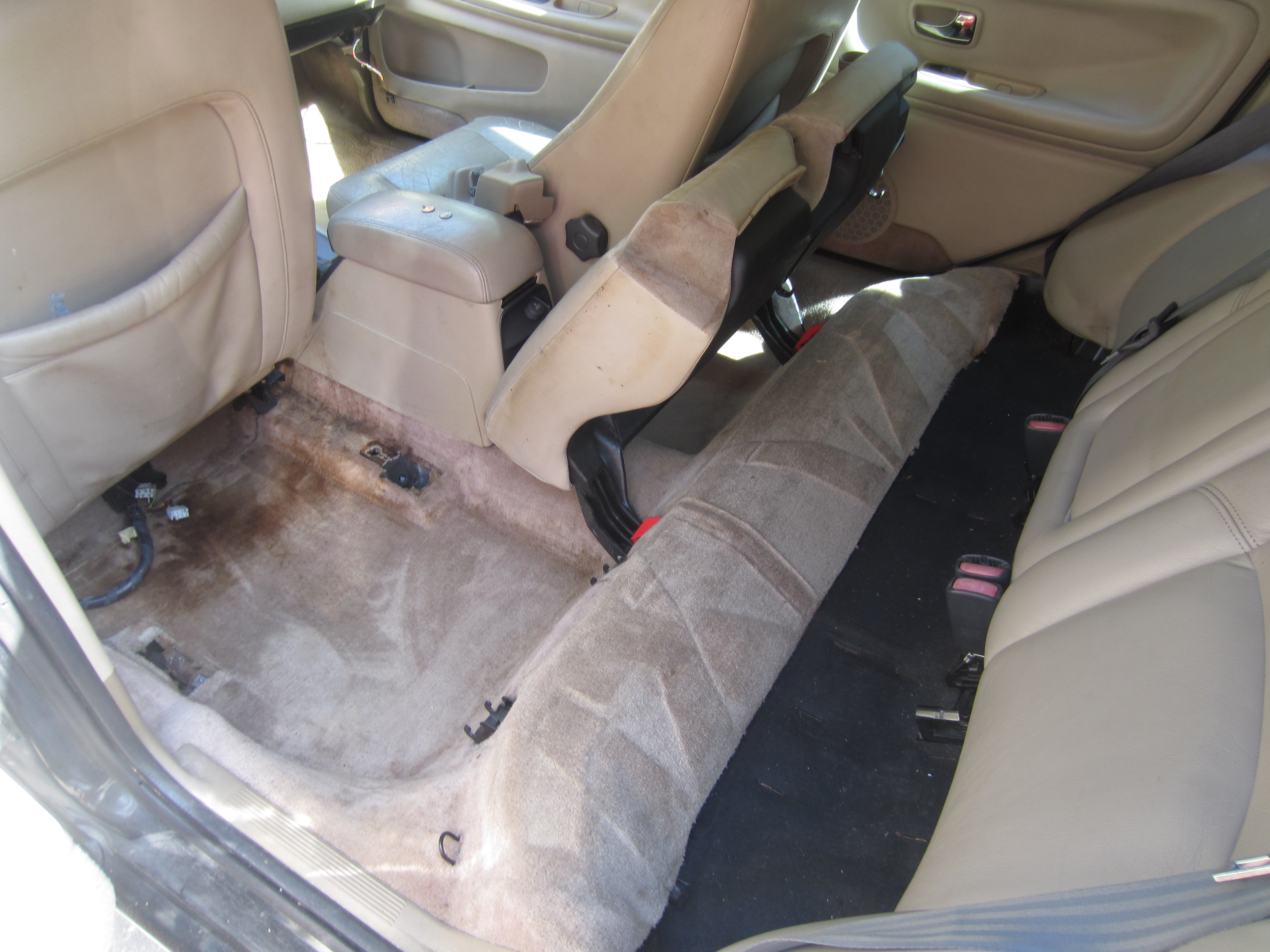

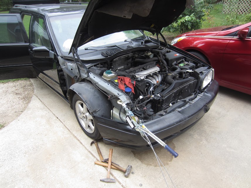

As of today, I have completely vacuumed and shampooed the carpets, cleaned and conditioned the leather, cleaned all the glass, cleared out all of the broken pieces in the engine bay, straightened out the fender frame, and added a Little Tree
. The carpet is still dirty, but it looks much better than it did.
The fender is pretty hammered now, but it's much straighter than it was. Took a lot of hammering and pulling with a cable puller. Just about ready to get everything put back together!
Don't know what that stain is. And not sure I want to.
Not perfectly clean, but it's better.
Wish I had a before picture of the frame. It was a lot worse than it is here.
That's what I mean by hammered...
All cleaned up for the most part.
