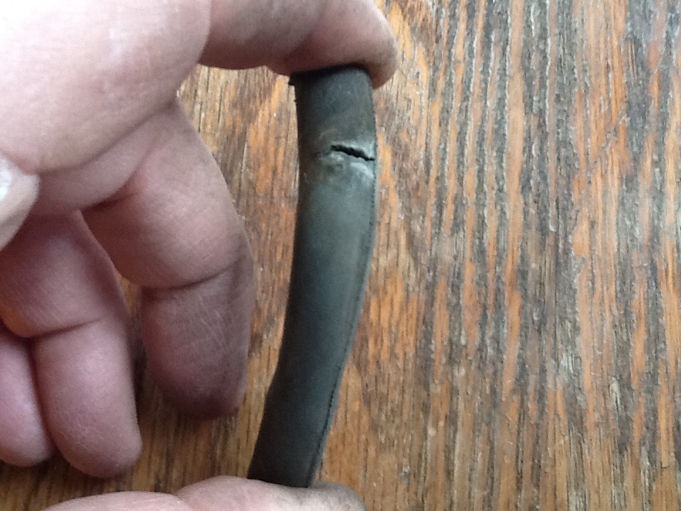

Replaced the roll over valve hoses. Found one with a nice crack.
