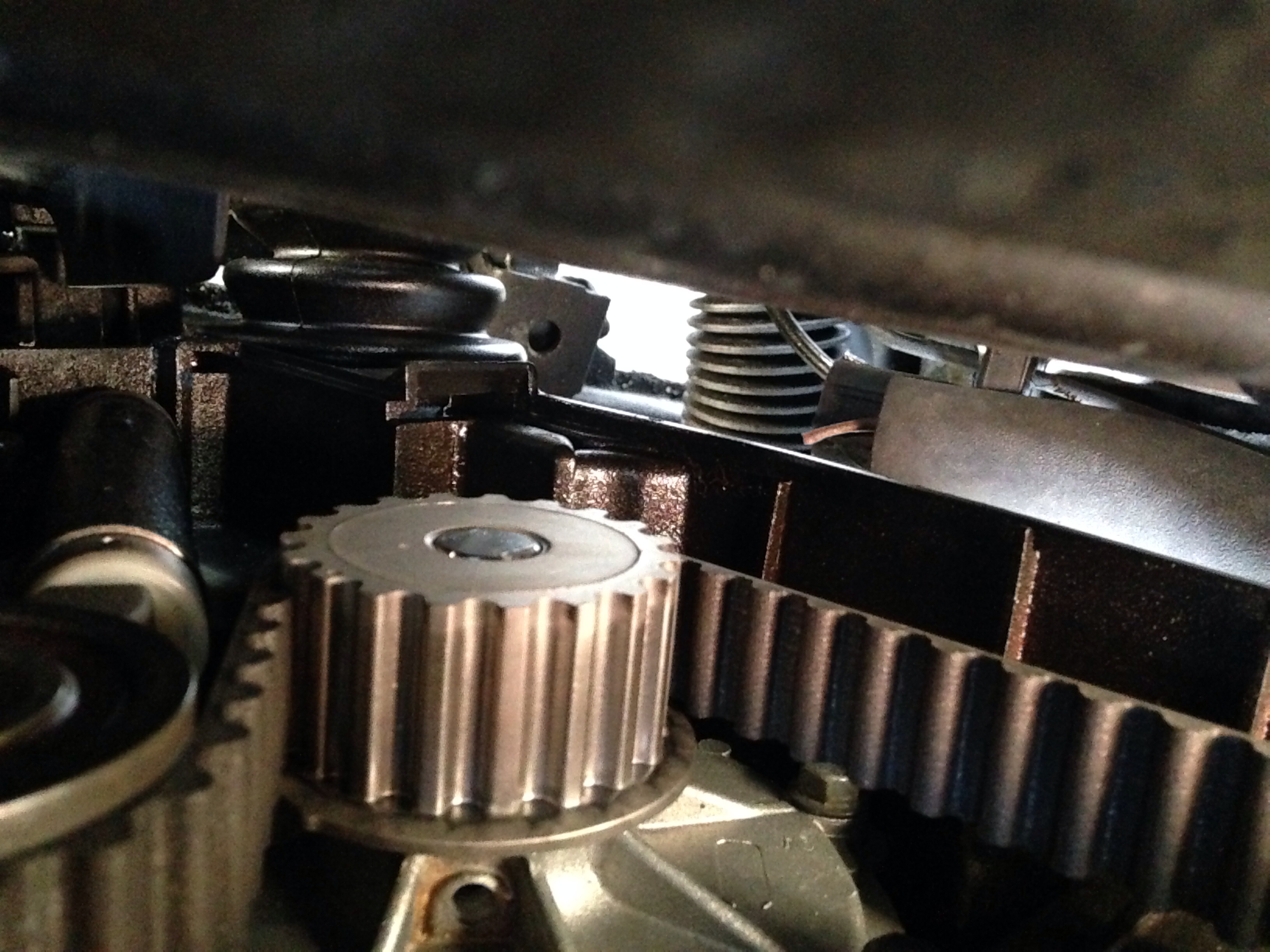

Well, my starter died after stopping to pick up breakfast on my way to work. Having it towed to my house, going to replace it myself. While waiting for the truck, I pulled the timing belt cover to get a photo of the leak...

Leaks down the left side of the timing path are usually from the top of the engine, have you pulled the plastic cover over the spark plug boots to see if it is oily up there?
Keep in mind that front cam seals rarely go out, even if there is PCV pressure. Almost always the rear seals pop from that pressure. Although if the fronts were recently changed then all bets are off, it is too easy to end up with junk parts in there.

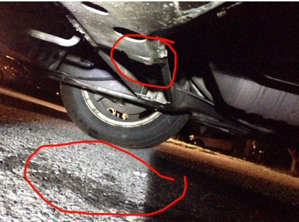

I checked under the spark plug cover and didn't notice any fresh oil except around the oil cap, which was from me topping off the oil and spilling a few drops. The car has been sitting since my starter died last Thursday. I looked under the car tonight and noticed another leak, but this time on the driverside (see pic). Fresh oil was dripping.

In the last picture that looks like red oil in the flash where the drip is. If it is it isn't engine oil, it is either trans or power steering oil (ATF).
The other point looks like the rear cam seal. Clean the area off and leave the cover off and run the engine to see where it starts leaking from.
