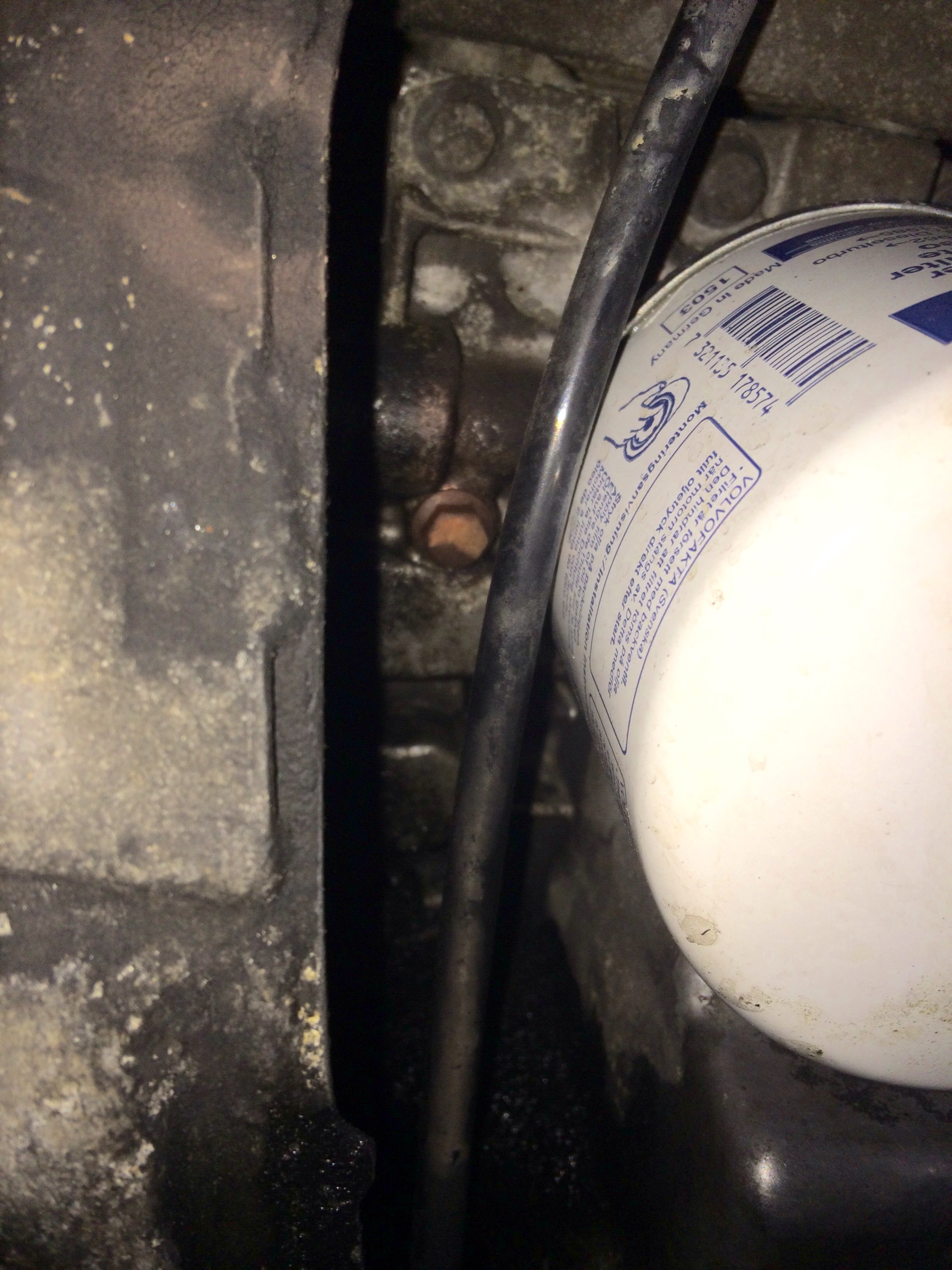

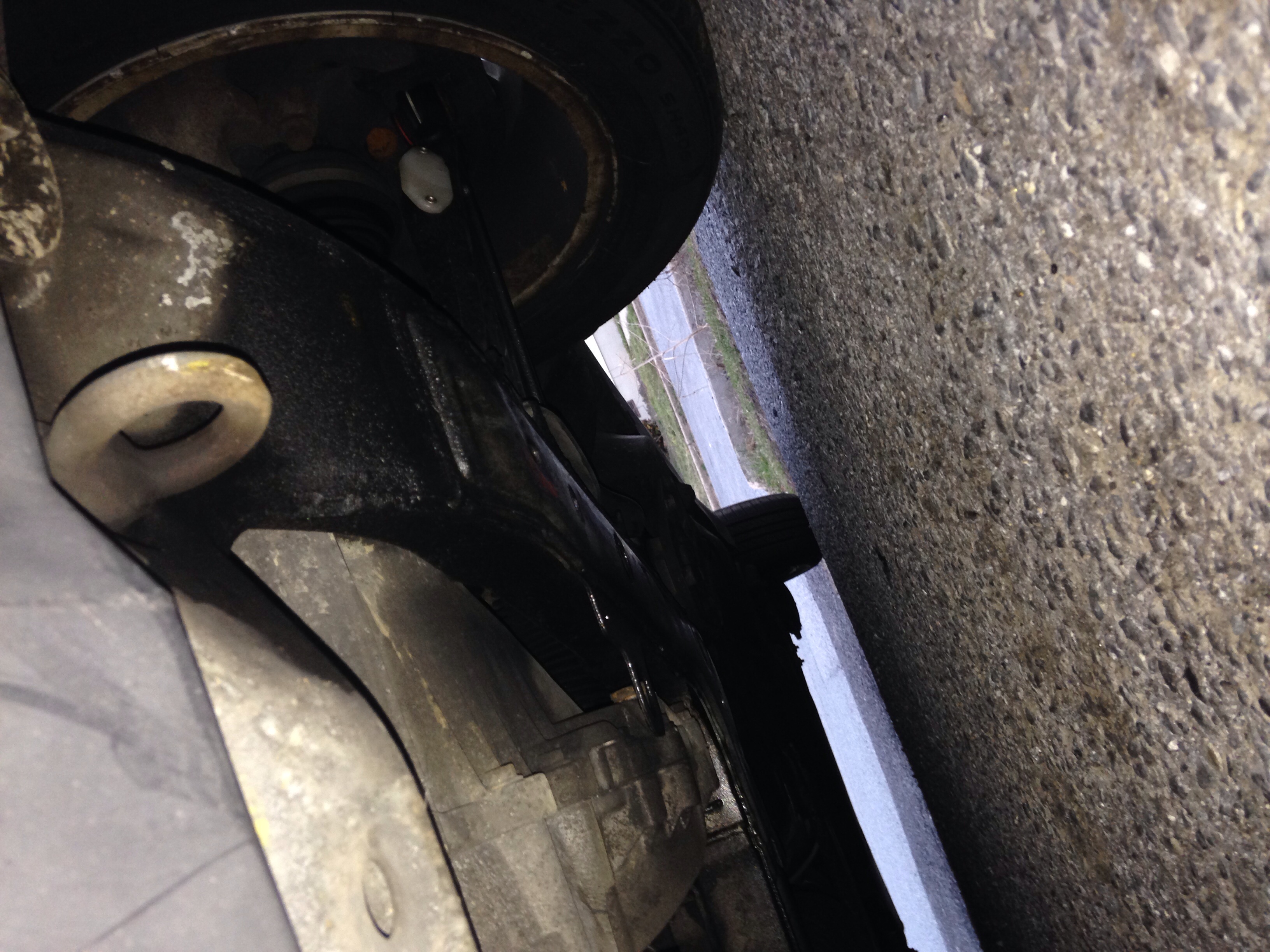

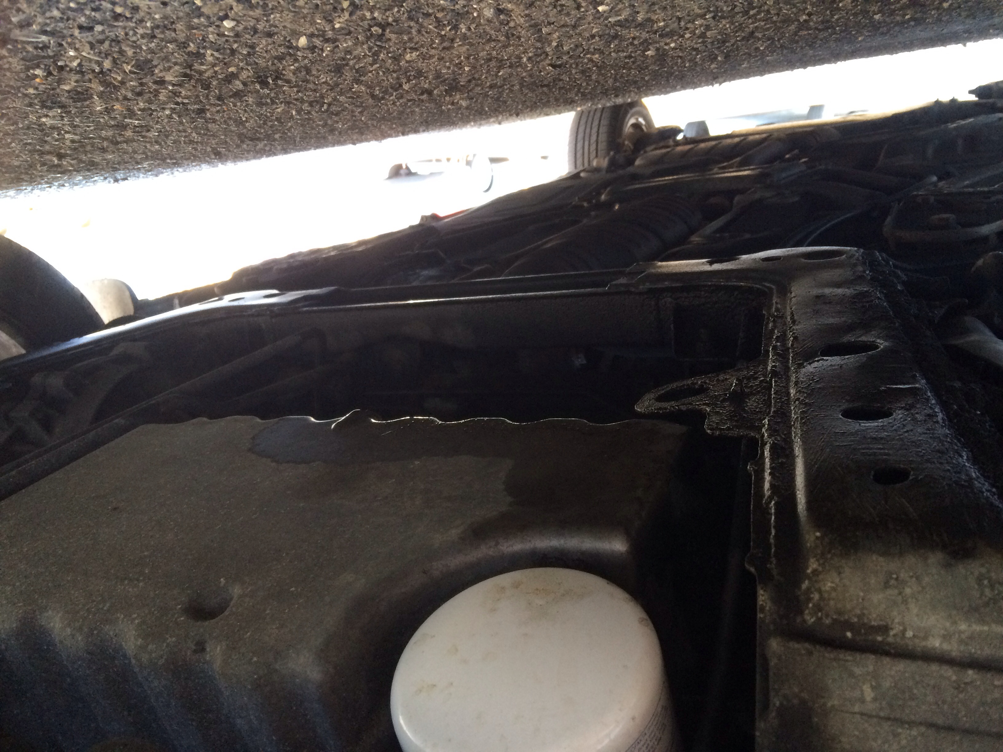

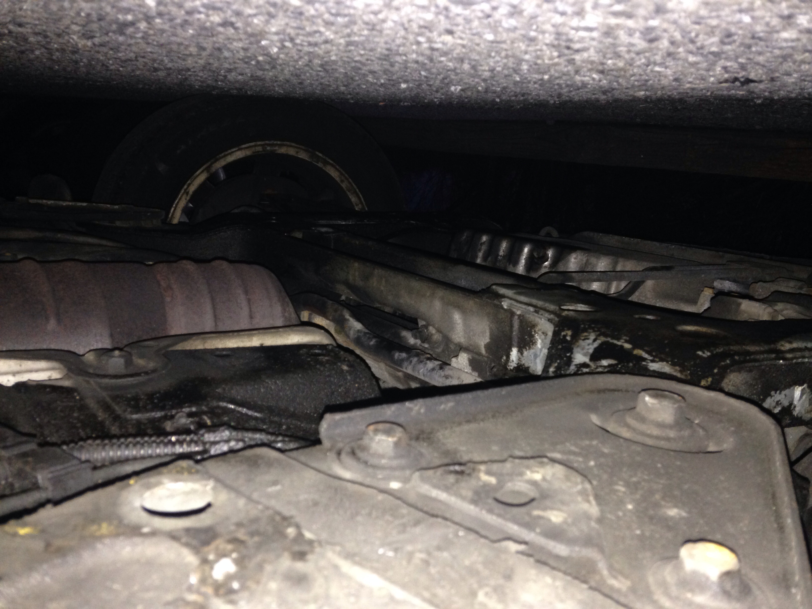

Two days ago I looked under my car after doing my 5min drive and there was oil all over the back of the oil pan, and the wheel well area on both side of the front. Looking under the hood I couldn't spot any signs of the source leak. My mechanical knowledge is limited so I have attached pics, although they are not the greatest. Any idea what seal could be blown or source of leak? Also what is the best way to get it cleaned up so I can keep an eye on it while I wait for the parts?

Good news is it looks like you have popped a cam seal on the front of the engine (right side) , not the rear main seal on the engine.
Cam seal is about 10 bucks, and a mechanic needs about 2 hours labor to put it in, so a couple of hundred job. You can also DIY.
The rear main seal (RMS) is also about 10 bucks, but 10 hours to remove the engine - so its a >1010 USD job.

- The oil leak is classic of a FRONT cam seals, which are usually done together with the timing belt at this mileage. Detail in this thread I wrote a few years back. Even if you use the indy, make sure you go over the thread below and discuss it with him/her.
https://www.matthewsvolvosite.com/forums ... =1&t=53722
