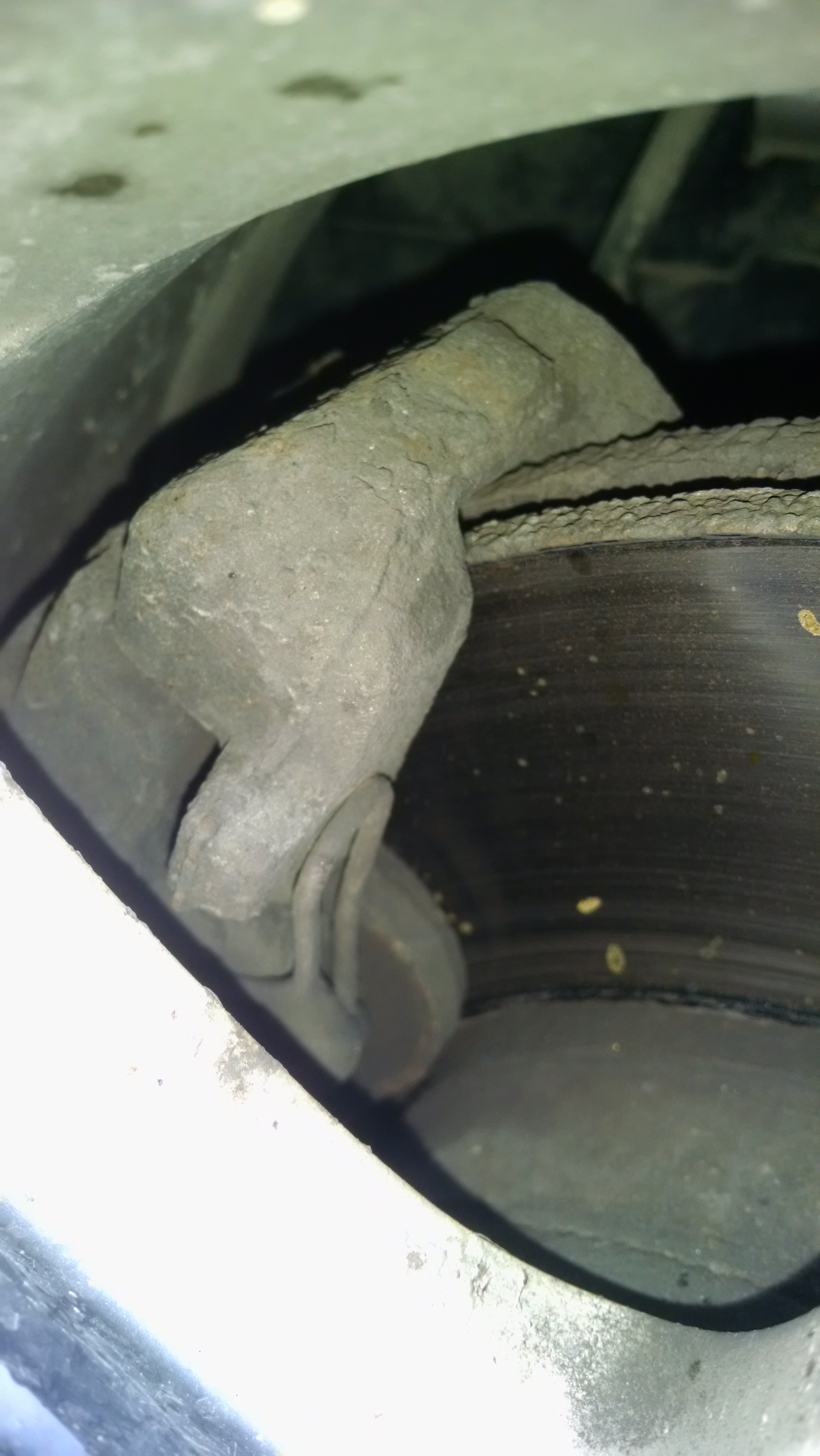

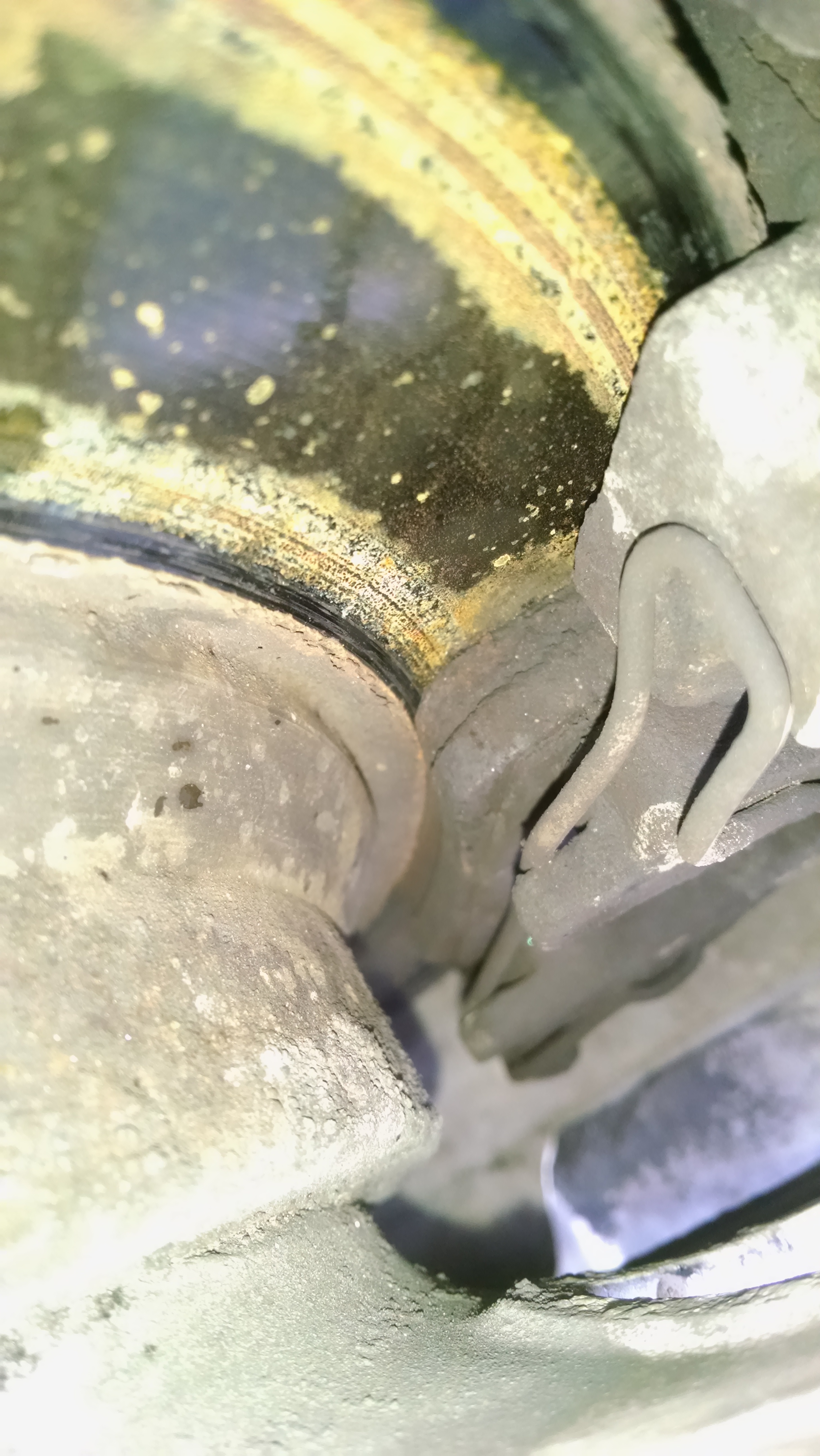

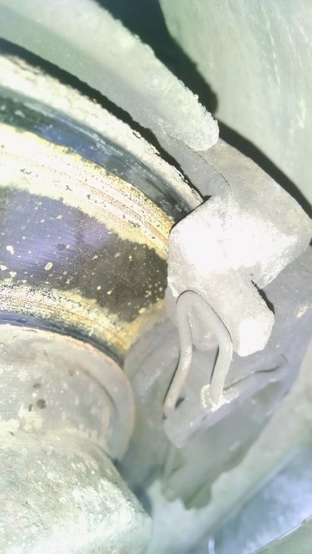

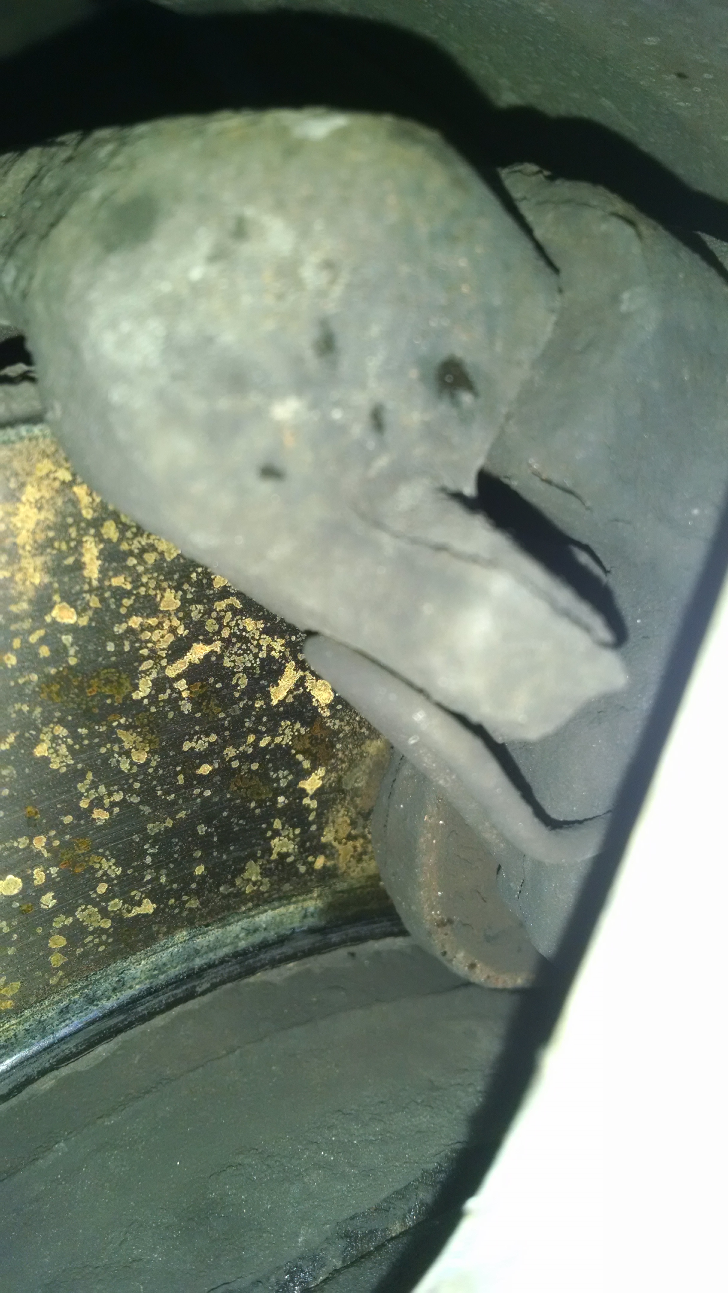

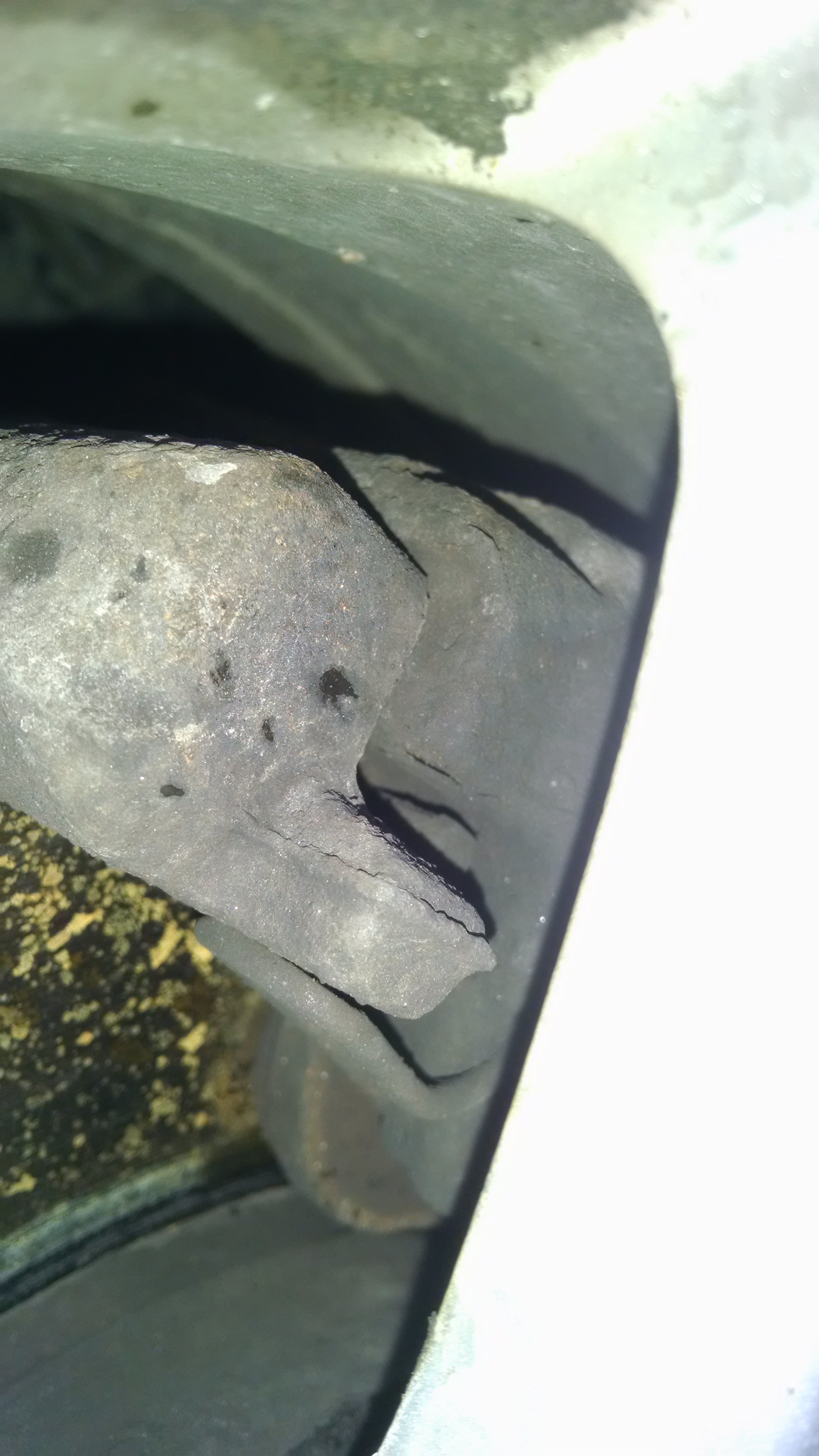

It is difficult to see the wear at the edge of the rotor but not sure it's that bad. How much wear could they get before needing to be replaced, just 3mm wear or is it much more?
The pads look plenty at the back.
The front, well, less but not sure it's down to 3mm yet. The edge I took the picture of is the leading edge so should be more worn than the rest?
Any thoughts?

The rear discs seem really tired while the pads are still very good. If replacing the rear rotors, it would be wise to closely inspect/replace the handbrake shoes that sit inside the rotor, they tend to delaminate and cause damage.
Front discs seem decent, while the pads are a bit worn but personally I wouldn't change them yet, they may still be good for quite a few thousand miles.

Front pads seem to be around 4mm remaining, I would replace at 2mm given the wear is uniform. This is the material that is contacting the disc surface, it's the wear material of the pads, same that on the rear wheels pads is ticker on your car.
Rear discs seem to have uneven wear across the surface and the outer edge seems very rusted sign of age
