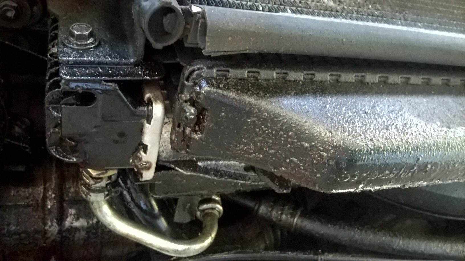

I've been looking on FCP for the Radiator, Trans Oil Cooler Lines, and a Timing Belt Kit, Eeuro for the Engine Oil Cooler Lines, and iPd for the PCV Kit. The last mechanic I went to pointed out that one of the "bypass" hoses around the back of the engine had the wrong type of hose/line on it.
Integrity Auto 1.png (322.31 KiB) Viewed 1794 times
What type of hose do I need to be there? I was thinking of replacing all the vacuum lines around the bay as well at some point in the future so if it needs to be a vacuum line then what do you guys recommend?

From your picture its difficult to tell what exactly we're looking at but to me that looks like the short coolant hose on the back of the engine on the passenger side. Two hose clamps on it means its probably not a vacuum hose.

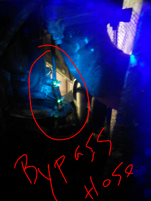

As far as the "bypass hose" goes there's nothing actually called that. If you can get a better picture of it we can try to ID it for you.

So I finally ordered the first set of parts and have to go to the auto parts store in town and pick up some last essential tools like a set of ramps, a torque wrench, and extra clamps for the trans and oil lines to the rad. Are there any bolts/screws I should also replace? I think maybe he was talking about the compressor bypass valve line or hose? Anyway they are all getting replaced and I'll see which ones failed when they're off.
