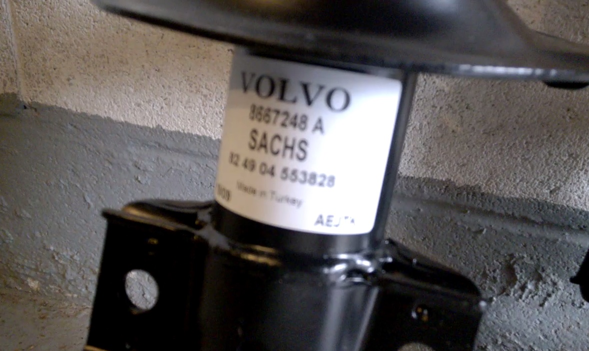

Would like to update this topic. This is going to concern the P2 cars, not sure if it's the same for P1 cars - but in theory it should be the same thing
I recently installed Genuine Volvo struts. These are still made by Sachs, only now they are made in Turkey (the original struts when the car was new were made in Germany). For comparison, I also had an original Volvo strut still in good condition, and also had a few other struts, like the Sachs blue sticker (Super Touring), the Monroe cheaper ones and also the Monroe OE Spectrum (more expensive)
Here's my quick feedback on all these options
The new Genuine struts sold now by Volvo are made in Turkey (see picture). I'll call these the 'Turkey' struts to differentiate them from the original ones which were made in Germany (when the car was new). The Turkey struts are of much lower quality than the German ones. I'm sure many will be surprised by this, but the explanation is actually simple: Volvo has cut costs in parts manufacturing during the later years. We can simply remember the changes in the cars from 2004 on, when the quality glass headlights were replaced with cheap plastic headlights. There were other cost cuts Volvo did. Same happened with the genuine replacement struts, which are now made in Turkey. These struts are very harsh over road imperfections - bumps, cracks, etc. You can feel every bump harshly. The only moment when these struts are fine is on smooth pavement. Even then, they ride without any 'feeling'. Good stability at speed.
In comparison, I had Monroe OE Spectrum ones - these are the more expensive Monroe. The OE Spectrum ride well over road bumps, not harsh at all. They don't feel sporty or luxurious, but comfortable enough. There is also another Monroe, less expensive, which are harsh and of low quality.
I also had the Sachs Super Touring and those were giving a rather subpar driving, not stable and not dumping bumps properly. These also wear out very quickly on poor roads.
Of all these, for a better ride quality with a smoother feeling but slightly less stable, the Monroe OE Spectrum would be my first choice. If the roads in your area are all smooth, the genuine Turkey replacement would be the first choice.
Off all these struts, none felt as good as the original suspension. Don't expect the car to ride close to a 'luxury' sedan with any of these. I think the original ride quality of the car cannot be brought back.
Finally, all these struts lifted the front of my car by about 1 inch. The stability and handling are inferior compared to the original suspension. I only replaced the struts, and kept my original coil springs, and the car was always lifted with all these replacement struts.

- shock.jpg (197.02 KiB) Viewed 8751 times
