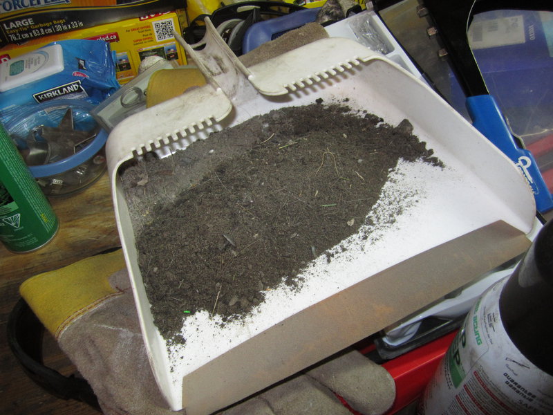

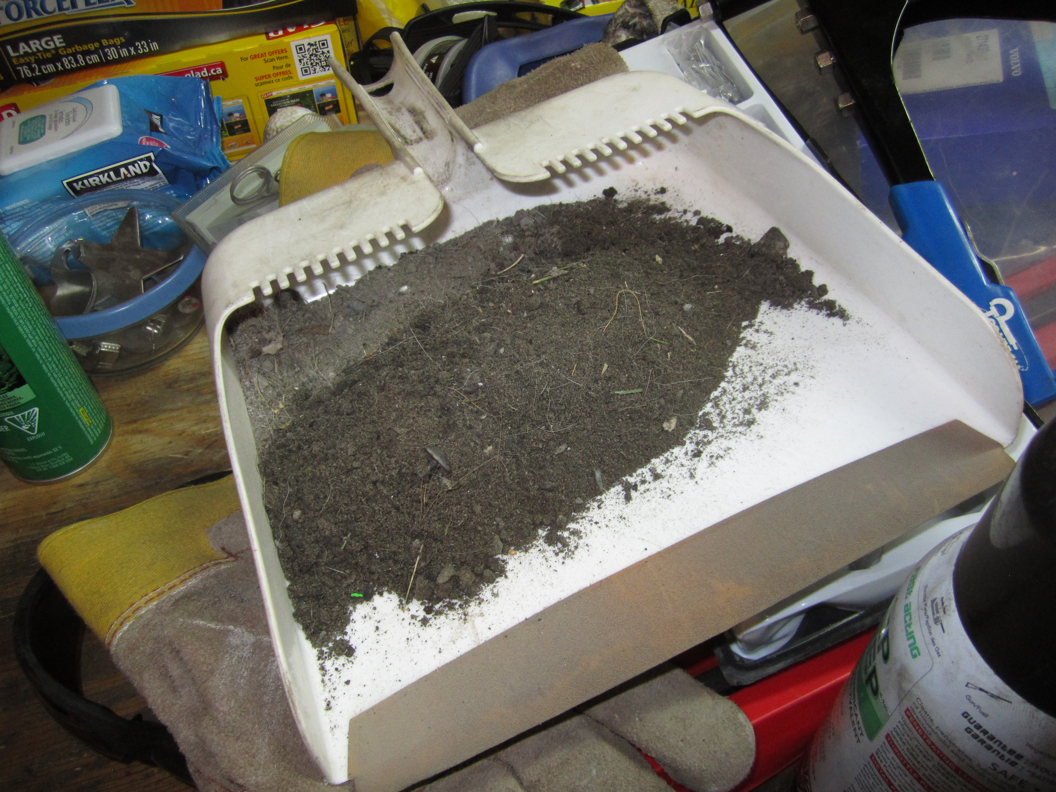

with little else to tackle available, I decided to repair the front mud flaps as the lower rivets had been pulled through. Drilling the lower 3 rivets out, allowed me to pivot the mud-flaps to remove a whole load of dirt that filled both of them! This is a picture of the crap that came out of them:
Car must have been off road at some point!! Is this a missing Volvo rally car?

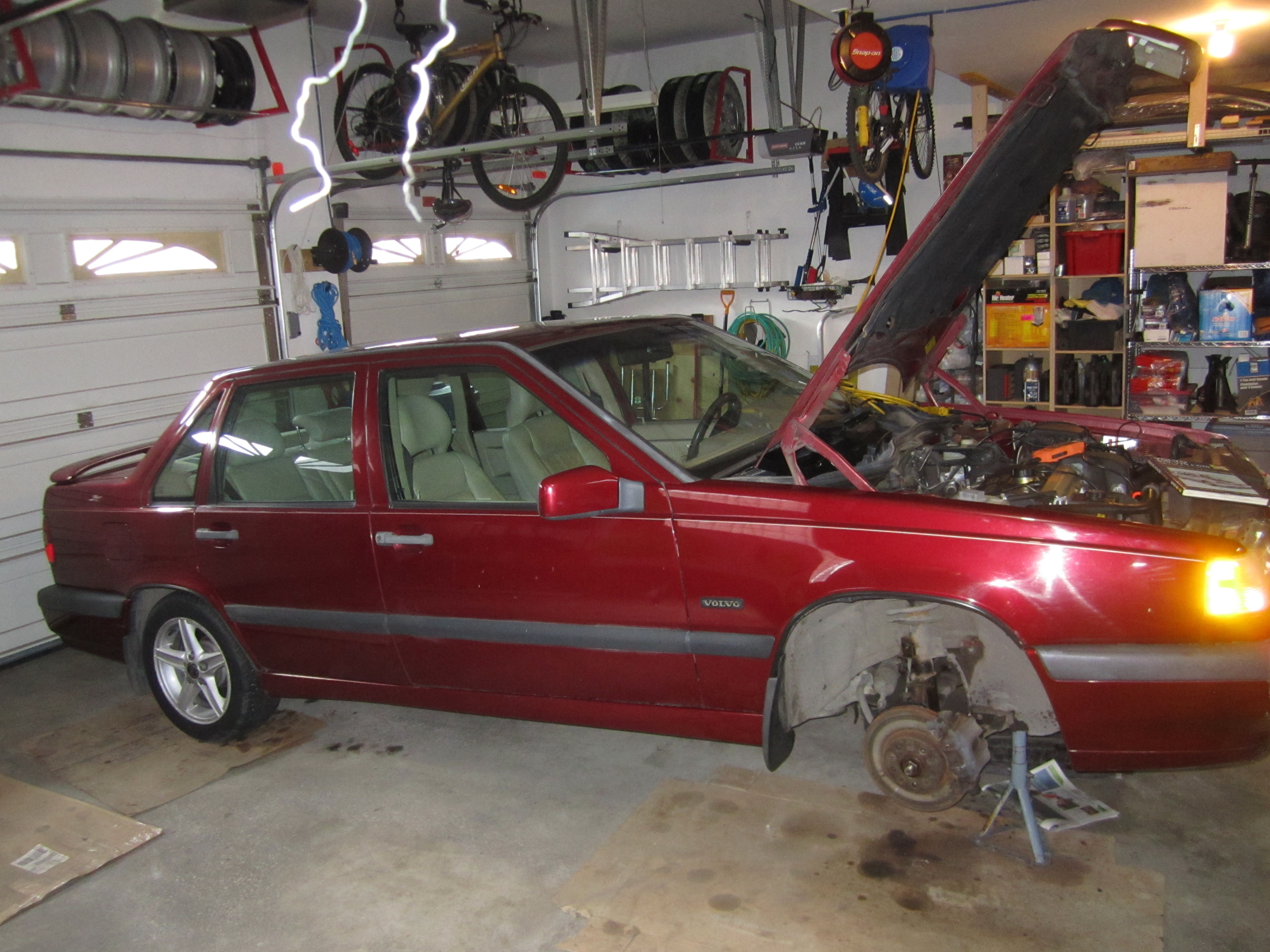

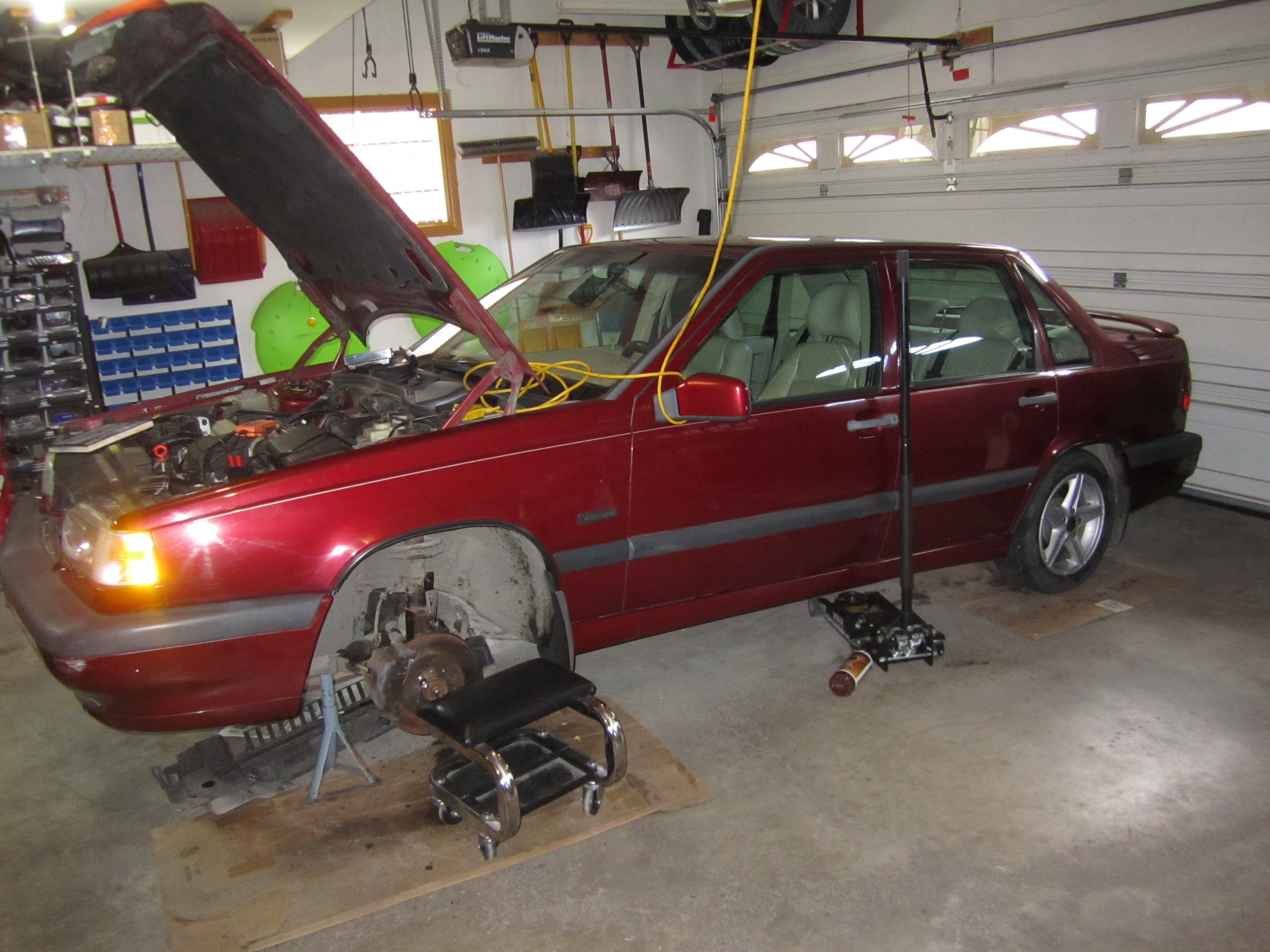

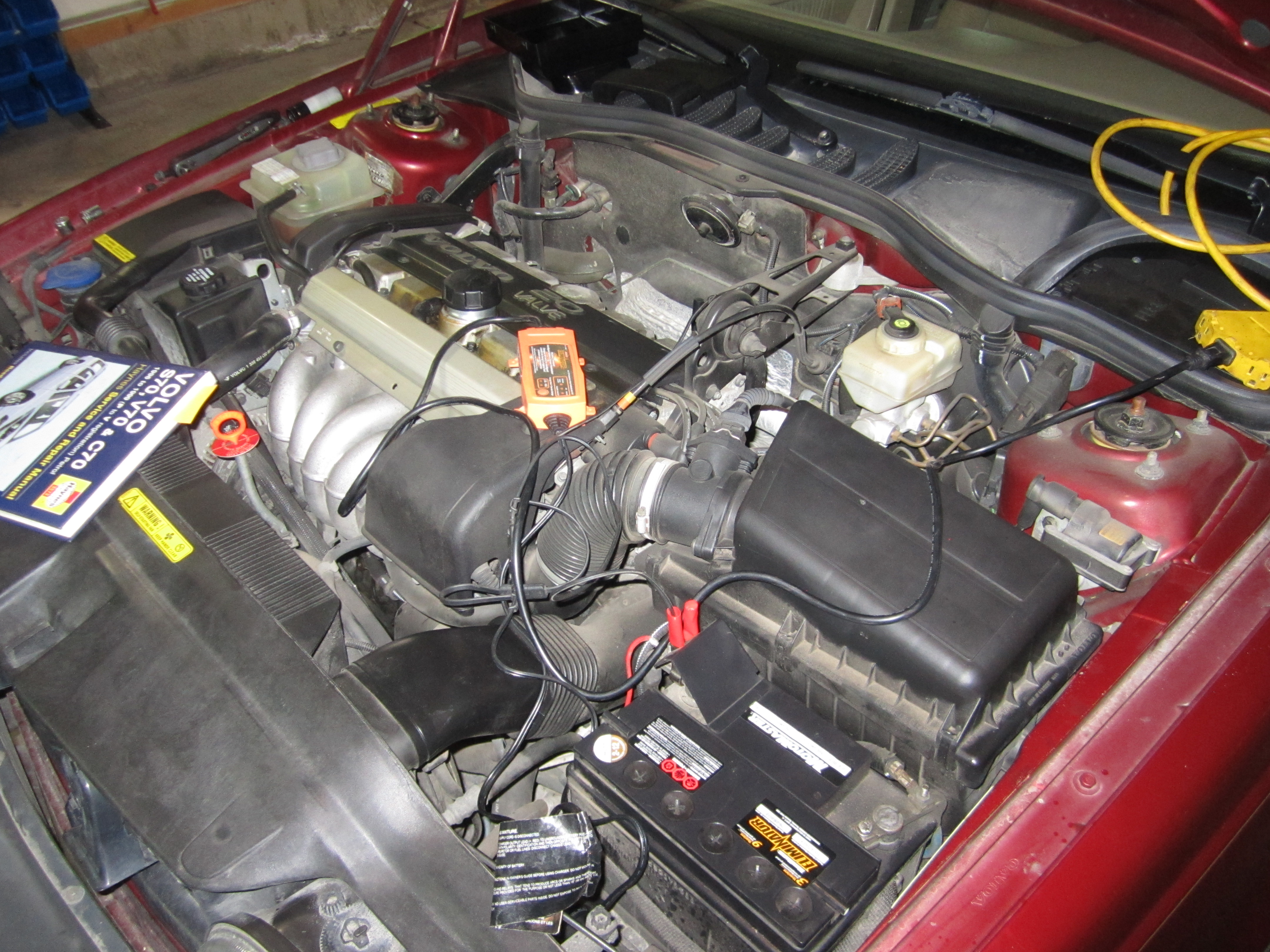

Took some more pictures of the car today:
Car is pretty clean under here. Just wiped over with a cloth to remove some dust.

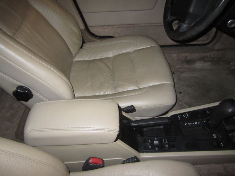

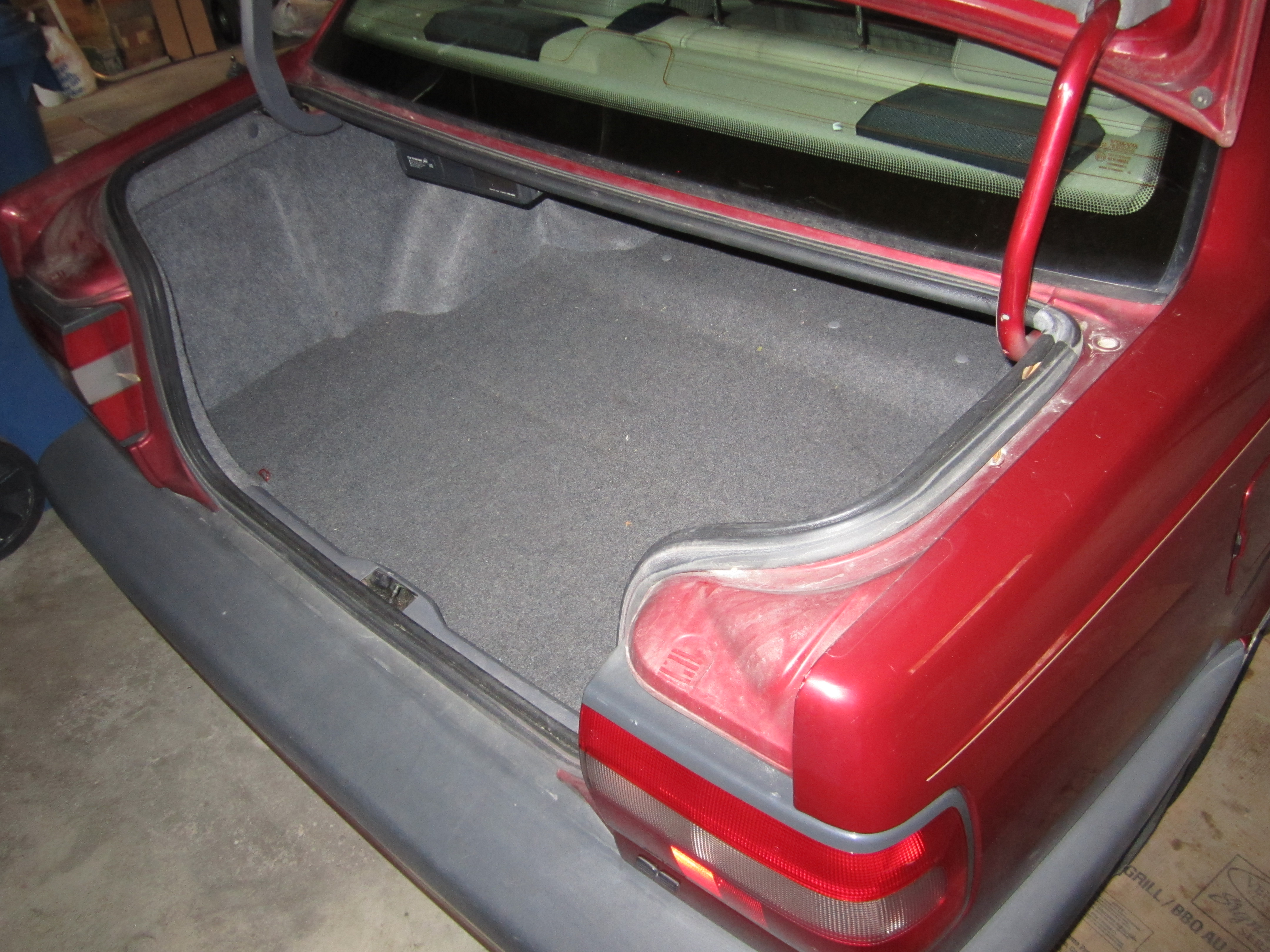

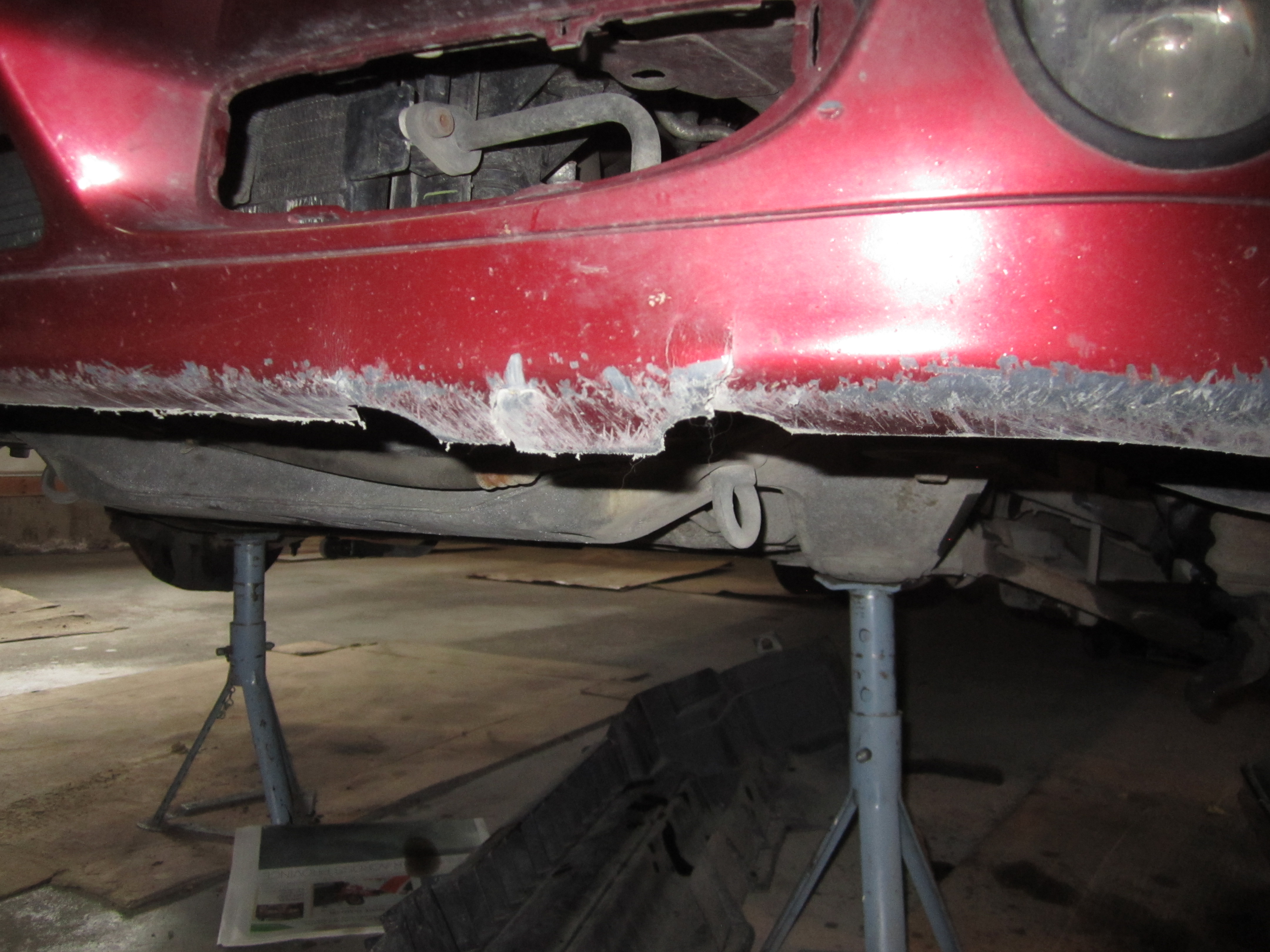

And a few more pictures:
Looks like someone drove over a kerb or concrete stop block they use here and then backed off it!
