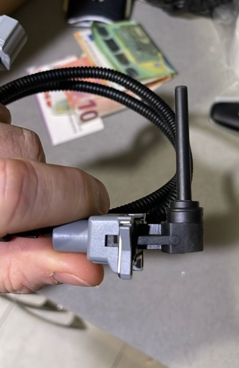

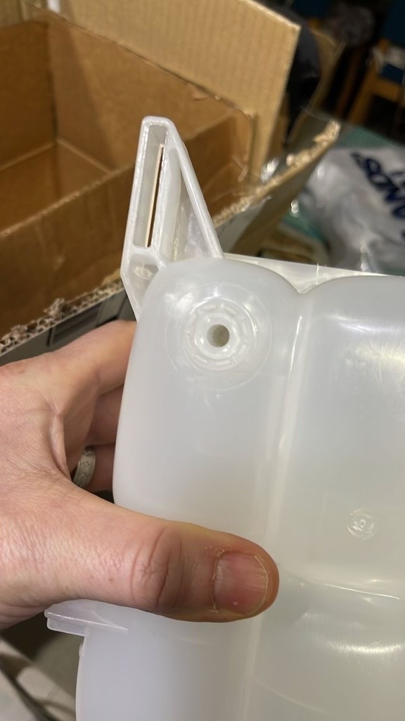

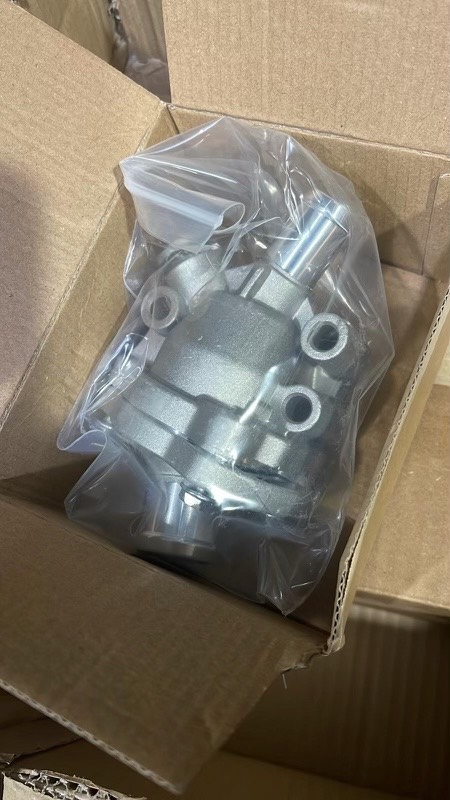

I know this is an old thread, but, there is a fix for this issue. Swedish car parts offers a really nice expansion tank with molded in place low level sensor that plugs in in line with the thermostat wiring and triggers the temp light on the dash for low coolant. I've installed this unit on my c30 with their aluminum thermostat housing.
The new unit does not use the cap sensor.
Swedish Car Parts New Expansion Tank
Non-contact sensor location
Low level Sensor
Low level Sensor

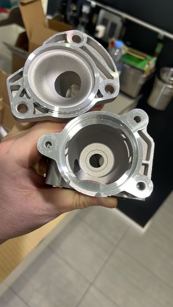

Aluminum T-Stat Housing
Aluminum T-Stat Housing Inside

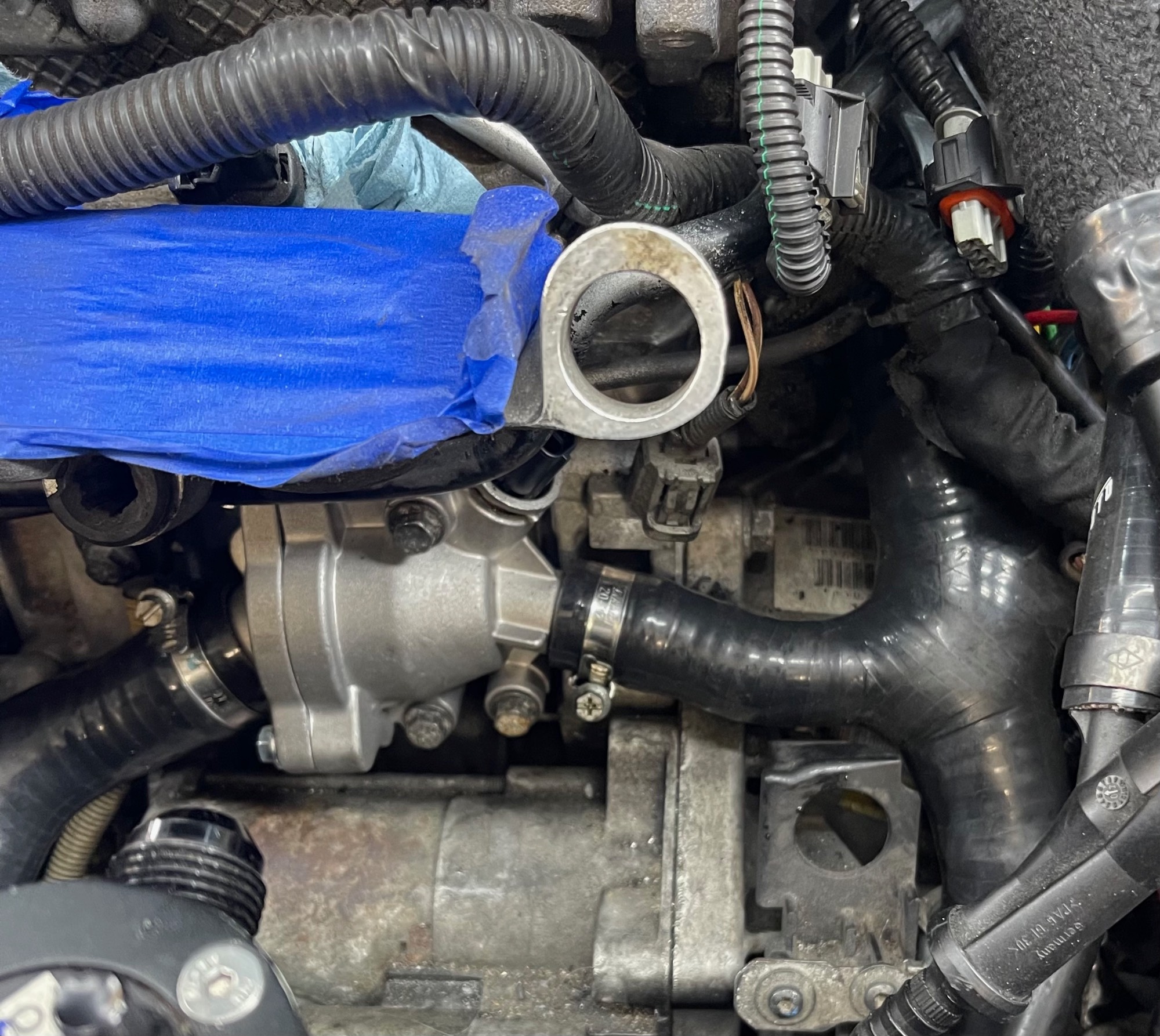

Aluminum T-Stat Housing w/ do88 Silicone Coolant Hose Upgrade
All parts are of high quality manufacture. Tank assembled and welded in Italy and tank is
not made in China. Nor is the T-stat housing. The casting is quality as well as the machining on the T-Stat housing.
The sensor snaps into the molding in the bottom of the tank. Very easy install.
